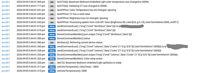

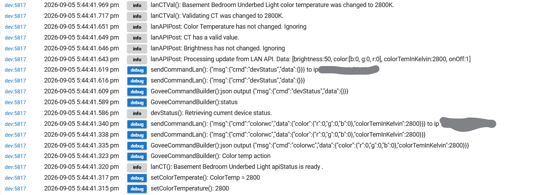

With LAN control disabled and debug logging--it was at 50%, I did the "setColorTemperature" with a color=2800 and level=0. The level didn't change and the light state was still "on":

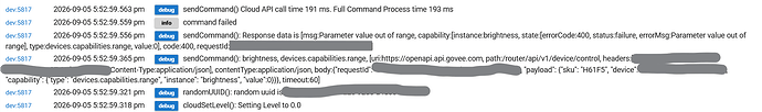

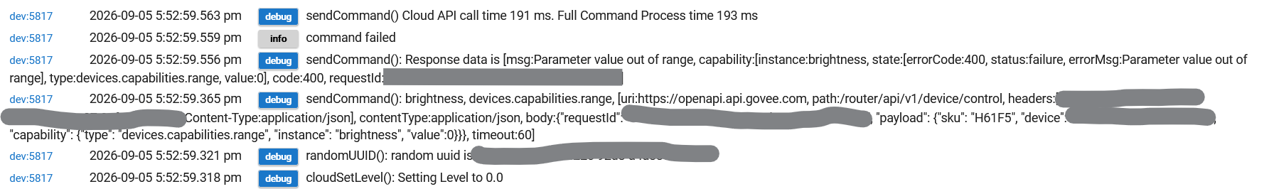

A "Set Level" command resulted in the following (command failed error):

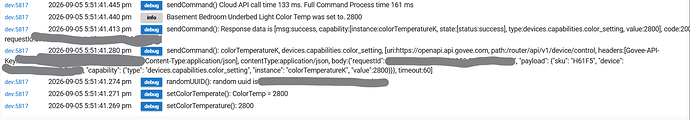

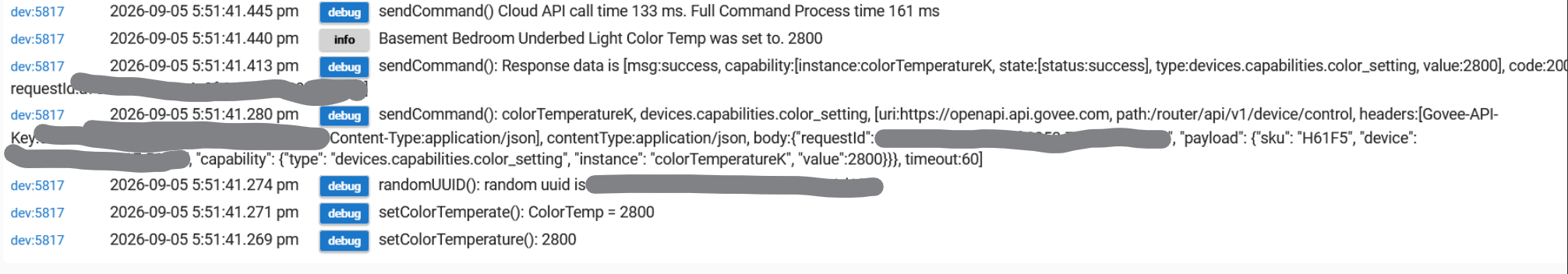

With LAN control enabled and debug logging--it was at 50%, I did the "setColorTemperature" with a color=2800 and level=0. The level didn't change and the light state was still "on":
So i think the first thing to understand is that the Govee API's (Cloud or LAN) and the Hubitat commands don't align exactly. Weather the level is being set with setLevel, or setColorTemperature, or any any other command it always calls setLevel.
When using the Cloud API I was able to replicate the failed command error message when the API tries to change to level to 0. The error message seems to point to that be a issue with a invalid value being passed with the brighness command to the Cloud API. I just reviewed my own API Data and it does appear that the allowed range is 1-100.
When using the Lan API it is a little different process but the command requirements are similar. Simply put the LAN API spec for the brightness command setting also requires a value range 1-100. The difference for the LAN API is i have code that simply ignores the value passed if it is below 1
