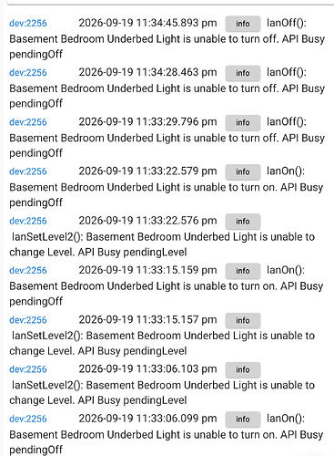

Suddenly tonight, I can't control my Govee lights through this app.
Any ideas?
Debug logging didn't seem to show much more.
Things worked better when I switched the LAN API preferences off.
What that means is the device got into a pending change state and didn't come out of it for some reason. Specifically it tried to turn off and didn't get the update that it completed.
After a set number of retries it is suppose to clear the pending state. Clicking on initialize should force a reset of that value, but shouldn't be needed. Can you go back further in the logs for the device to perhaps show when it failed. It may also help to extend your retry interval and increase the number of retries.

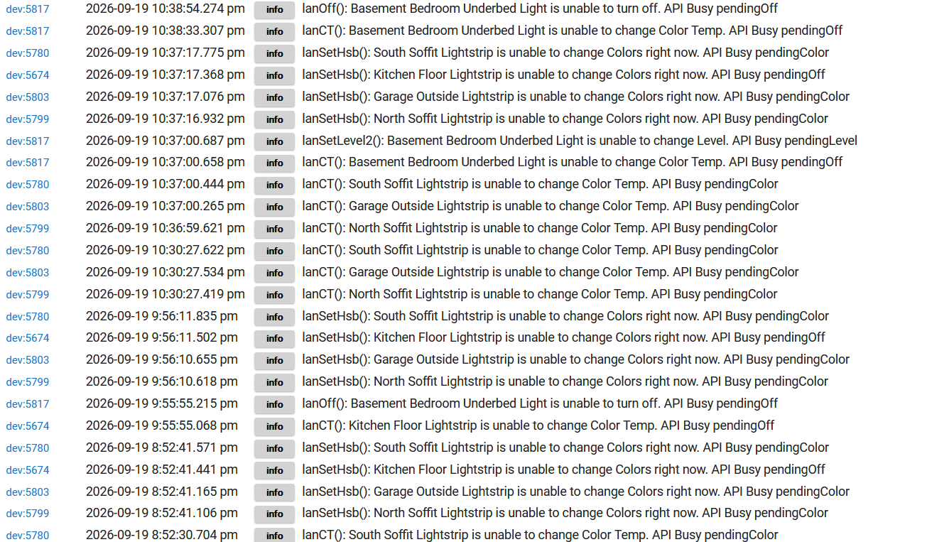

Pretty much ALL of my Govee lightstrips (which is all the Govee things I have) were messed up.
It went back to at least 8:46 pm (I run out of logs somewhere about then).
I did some initializes--and that only worked briefly (if at all) and it went back to being broken.
It's a bit frustrating--when I set "LAN Control" off then, later, turn it back on--it loses ALL the LAN control settings (retry time, retry count, %fade, etc.).
I believe I was using 7000ms interval, 10 retries, and 10-20% fade amount.

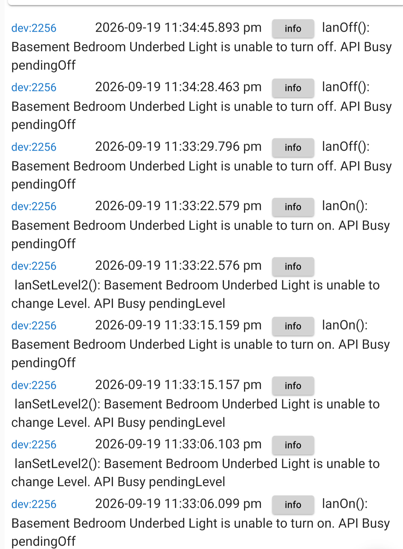

I tried using LAN Control again--and it still isn't acting right:
That almost looks like Govee Device manager stopped listening on the Multicast socket. Can you check your logs for the Govee Device manager and see if it had any errors in the logs at some point? Looking at the code now for clues. It is very odd that all of those device are generating those errors. You are running the beta code as well, right?

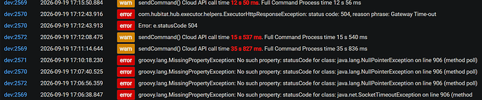

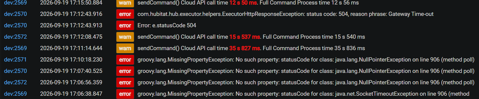

That is the cloud API so not exactly the same. I am glad it already stopped though.
I see we're getting lots of unhappiness in the logs yesterday.
Seems to have stopped today. :crossed_fingers:
Is there any possibility that the Device Manager could somehow have gotten locked up because there were issues with the cloud? Some weird, "shouldn't ever happen but it did" kinda thing?
Even with LAN Control to/from the Hubitat, the Govee devices are going to try to sync with the Govee cloud to keep it updated also. Could something there cause the devices to lock up internally??

I just turned on my stats collection for the Govee Cloud API so i will have relevant dashboards soon. I saw some long transactions not long ago. So i don't know if what caused those long transactions has cleared yet. I will keep an eye on it.

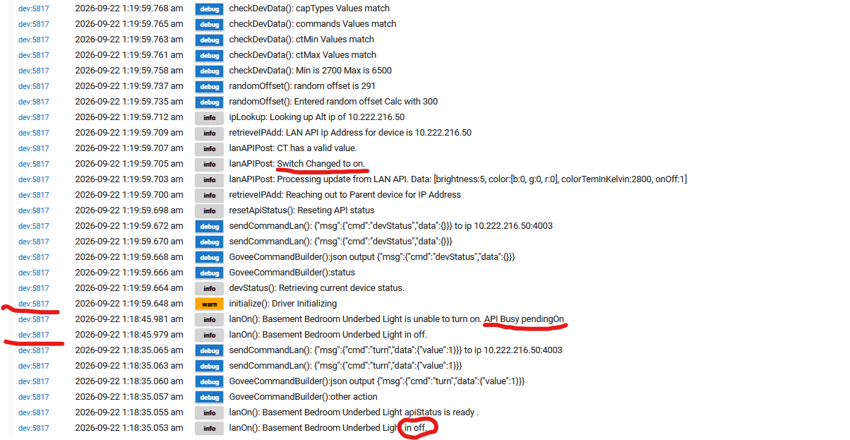

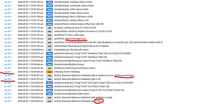

OK, so I did some more testing.
I set the LAN API stuff back on for one of my lightstrips. I also set it to 7,000ms and 2 retries for testing.
It was getting stuck in the "pending" state just like before. Waiting a bit didn't seem to do much either.
The Govee v2 Device Manager device didn't seem to be doing much (even with Debug Logging enabled, nothing showed in the logs for it at all). Clicking initialize on it did nothing. Ah-something seems messed up with it. When I save the preferences (even just changing Debug Logging), it never returns from the save (the save button stays grayed out and spinning). When I refresh the screen, a number of errors pop up (in pink highlighted messages) and then disappear before I can read them. When I then click "Initialize", it doesn't seem to do anything (or log anything)--when I next refresh the web page (browser page refresh, not the refresh button), I get another pink error message that vanishes to fast to read.
HOWEVER, when I clicked "Initialize" on my lightstrip device, it then processed/recognized the command and updated the state.
I clicked "on" then waited a bit. The state didn't change.
I clicked "on" again then waited a while. The state didn't change.
I clicked "initialize" and it then recognized the state change.
Note it appears there is a minor typo that I circled "in" instead of "is".
Thanks!
...Rob

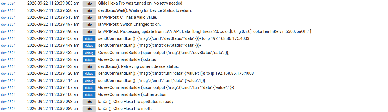

Ok so lets break down the log
The first two lines in your log are these
This is what is triggered by you pushing the On command button in the UI or other app. It validates the current state is off and then checks the current apiStatus Value. So it is good and ready to submit
This next set of lines below is the send command processing. This indicates the command was sent.
10 seconds later you submitted the command to turn the device on again. It failed because when the validation of the apiStatus was checked it was in "pendingOn" state.
Then you triggered a Initialize which was the remaining entries in the logs.

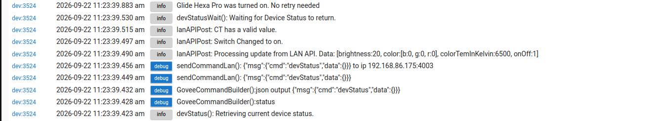

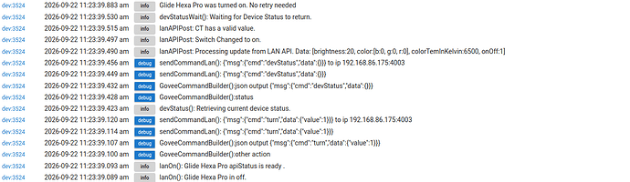

Clearly something got missed. When I try this same command on my dev hub, my logs look like what is below for a complete "on" command.

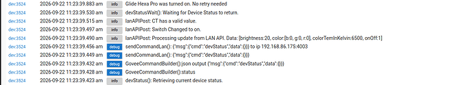

What is missing from your logs is this
The devStatus call is very important so the question is why did that not get scheduled properly. It works fine for me and if there was a fundamental problem with that routine this thread wouldn't be just a conversation between the two of us right now.
This does explain the problem though. If for some reason your hub is never scheduling the device status routine then everything that depends on that fails to move forward.
