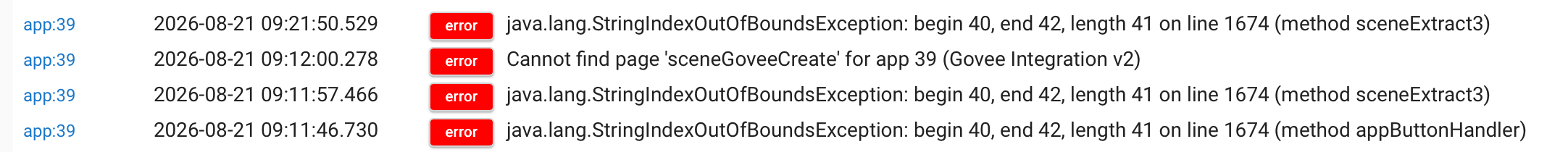

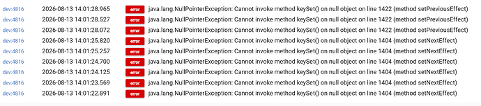

Well, I was finally able to uninstall (I saw the "remove" button in the app--duh). I reinstalled and the integration found the devices and installed them. However, still no scenes. From the log:
Is it set to use LAn API or Cloud API
What is this value set to. If it is true/on. it means your are using LAN API

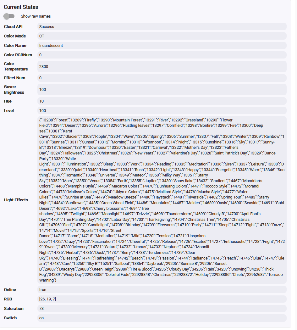

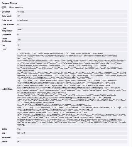

The installed Table Lamp 2 device is using driver Govee v2 Color Lights 4.
I saw that the uninstall/reinstall had logged me out of the Govee account in the app, so I logged in and clicked on "retrieve all default Govee scenes for all installed devices to local files," but still nothing in the device page.

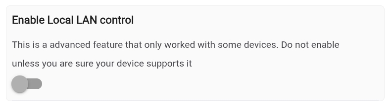

LAN API was the key. It was set to "on" in the Govee app, but not in the device page. Once I turned it on there, the next effect/previous effect commands work, and after hitting "scene load," the scene names showed up.
Thanks so much for your help!!

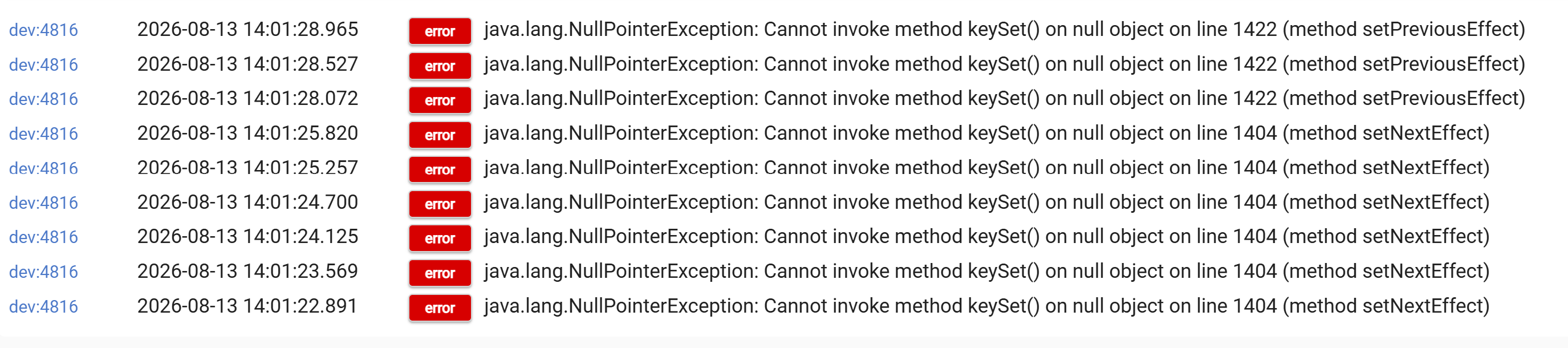

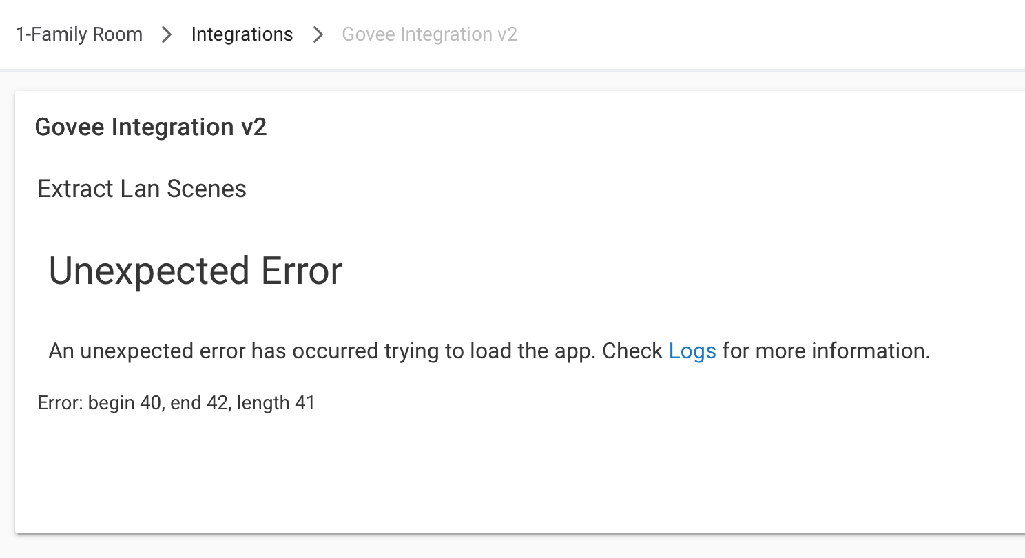

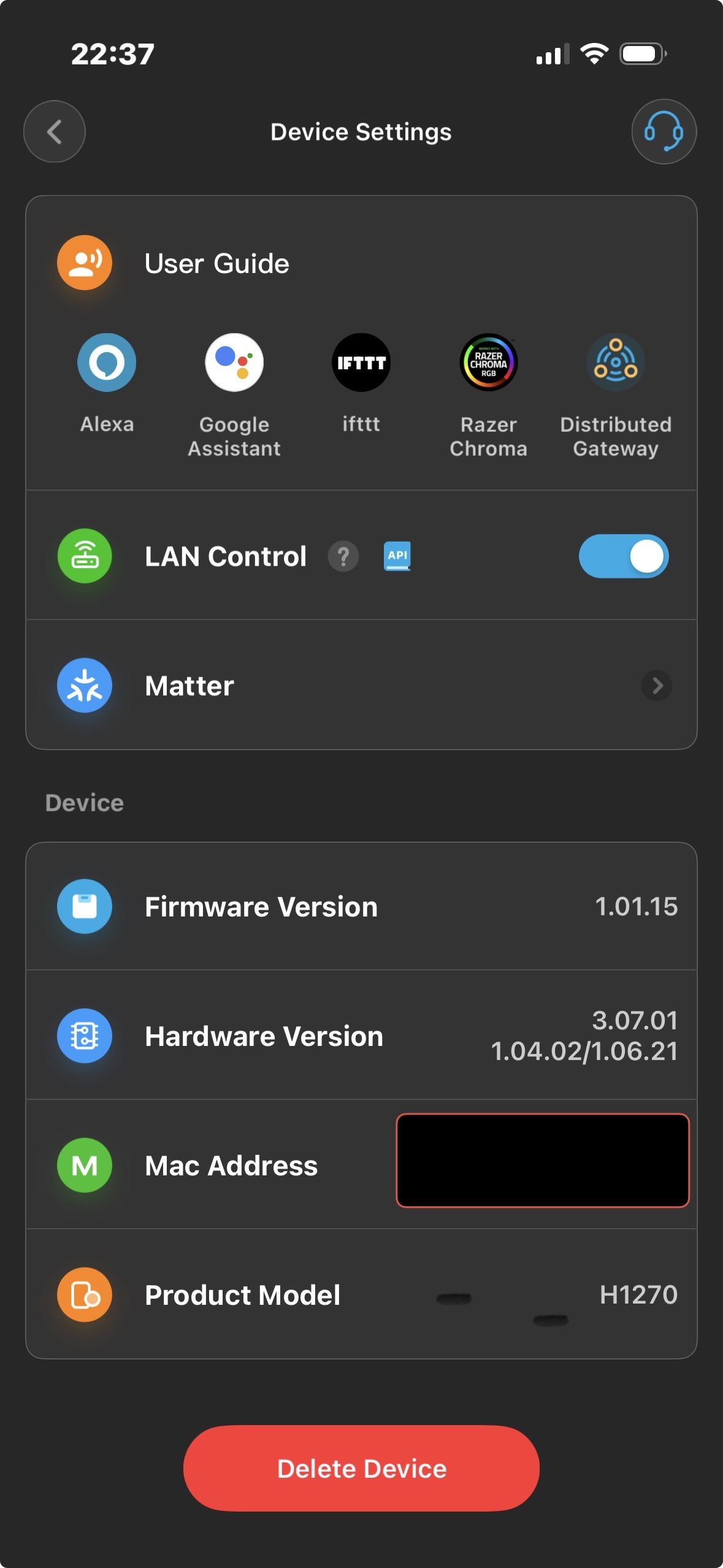

Any chance of adding the new H1270 ceiling light to this integration? I can add it using the Govee integration, but it will not pull down the scenes. I get the following error:
With this log entry:

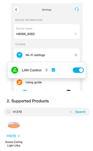

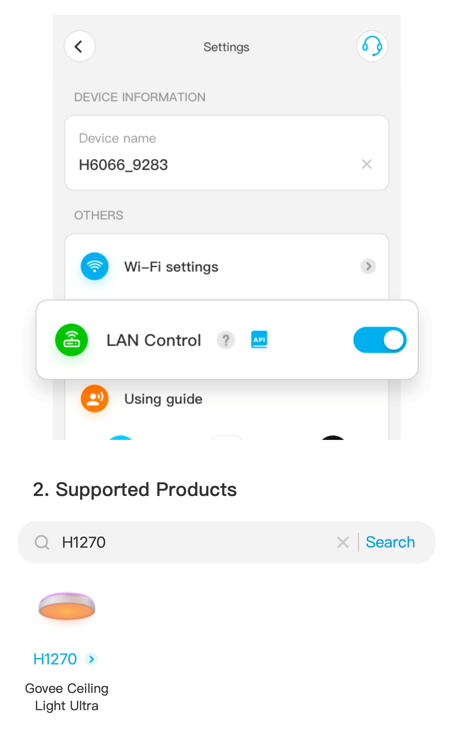

Looking at the Govee LAN integration page, it appears to be a supported device:
I've successfully added other Govee lights, but this one doesn't seem to load the scenes. It's possible I'm doing something wrong though...
LAN Control is on in the Govee app. Successfully added in Hubitat, with the Type listed as "Govee v2 Color Lights 3 Driver". Light is controllable, but no scenes are available.
Any help would be appreciated.

I have the LAN control on for this device, but that makes no difference for scene extraction.

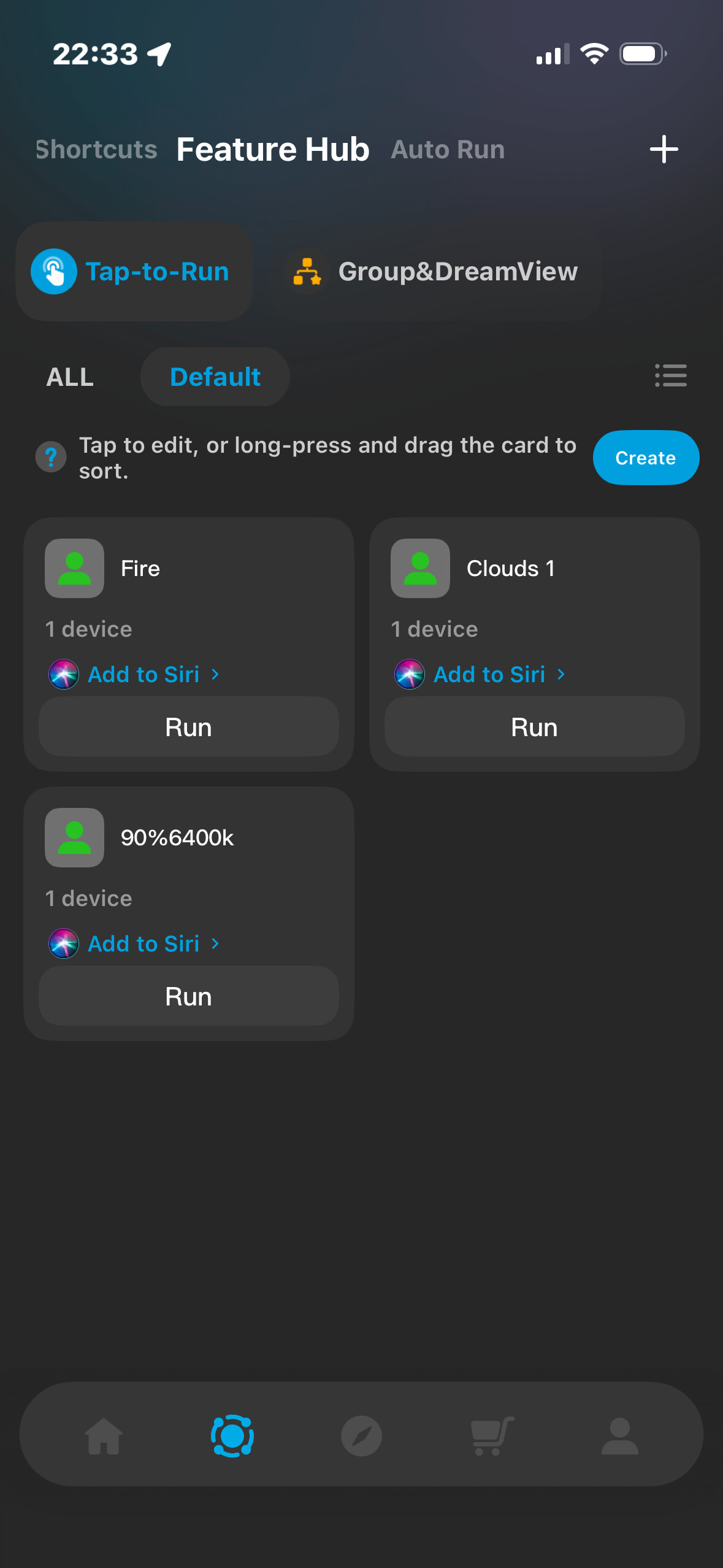

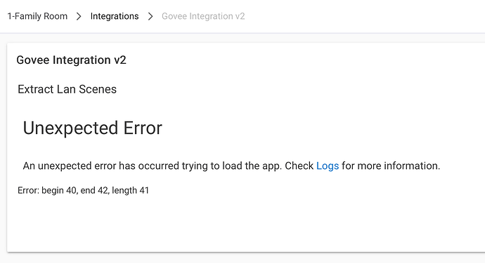

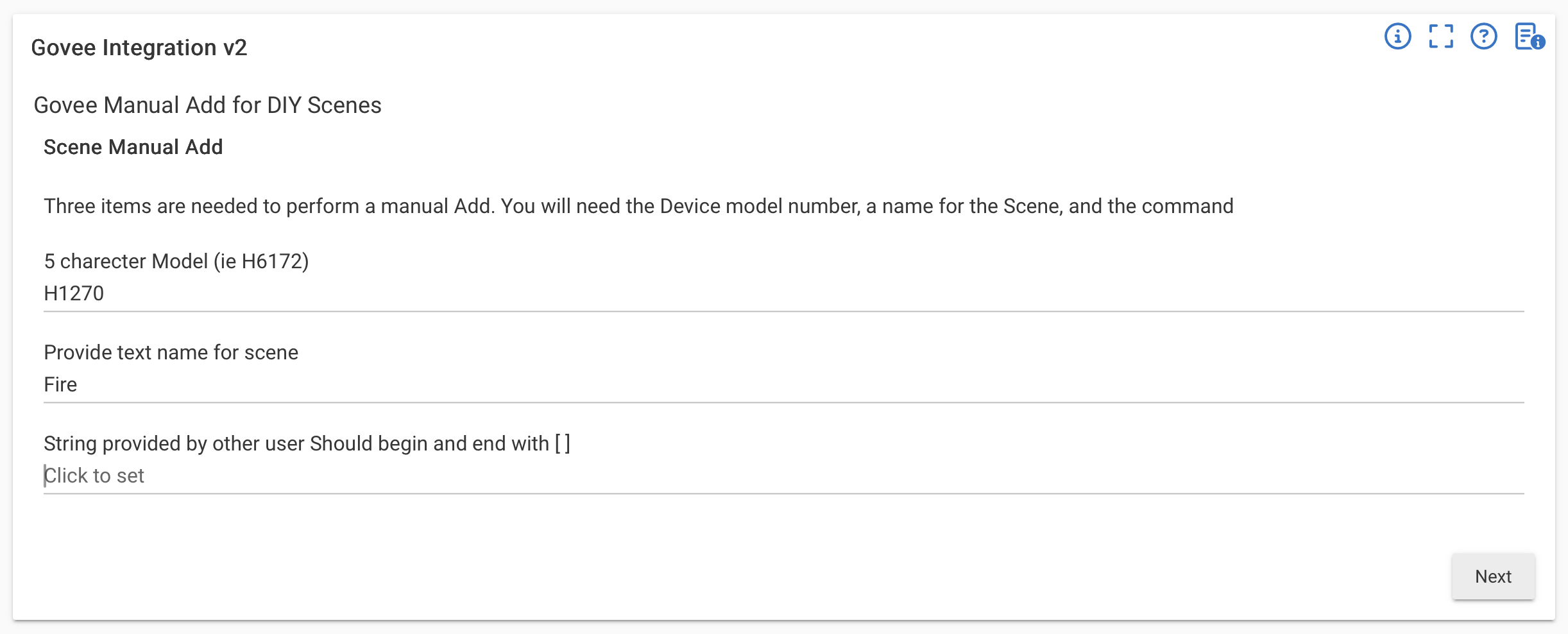

I've been unable to get the tap-to-run scenes to download either. The "Extract Scene from Tap to Run" shows nothing. When I try to do it manually, I have issues as well. I suspect I may be doing it wrong, but I'm unsure of the data needed for the extract.
I'm not sure what information is required for the last entry. Obviously, my tap-to-run scene is called "Fire", but I don't know what "String provided by other user" is that you're looking for...
I have no problem providing you with access to my API key if it will make it easier for you. Especially if it helps other people in the long run. I realize you can't test every new device. Since I have it and can provide the access for you, it would probably be the easiest way.
Let me know if you have any other ideas...

Try going into the device, open up the preference tab, leave the option for "Enable Local Lan Contrl" turned on and turn off "Enable Local Lan Scene Control" and click save and close. This should get you working with scenes. Until I get the process figured out for the extraction.

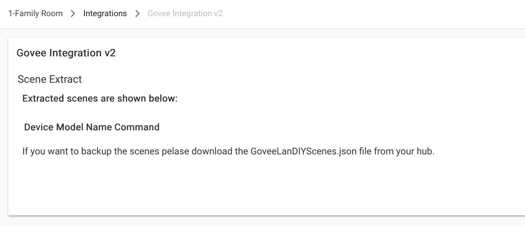

The screen shot is from the option to add manual scenes. That isn't the option to extract the tap-to-run. Try reading the documentation for the steps to perform the extract using the tap to run. The link is in app.
If you are cool with me having the API key just send it to me in a DM and I will start to work on it. I will only configure it while I am testing.

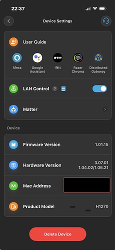

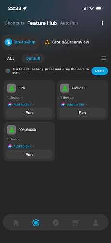

Yes. The problem is, my Govee app doesn't look at all like the screenshots on the instruction page. Nor can I find the preference for local LAN scene control. I've made the requisite Tap-to-run scenes, but I get nothing when using the extract command on Hubitat.
The only LAN Control setting I can find
The Tap-to-Run scenes

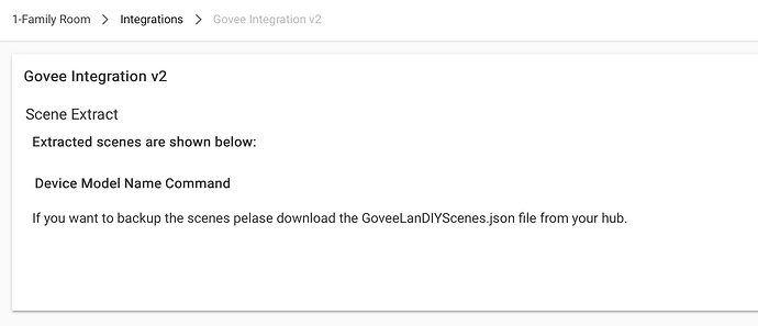

Hubitat return after selecting "Extract scene from tap to run"
