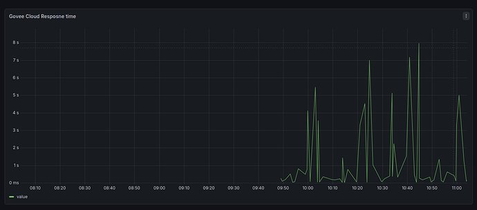

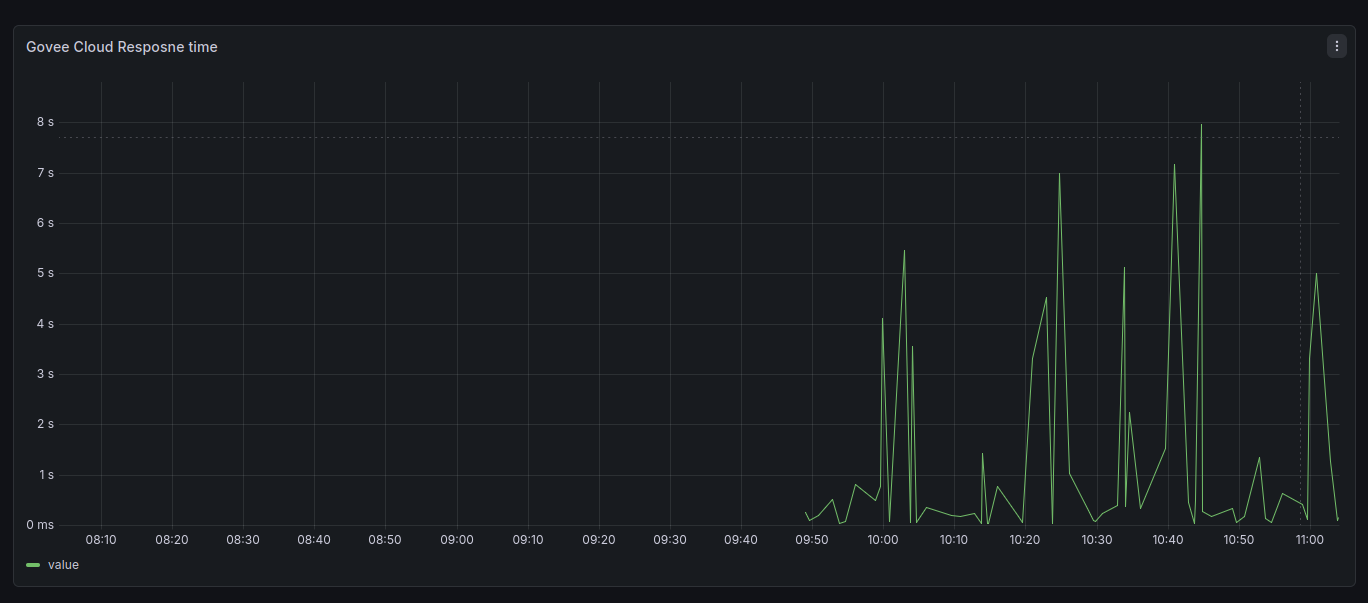

I have adjusted some code to take the information used to generate the log entries and post cloud response times to the "Govee Device Manager" device. I have been collecting that info for the last few hours. Here is the graph so far this morning since i have started to collect it. All are below 10 seconds which explains the lack of log entries.
So it looks pretty good for now.

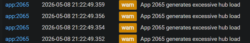

Last night I had a thousand of these bt it seems to have died off at 22:22.
What is app 2065

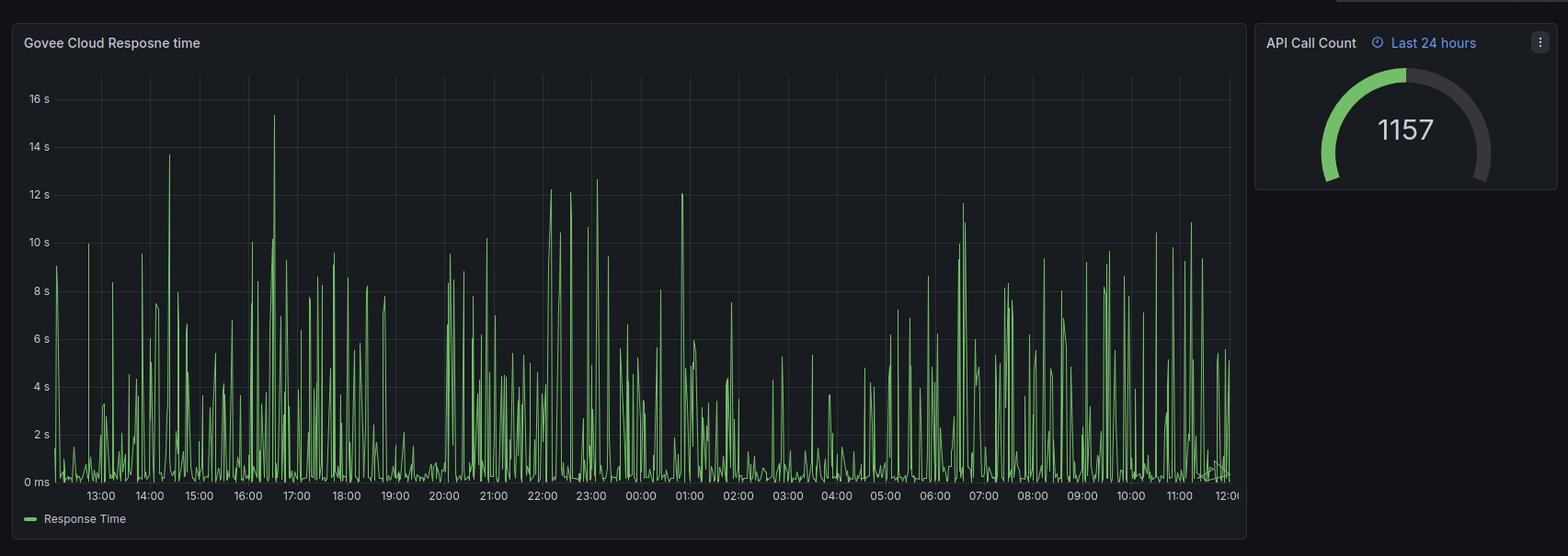

I have updated the beta code again to include the stats enhancements mentioned above.
A usage of these stats are as show below. You can see the Cloud API Response times and a count of the Cloud API Calls. This isn't anything fancy just some basic data, but it could be useful under certain circumstances.

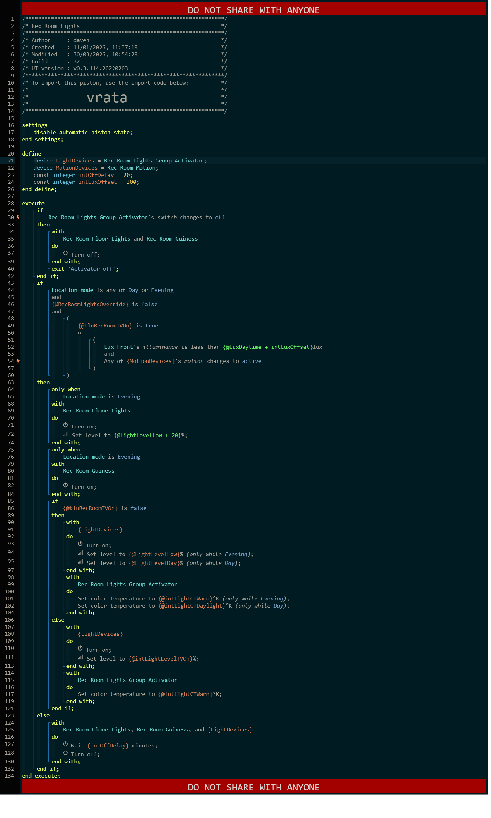

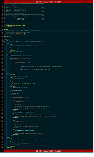

That's my WebCore Rec Room lights piston.
It's the only place I use Govee ATM.
Ok. So what does the piston do?

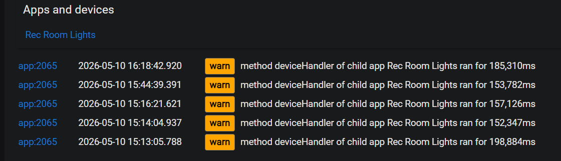

Depending how how the load is being calculated, and how many devices are involved it is possible the recent issues could cause load to be elevated based on wait states. That doesn't inherently mean there is a problem though.
Some of the logging provided a few posts up by @kauf1326 even point to errors with connection pool which is at a level lower then my drivers.
I am not sure why your piston would be having a problem, but if you can provide live logging from the Govee studd during that same time i can possibly make some theories about why it may have happened if the Govee devices so any issues.
It's a simple piston. :wink: I bought 4 Wifi bulbs for testing at X-mas; they are Cloud only.
They are controlled by a Room Lighting actuator for on/off and colour.
No real load as there are only 4 bulbs. I did note that I could control the bulbs with their app so it was their api/network at fault.
There are other ZW lights and Mode dependencies so it looks messy.
The piston really didn't have any problems, it issues the commands properly they just kept failing or timing out. The logs, I think, just use the last app number as a generalised reference for reporting.
WebCore checks the state of each device when it optimises the commands so it would have received nonsense every time it ran; hanging on timeouts etc.

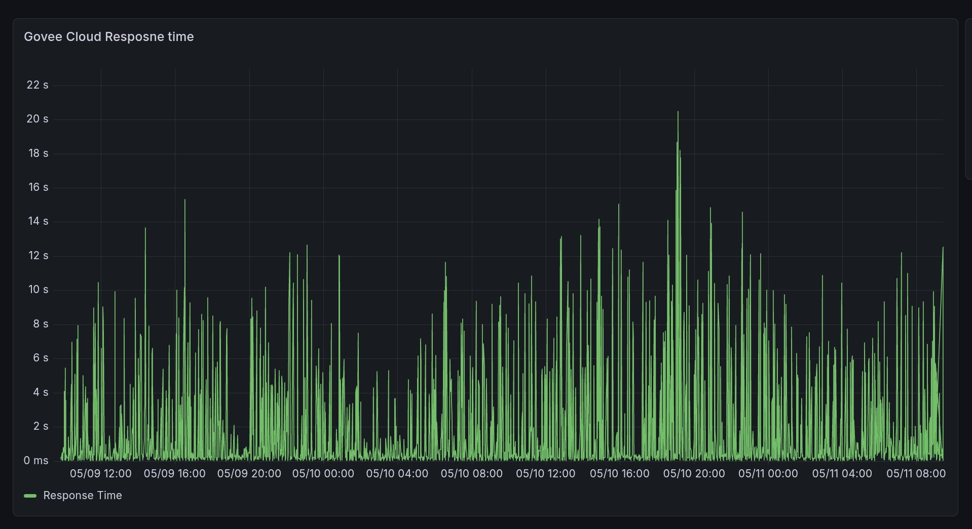

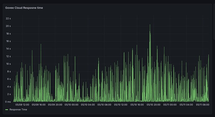

On top of that i am still talking with Govee about their API Performance issues. It is still occuring just not as bad as it was a few days ago. Hopefully their engineering team will get on it now that the weekend is over. This is my graph of the API Response times over the last 48 hours. I only use about 1.1k of my 10k ratelimit so other folks may have busier graph if they have more devices that are on the cloud API.

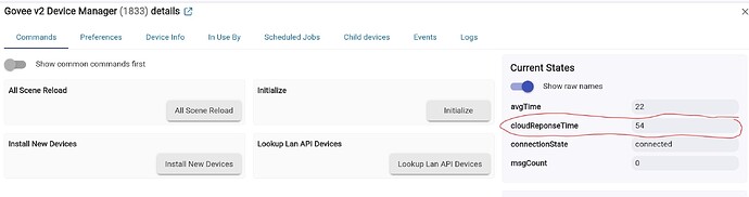

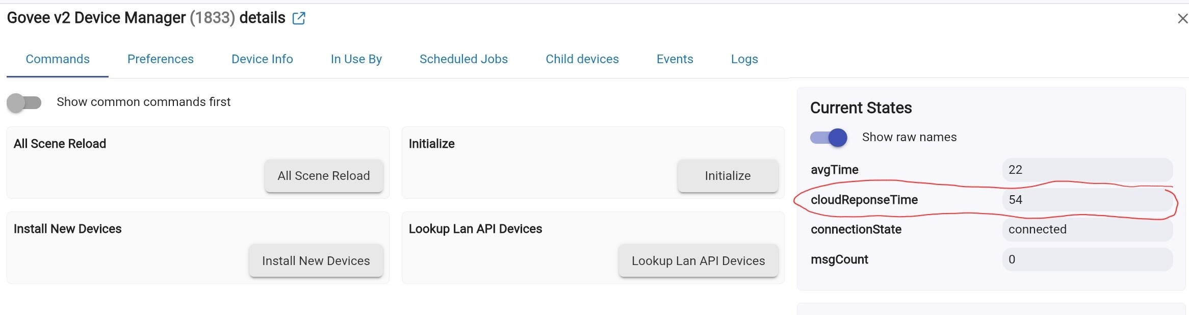

First the information is in the Govee Device Manager if you are using the latest beta code posted yesterday. The current Sate is cloudResponseTime as shown in the below screenshot
