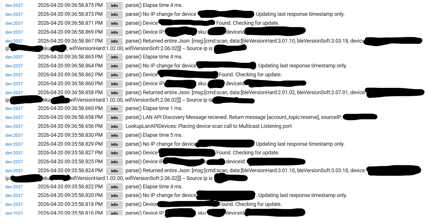

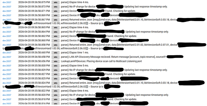

So, I tried to turn logging on the Govee v2 Device Manager off to remove the clutter.
However, I still get a bunch of parse messages every minute--and I guessing they are due to the "scan rate" setting.
I wish those messages would go away when logging is off.
But, I'm also trying to figure out what it's doing that requires scanning the LAN every minute.
I give my devices a fixed IP address when they relate to home automation, etc. So, it should be a very rare case (months to years rare) when I add a new device--and I'll be opening the device manager so it should force whatever scanning needs to happen at that time.
What am I missing? What is the downside of maxing that scan rate out?

The device scan is simply for device discovery. If you wanted to max it out, the only impact would be if you added new devices they wouldn't show up to enable local lan control for a while until thd next scan. You could always manually trigger the scan from the device manager.
This process also controlls updating the IP associated with the device. So it is possible if you don't have a iip assigned you could loose access for a bit until the new ip is discovered.
You may have other stuff talking to the multicast socket. I know i get a bunch of scan messages from Home Assistant.
If debug log is turned off for the Govee Device Manager that should limit the messages i think. If you post what you are seeing i will check to see why they are ahowing up.
Yea. All of thay indicates Debug loging is turned on for the Govee v2 Device Manager. Can you confirm debug logging is turned off.
If it is you may want to update the integration or perform a repair of it in HPM id you dont have the option for a upgrade.

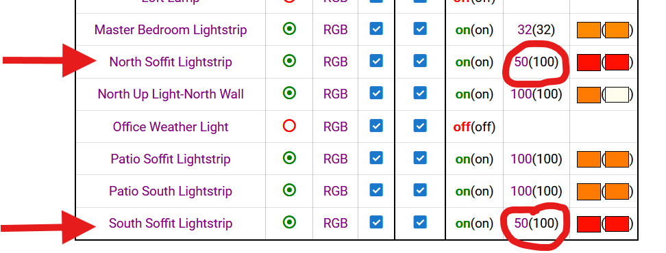

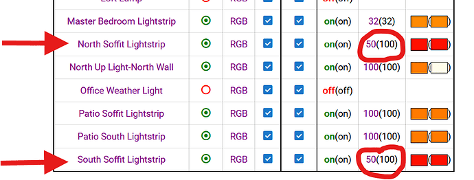

I added a new Govee lightstrip today--and there seems to be a bit of wonkiness
For some reason, when I enter a hex RGB value into a Room Lighting (RL) table that corresponds to what I see being sent to another, identical Govee device that I added long ago (I see the values via debug logging), RL often magically changes the hex value to another one (close, but a few numbers off on the various colors). It's really odd, because the Room Lighting app accepted and saved those Hex values before and now it won't save the exact same values!
Also, I regularly see the Level value NOT being updated on the device. The RGB value has a corresponding "level" number, which shows up in the Room Lighting table--but when the scene is activated, the level doesn't get updated (neither on the device nor in the RL table). Given some of the conversions being done to map Hubitat's colors to what Govee wants, it seems like it's possible that your driver isn't bothering to calculate the proper level, perhaps?

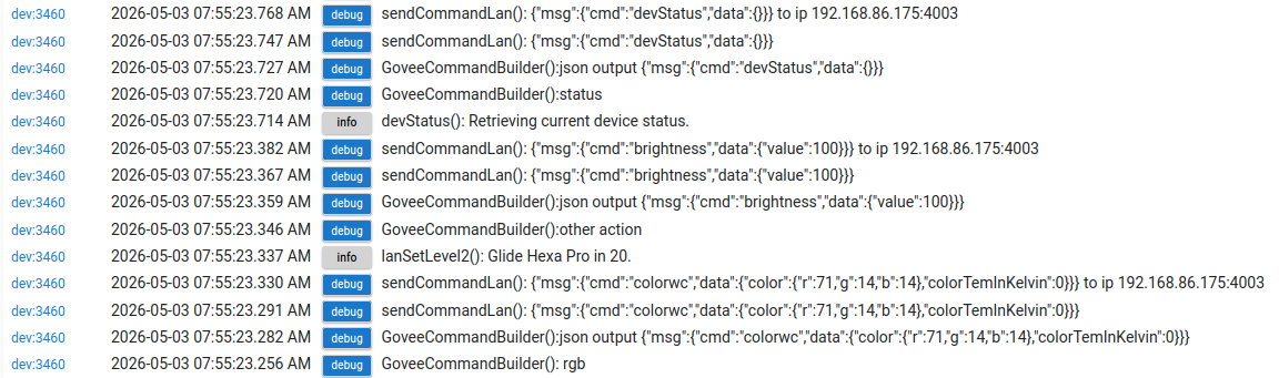

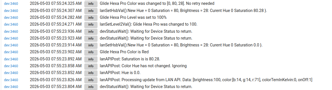

Sorry it is taking so long for this response, i wanted to make sure i had it right. It had been a while since i dug into this.
The problem isn't the calculation actually, but the fact Brightness and RGB are handled separately on the Govee Side. I already have the calculated value if it made sense to use it.

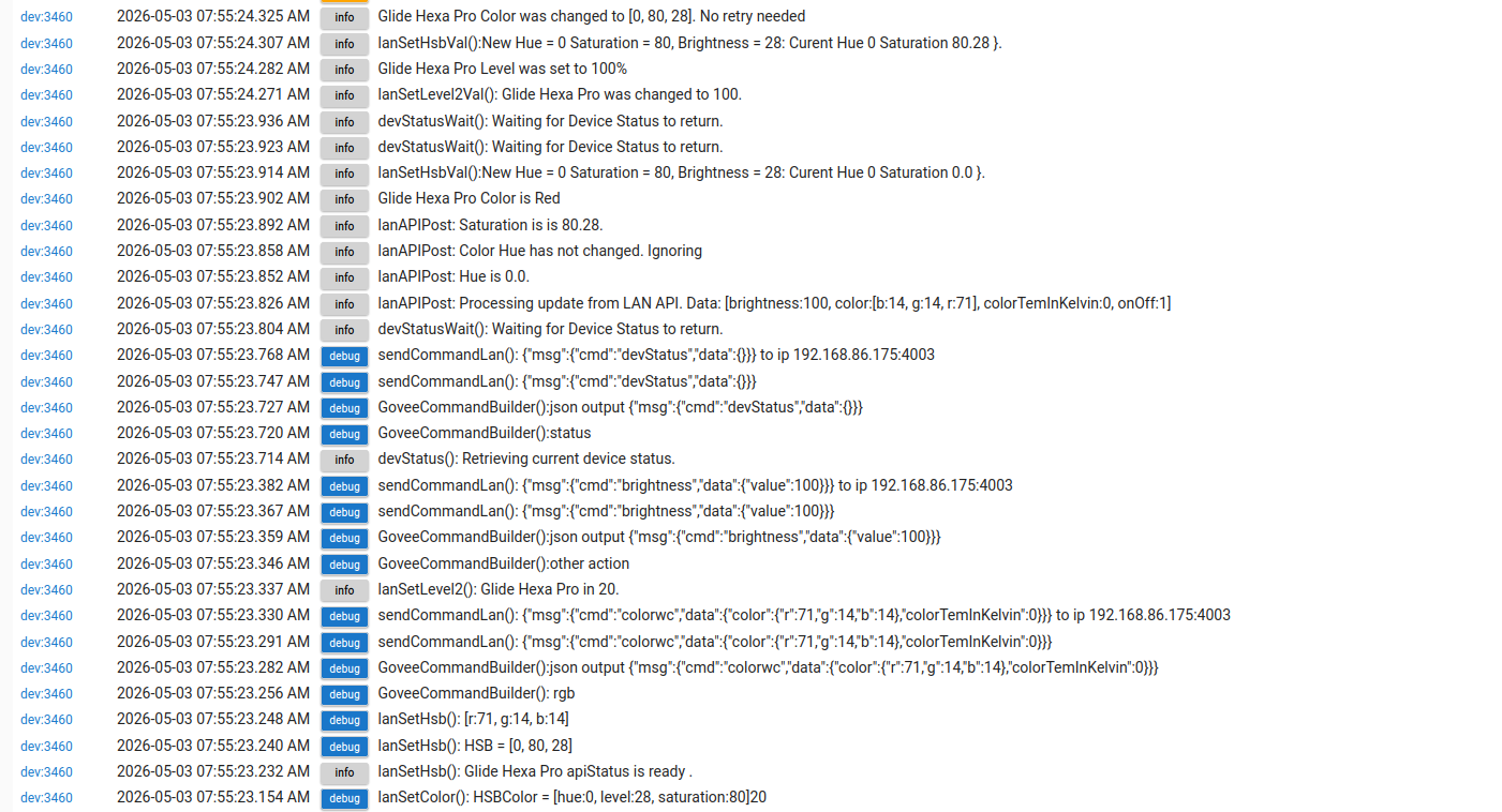

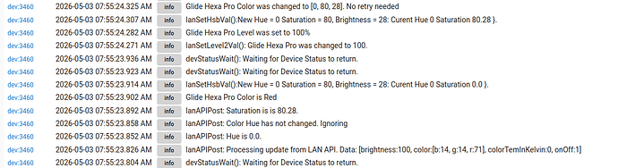

You can kind of see this in the logs if you turn on Debug Logging for the device involved. Here is a test i did a little while ago with a device on the LAN API.
In the log data you can see that i set the light to essentially a dim red color.
This is the point where it is converted from HSB that the hub always uses to the RGB for Govee.
This is when the code is executed to submit the command. You can see three command submitted. It starts with submitting the commands to change the color. As expected no brightness value submitted. The LAN API command actually calls for both the RGB collor and Colortemp to be included with one of them zero'd out. Then a call for the Device status call to validate the change took place.
This logging block is the driver processing the returned data for what changed from the device.
The specific entry i would highlight would be
This entry shows what the device returned from the devstatus call. As you can see Brightness and the RGB array are returned along with onOff values. Color temp is 0 which means color temp is not used.
If you do not set the brightness as part of the color change the value of the brightness wouldn't change on the Govee device from the previous device state value prior to the RGB color being submitted. So in the example provided above Brightness would of stayed at 20%. The resulting brightness of the device would of been 20%(previous brightness) of 28% or 5.6%. If i had sent the brightness value that was selected instead setting it to 100% it would of been only slightly better at 28% of 28% or 7.84.
No matter how you look at it though Govee handles the brightness and RGB color seperately even though the RGB value in a way has a brightness value associated with it.
It is pretty much the same thing with the Cloud API. It calculates the RGB value differently into a single number, but the result is the same. Brightness is handled seperately and you have the ability to compound the reduction in brightness if you don't set it to 100% from Hubitat.
Another way to look at this is to set the color value from Hubitat and then look at it from Govee Home App. You can set the value to a low brightness RGB value in Hubitat and the brightness in Govee does not change. This all makes sense when you look at how the Govee Home app works, but adds confusion for external platforms.
If you want to test this all out yourself without the Integration setting the value to 100% when setting the color make these changes to the library code.
Change line 58 in Govee_Cloud_RGB library file for Cloud API devices.
Change line 213 in Govee_LAN_API library file for the LAN API Devices
Just be aware that changes it for everything and not just one device.

So, my question then is more a matter of what the driver returns to the Hubitat device itself--not what gets sent to the Govee device. Clearly, the device needs the "100% level" to be sent so things render properly.
But, is it possible to then use the calculated brightness (from the RGB values) on the Hubitat Device end (so that shows up as the "level" on the Hubitat)? Or would that break more than it helps?
Maybe it doesn't matter--I was just asking because it's odd when I have a room lighting set to an RGB value that the RL app shows as (say) 50% brightness--when it gets activated, the colors get set properly, but the level shows 100% instead.
This is what I'm wondering about:
It "matches" the color--but the level shows as being off.
Thoughts? Maybe it is irrelevant... It just seemed odd.

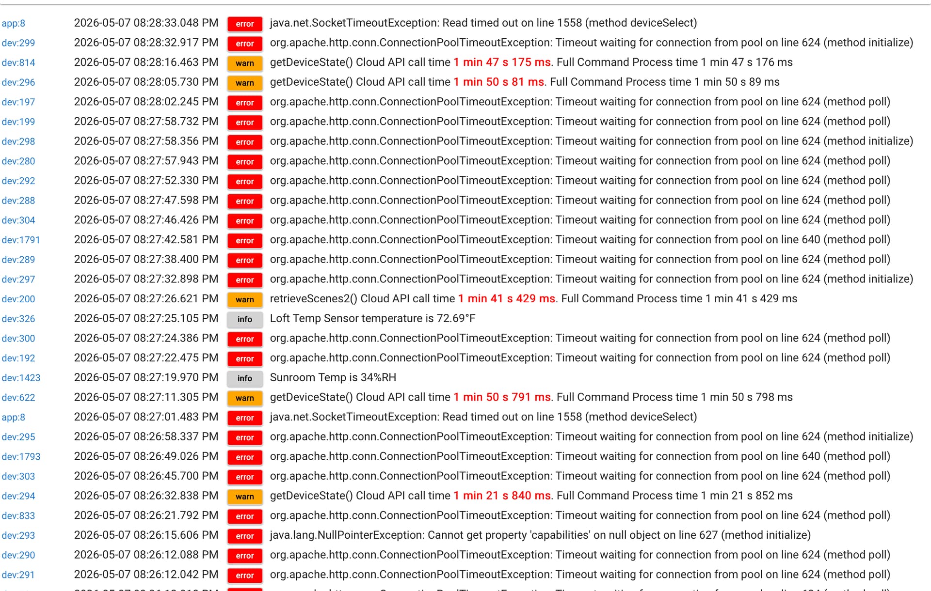

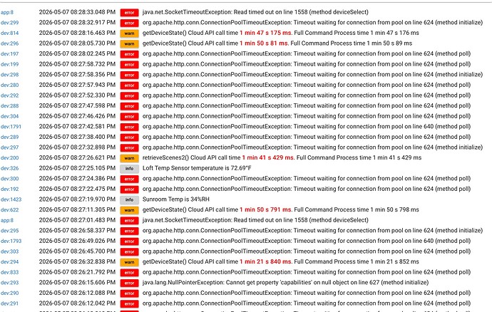

A couple days ago I noticed my Govee Cloud API response time started slowing. As of right now, I cannot control any of my Govee devices (API Cloud or local LAN) that are connected to my Hubitat C-8 Pro controller. When I open the Govee Integration V2 app and push the standard device setup button, I get an "Unexpected Error - read time out" My V2 log page shows "Timeout waiting for connection from pool on line 624 (method poll)." I also get warnings of " getDeviceState() Cloud API call time 1 min 50 s 791 ms . Full Command Process time 1 min 50 s 798 ms."
  • I've rebooted and did a shutdown but neither made a difference.
  • I reloaded to a previously known good backup and no change - same issues.
  • I thought maybe my API Key expired and I updated it and still nothing. Actually, I'm not sure the new Key was accepted because after entering it, I never got an acknowledgment that the key was valid.
  • All device firmware are up to date (per the Govee App).
  • My Hub is running the latest 2.5.0.xxx release.
  • I am up to date on all apps including Gove Integration V2.
  • Govee devices are working fine in the Govee App.
I'm sure it's something simple I'm missing. My system has been very stable using the V2 app for awhile now.
All help appreciated.
This looks like the Govee API juat started having issues. Are you able to switch to the LAN API?
Please ope. A support case with Govee support.
The Govee home app is likely hsing Bluetooth to control the device which explains why it is working.
I opened a support case with Govee.
