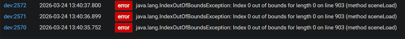

The last call that caused the warning for me was about 7 hours ago. So maybe they took Roy's advice and turned off and on again!
Just an FYI.
I get these on a reboot, assuming it's just an init thing as it seems to go away after the boot.
Looks like they did do something:
