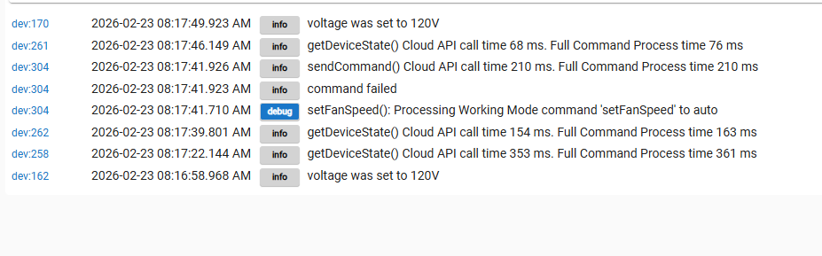

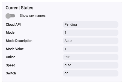

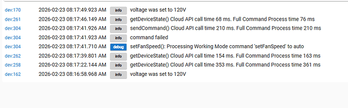

Sorry for the slow reply, I ended up out of town unexpectedly. The only thing that does not work is the Auto setting from the fan speed drop down. It looks like it applies in the UI but fails. All the other settings work fine using the H712C driver. The Auto Mode button does work fine.
The Turbo Button works but it is not an option in the drop down. Perhaps that is by design since that isn't a normal fan speed?
No problem I was in the same boat with a family emergency.
Ok that is all good to hear. Keep using the H712C driver. I will dig into why auto isn't working from the drop down as expected and post a udpate to that driver when i get it fixed.

I just pushed a update to the beta install if you have it enabled. The udpates are as follows
  1. A new Driver for Govee Dehumidifer Max H7151 has been added << First Dehumidifier
  2. Fix to Humidifier driver to allow setting desired Humiditiy
  3. Updated all Air Purifier drivers as they had a bug that prevented Auto from working when being setup from the "SetSpeed" Command. Thank you to @wboweiii for pointing that out

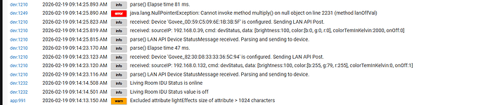

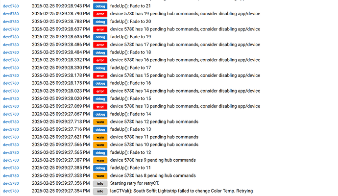

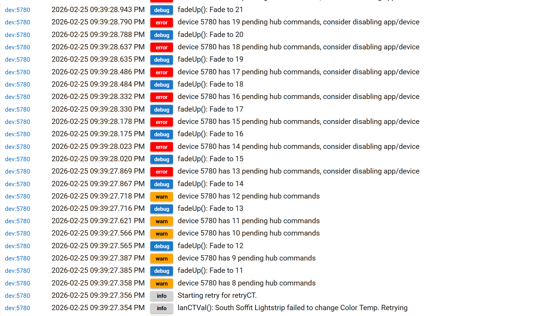

Thoughts on why my new (outdoor neon rope light) is getting these errors?
It seems to be related to LAN API control being on, perhaps. It also isn't properly returning the "current" status (at least not the color) when that's enabled. I guess I need to try it without the LAN API (but, I would like it to function if the internet is down :frowning: ).
Lets start by a clear understanding of what that image shows. It shows that you had many commands being submited to the device back to back with little time in between. There are a few ways this can happen. The fadeUp is certainly one of them. This can also be done just by regular access as well if you try to do someing in fast succession.
Based on the image what catches my atttention is the "fadeUp" routine was being executed. This functions outside of the retry logic and it's guardrails. When you do a fade which is simply changing brightness over time it can be very intensive on the device based on the size of the interval change and the frequency of changes being sent. There is a calculation that takes the amount of time and devides it by the change in brightness, and if that calculation puts a changes more frequent then 2 seconds it will likely cause those pending hub commands. It looks like it was trying to change the fade in single % values and each increment is aprox 140ms. That will deffinately cause a problem. I would suggest practicing alot of caution when performing fades. I don't use it myself unless the transition is over several minutes.
Can you eloborate on this a bit for me. It certainly should if everything is working ok. I do see where your device went into a retry state tough. It may be important to understand what exactly you were tring to do that created this condition.

That reminded me of something from when I did other Govee lightstrip.
The default fade when on LAN control was 1% at a time. I had to change that to 20% to reduce the insanity.
I'd spaced that out but think that will fix that issue.

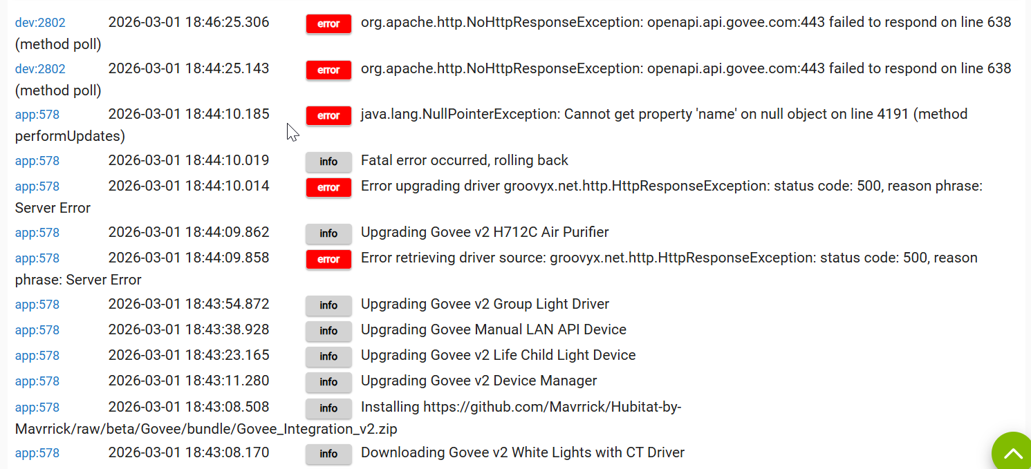

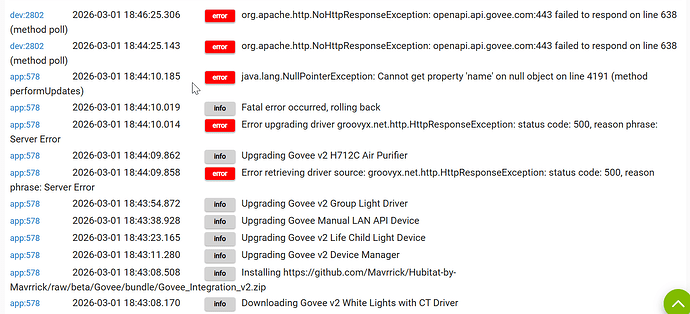

Hello... I can't seem to update Govee V2 from HPM...I keep getting this same error and rollback... I've tried a few things including a repair in HPM and no go... Any Ideas?
Is that still occuring. The last two entries in your logs are interesting. That would indicate a network connectivity issue. Is it working now if you try it?
