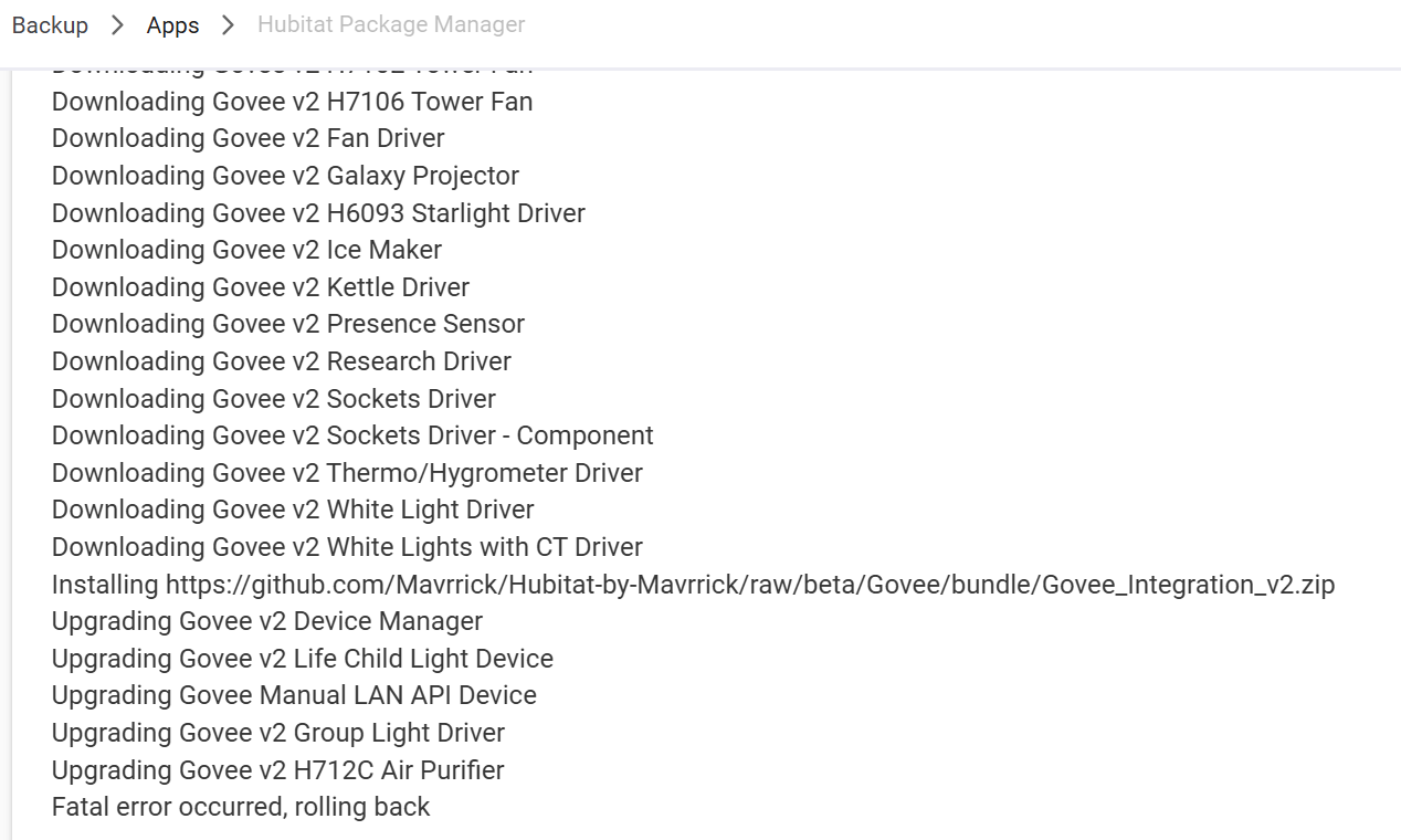

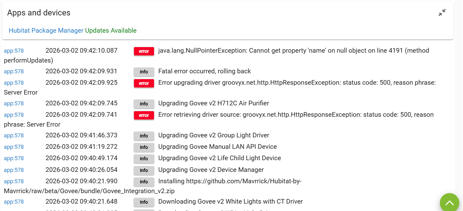

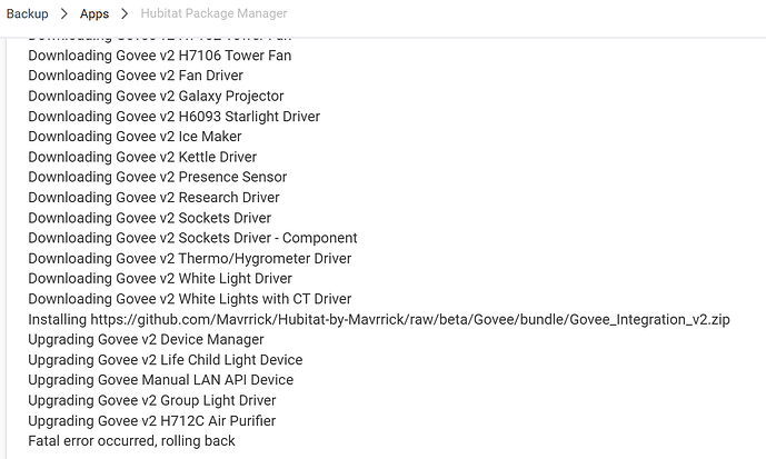

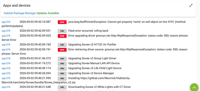

I think I see the problem. There are two things that indicate a user is using beta. The switch to turn beta on/off and then the selection for what app/package you want to obtain beta for. It looks like when you flip the switch to turn off beta the value for the selection of packages stays populated and in some parts of the app is causing it to believe beta is still enabled for package. I will look at adding a change to HPM to perform some cleanup of that value when that switch is turned completely off. It should probably just be cleared in that situation.
Cool... Thank you!
