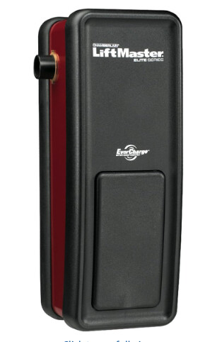

When it got installed, they mounted a smart button on the wall by the door to the house. Like these:
The communications between the motor and the button is "smart" because it needs to tell the button 'stuff'. It's a digital signal sitting on the same two wires between the motor and button.
The GoControl 'listens' on what you'd think are just dumb relay contacts. It's not. If it 'hears' digital signals, it refuses to use the relay. So.. just jettison the smart button and the controller inside the motor will happily dumb itself down to momentary contact. At least that worked for my vintage of Motor

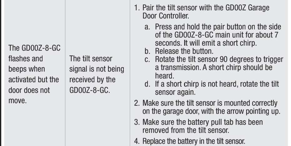

I am so close.
I can jump the contacts and open the door. I put JUST the GDO wires in.
I paired the tilt sensor.
I ran antenna test and see RSSI signal from hub to GDO.
I click the open button on the Device but it WON’T acknowledge or work. It is supposed to beep 5 times and then open.
I thought the instructions were to manually open and then close the door twice so that the GDO can 'interpret' its own tilt signals. While the GDO wires are in, ALSO short the contacts. Let the door fully open, then short the contacts again to close it. I'm going from many years old memory, but I think you have to do that twice.
PLUS, the GDO will not operate quicker than 1 minute intervals. So, wait a full minute between attempts.
It's important to understand that the GDO is meeting all the safety requirements that have been established. The logic is there to prevent a kid from being crushed. The beep and flashing is all for the benefit of the dumb child gawking up at the door as it descends upon them.
Thus, anything that results in the GDO 'doing nothing' is a signal that it's not safe. IT thinks it's not safe... and that includes not knowing if the door is up or down. It would rather do NOTHING than move, if it's unsafe. I have cursed the Engineer that decided NOTHING is the correct way to inform us. It has a beeper, why not 3 LONG beeps if it's in an unsafe mode?
