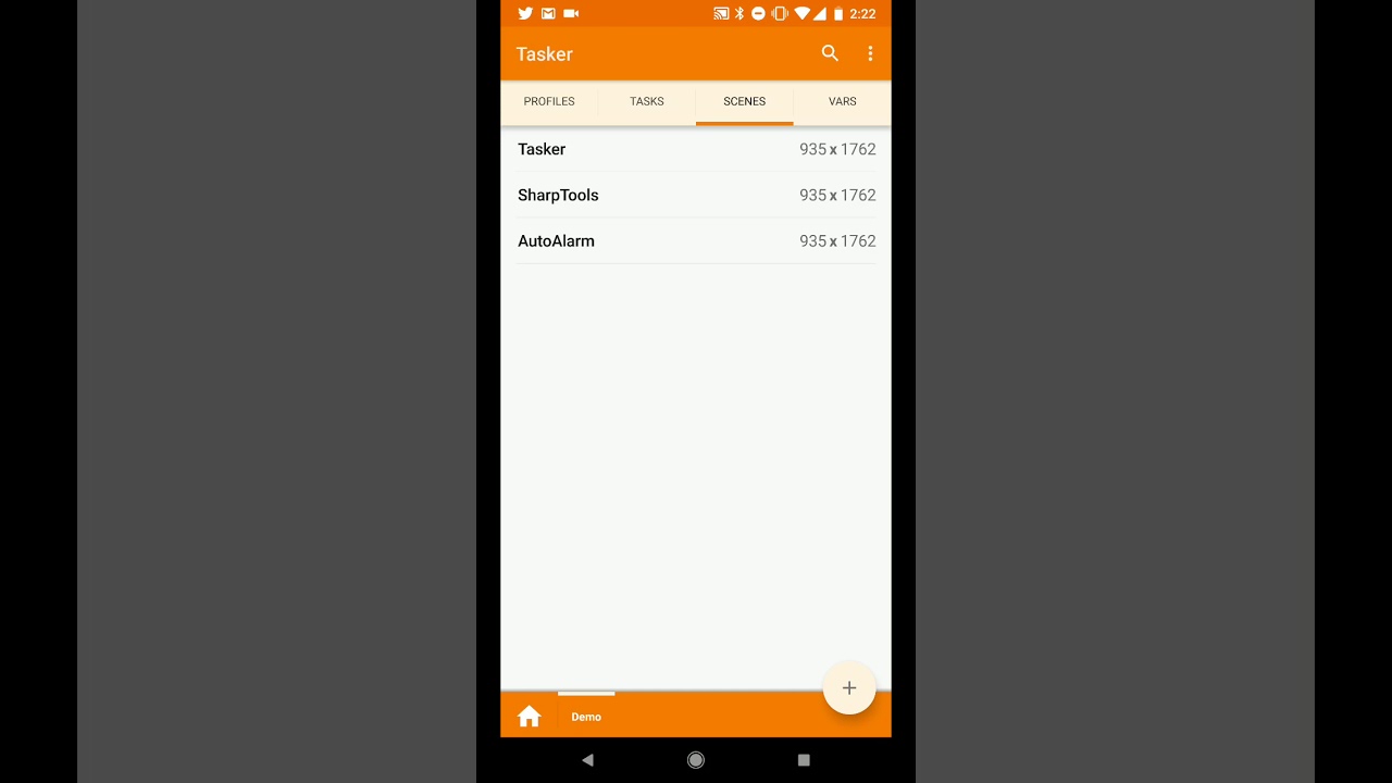

Setup a profile in Tasker triggered by a change to an alarm on the phone / tablet
The actions for this profile are to set the "minutes before" variable and another variable to store the time HE will be triggered in seconds, see the video I linked in my previous post.
Setup a second profile triggered at the time calculated in the first profile, again see the video for setting up this trigger. The action for this profile is a HTTP Request with a URL setting of the command URL copied during the Maker API setup, inserting the Device Id and, if using a switch, entering the text "on" (no capital o) and removing the placeholder for the parameter. As an example, minus some detail:
