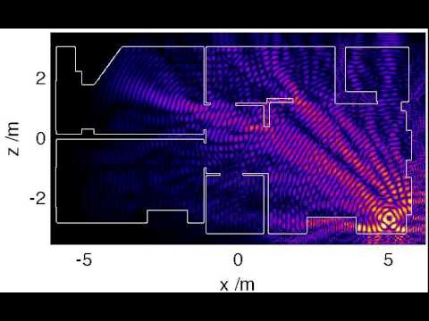

Here's a good quick animation on wireless propagation and reflections in a house.

That's great. My hub would be in the very center of that house and all of the lights and sensors are closer than the outside walls except maybe one motion sensor.
