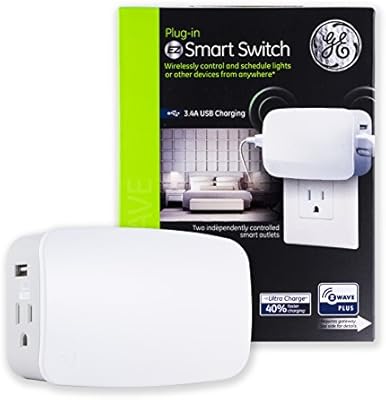

Is the GE dual outlet (link below) fully supported to control the two outlets independently? Thank you.

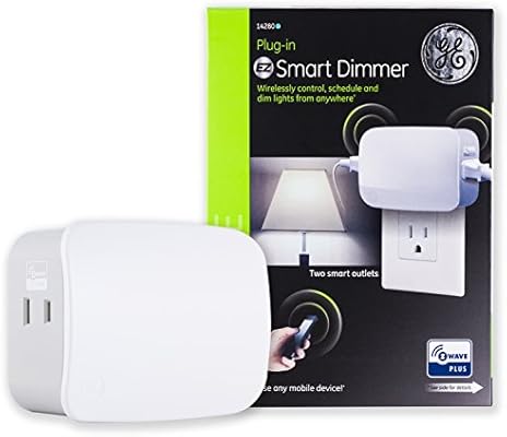

This is a little late in posting but mine shows up as a Z-Wave smart dimmer. It mostly functions however it does not seem to turn completely off for some reason.
Needs a custom driver.
Would be easy to make, as I've remade all of the other GE drivers for devices I own adding in the missing config items/features.
I have a 14280 (non-independent outlet control version), but I don't have one of these devices, though, so someone else would have to tackle the driver creation. Looking at the command class and config parameters supported, though, it is probably a 15 minute job.
Side note, the device supports double tap scenes/commands from the on/off button. That's kind of funny. Not sure what someone would use that for on a device like this that is hard to reach (typically - if in a wall outlet), but that should be added to the custom driver as well for completeness.
Is there a ST driver for this already? Could port that real fast.
I just tried using this driver:
But still getting the same behavior - light does not fully switch off.
Interesting. Wish I had one of these to look at real quick. Probably just need to dump it to OFF at some min level or something - there are other drivers that need that, too.
I assume that this driver doesn't give you independent control of the two outlets though? (I didn't look through the code).
EDIT: Also, are you sure you have the same model? The 28177 shouldn't support dimming at all, based on the manufacturer specs? Do you maybe have the 28175?
Sorry! I have the 14280. Not independently controllable..
Ah! I have a few of those. I'll take a peek at the driver this weekend. I have a custom one for it I haven't published yet.
EDIT: Now that I think about it, though, the GE Z-Wave Plus Dimmer Driver is probably all you need.
- Can you describe in more detail under what circumstances it doesn't seem to turn off?
- Does it fully turn off if you use the physical button on the device?
It never turns off completely tried it with all sorts of different drivers including straight switches. There is a dull flickering in the LED bulb - noticed it this morning when walking down the hall. Have just replaced it with an IRIS plug and all is well. Maybe the unit is defective.
Gotcha. Yeah, that sounds like a defective device - or super sensitive led lights... I would think it is the dimmer though.
I have this dimmer and have one GE LED lamp hooked to it. Never shuts off. Drives the wife mad.. Think all of them are like this. Im wondering if i need to hook more load to it for the off to work.
That's good to know thanks! It may be also be that the led light is too sensitive or something. Did you try a different bulb?
It is weird... I have two 14280, on both I have one led bulb on each outlet - so 2 led bulb per device.
On mine they turn off as expected.
I only had one LED light in an outlet so maybe that's it.
I have the 28175 with 2 Individually Controlled Outlets. I'd like to use this to independently control my 2 Night Stand Lamps. If you "Double Tap" the physical button, outlet 2 will toggle. How would I go about creating drivers that would enable this double tap feature in the HE driver?
This post seemed to end awhile back with no resolution, I just ordered my first HE (Switching from Wink) and am hoping to use the GE Enbrighten Plug with 2 Individually Controlled Outlets, Model 28177. IS there a way to make this work? I am new and as I don't even have the HE yet, I have yet to wrap my head around how everything works. Thank you all in advance for your help.
I have this device and it works ok. I sometimes get weird reporting from it.
You have to select the device type as Generic Zwave Smart Dimmer. I don't have individual control though of the outlets. It just dims both outlets together.
Picked up a 28175 (ZW3106), GE Two Outlet Smart Dimmer plus Two USB .
Found these ST Drivers
