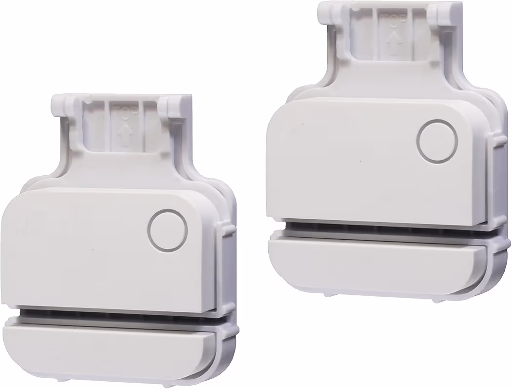

I use a pair of Ring V2 contact sensors, (one for each door) and these holders from Amazon. The holders swing freely when the door opens, thusly opening the contract. I have the contact sensors illuminate an RGBW bulb in the colors red for open and green for closed. That way, at a glance, I can see if both doors are closed before going to bed. The wife and daughter have a bad habit of leaving their respective garage door wide open when entering the house and neglect to close them when they finish unloading their cars.
https://a.co/d/jcoDciG

In regards to the contact sensor pairing. I'm liking @masachapa34 setup
Ring V2 contact sensor and the plastic hinge attachment that fits that sensor soo perfect looking
I'm not a fan of the metal hinge bracket alternative but not opposed if I have to go that route
My footnote question in the Ring V2 contact sensor ...has it been resolved in regards to the Pairing Woes...I have been reading about in the past?
Last I read successful pairing of those sensors by way of SmartStart. Just wanted any updates from any of you well experienced folks....that can share any insight
@RC51_Tofuman The Ring contact sensors paired immediately with smartstart and have been stable since installing. They install cleanly into the plastic brackets from Amazon and still provide easy access to the batteries and/or reset button when necessary. I'm really happy with the way this came out!
