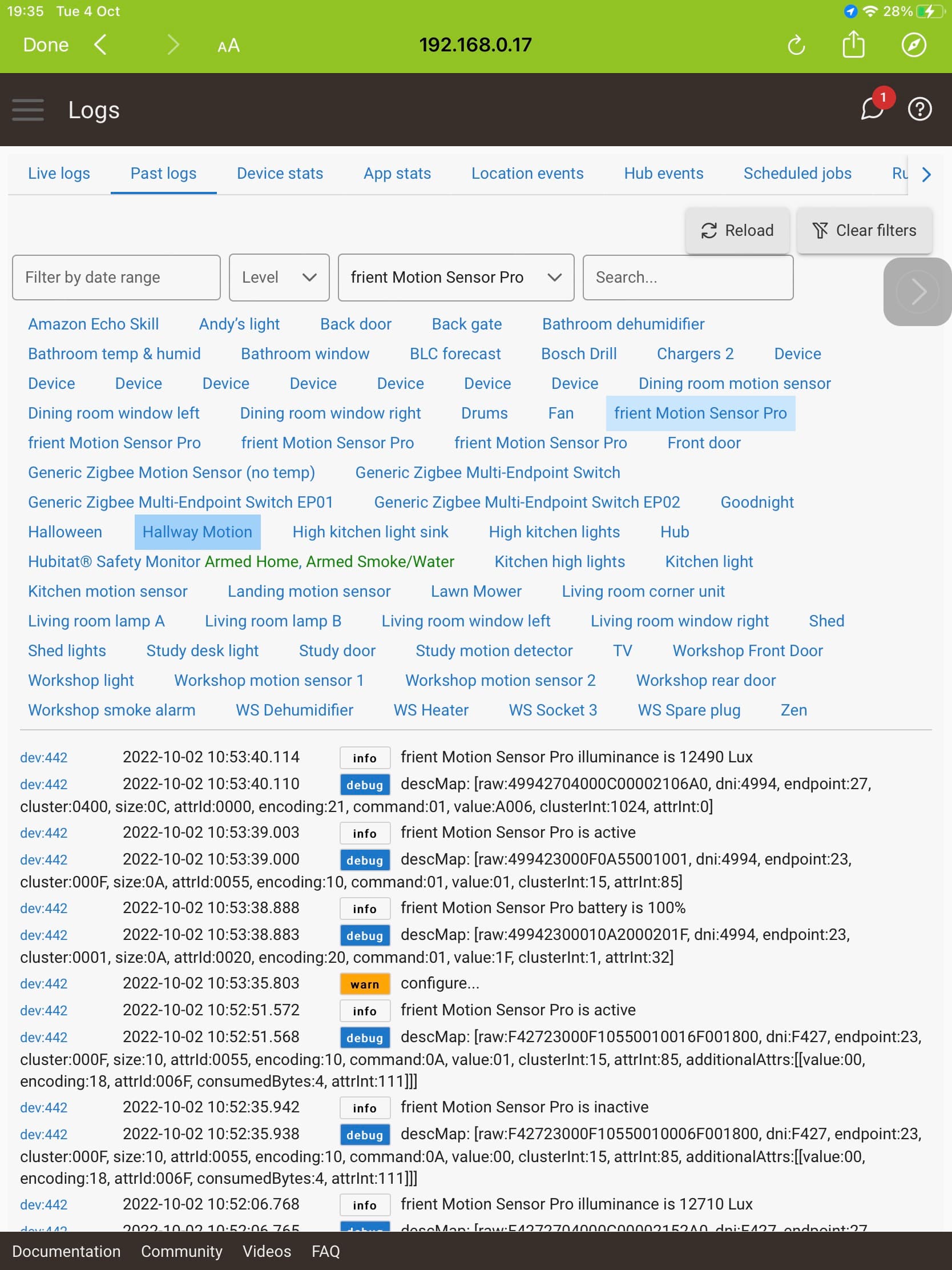

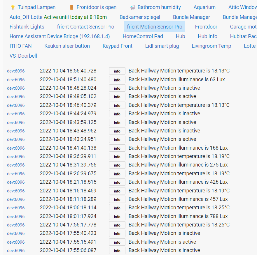

Are the status figures there when you open the device page without having to hit the configure button?

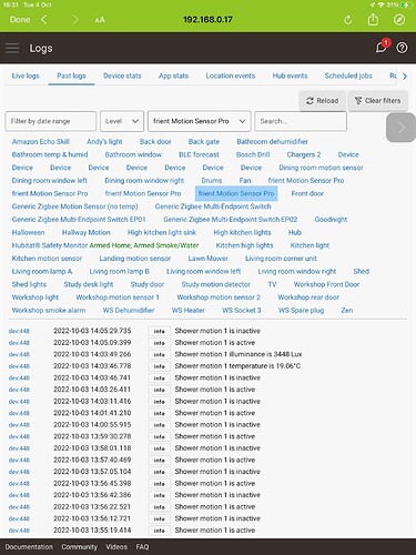

Well, that’s weird. I only have one Frient motion sensor pro device installed and yet there are four show up in the logs. :thinking:
What’s that about?
Had to pair twice to get it working, hit configure, wait a bit, then all attributes became visible.
Did you remove the device before pairing it again?
Normaly on e re-pair, you leve the device in Hubitat alone and on the re-pair it finds the old device-id again.
Mine doesn’t do that reliably.
Yes I did, but I wonder if it adds another one when the pair times out and I’ve hit it again?
I wonder if that is what the problem is. :thinking:
I’ve deleted the device, but if I go into another device and then select logs, four of the Frient devices still show.
How do I get rid of them?
Logs for deleted devices will eventually fall off as the log fills.
Okay, thanks.
I’ve learnt so many new things with this problem. :slightly_smiling_face:
