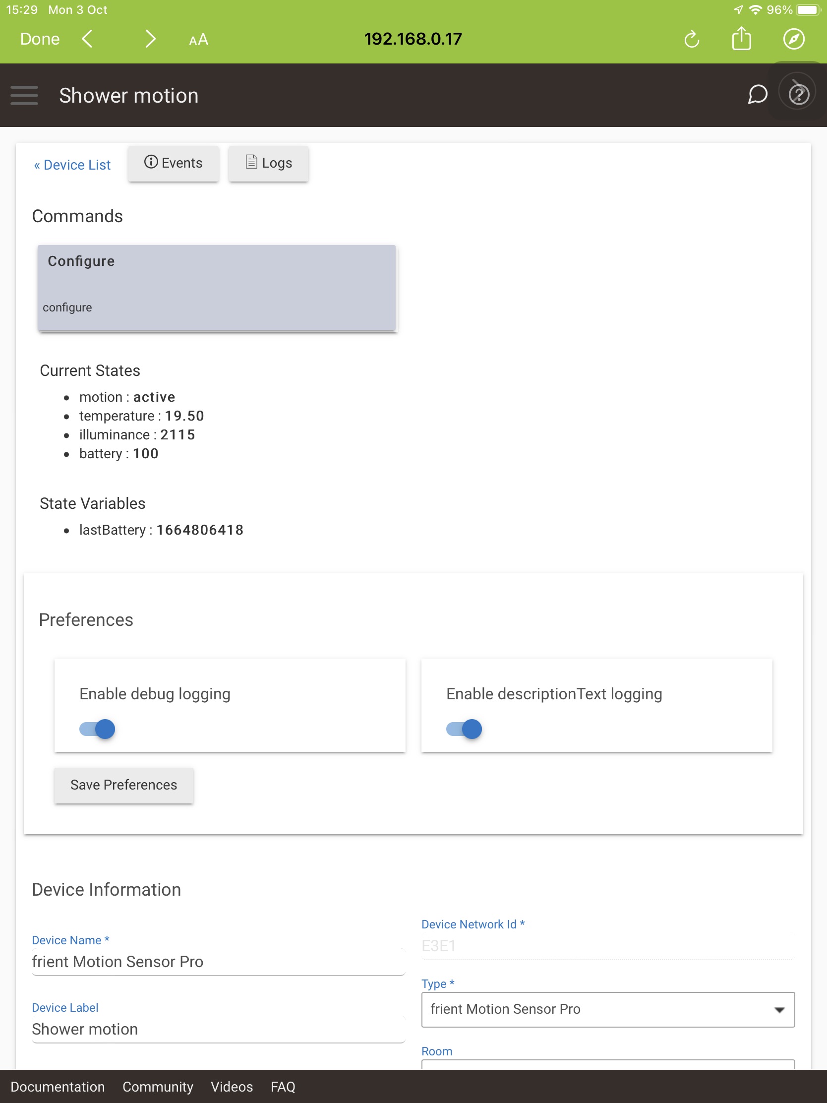

Change to the built-in driver called "Device". Click Save. Then click "Delete All States". Then change back to the driver "frient Motion Sensor Pro", and click "Configure". See if the states start appearing on the Device page.
This one makes zero sense to me. Clearly the device is working and producing data. What browser is being used?
I’m using the app on an iPad
I’ve tried Safari and Chrome. Both do the same
Assuming this isn't a browser artifact, could a corrupt database cause state updates not to appear on the device page?
I did have a hell of a job getting it to pair and had to try more than 10 times, removing the device each time.
Try removing it, go to backups and download a new backup to your pc. Do a soft reset and restore from the backup you made to your pc. Factory reset the sensor then try pairing again right next to it...
Thanks for sticking with this.
Okay, so:
Restored previous backup for a few days ago.
Check device was no longer showing - it wasn’t.
Paired sensor - right next to hub. Paired first time without issue. (Will remember that for future pairs)
Checked device page - still looked the same.
Clicked configure - after about a minute, all four statuses showed up.
Clicked save preferences - all four statuses disappeared.
Tried clicking configure again - sometimes nothing happens, sometime just motion shows up, and sometimes some show up but not others.
Tried creating a tile to show the different sensor outputs without success.
Set to attributes but the only choices available are
Tried setting it to illuminence and motion, just says unknown.
Tried using illuminence in a simple rule and it was available. Let’s see if that works. I’ll let you know.
Why do the illuminence, temperature and motion not show up permanently in the device page?
Why can I not setup a tile with them on?
Update - the simple rule used less than 5000 illuminence as a restriction.
The rule completely ignores it.
The sensor is measuring though. In daylight it reads over 21000 and in dark reads a few hundreds.
I don’t know if pressing configure on the device page is meant to get updated statuses, but it is very unreliable. Sometimes when clicked it doesn’t respond at all even when waiting several minutes, and some it responds straight away.
I’ve tried the sensor close to the hub and far away and it doesn’t seem to make any difference.
