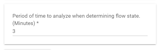

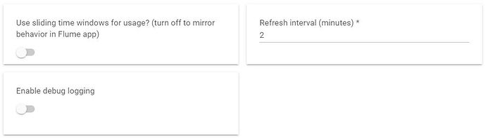

I'm seeing the Flume device taking up a lot of hub processing time...second highest on my hub's list. Is this expected? Any things I should do to manage this?
State looks normal:

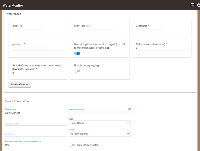

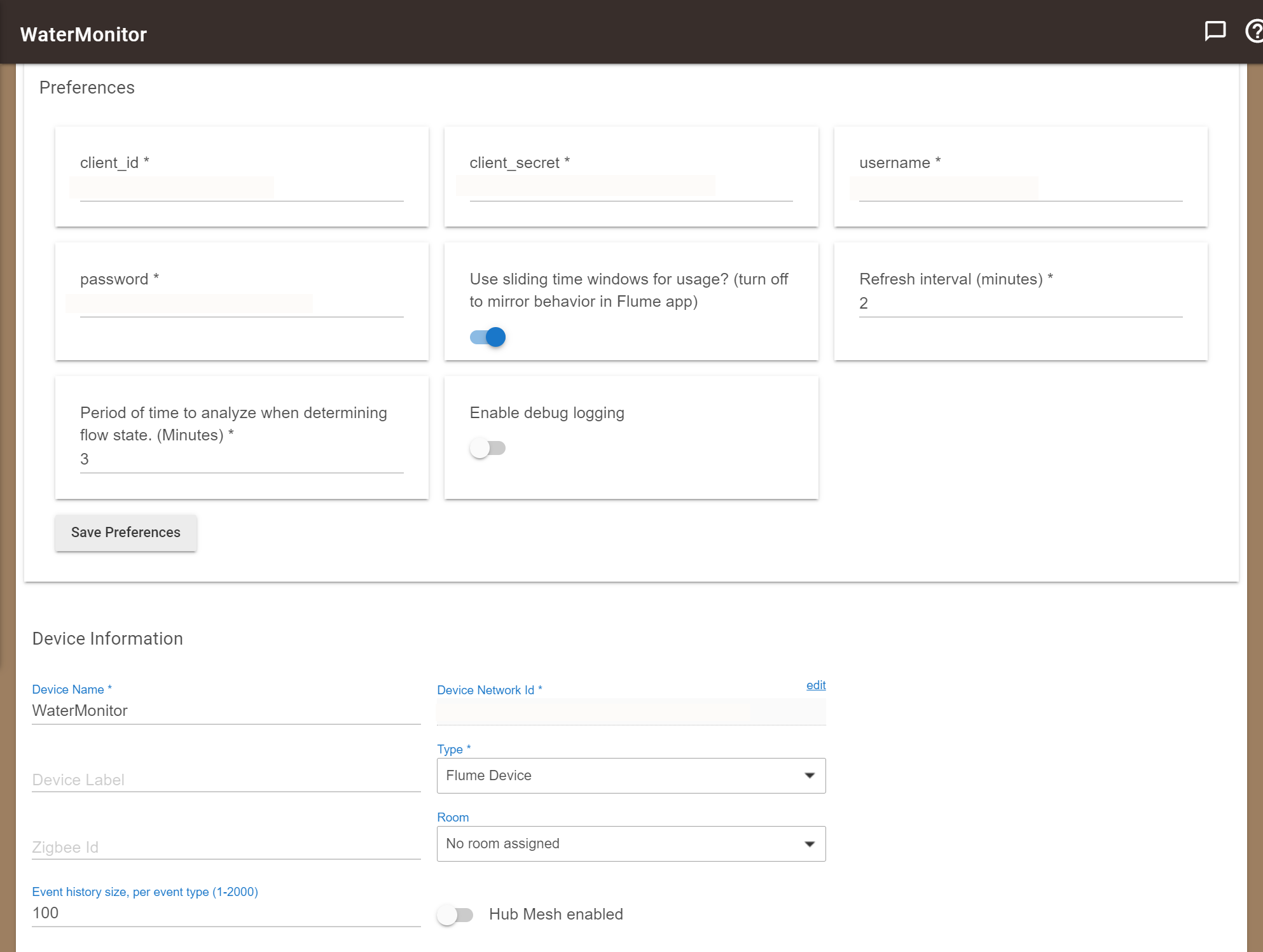

Some settings:
Those settings look pretty typical to me. If this one is in your top 5, maybe your other apps and drivers are just really efficient? :wink:
Mine is showing 3.9% of busy and 0.146% of total time. How do those compare to yours in relative terms? Are you noticing performance issues or some other effect that makes you concerned by the utilization here?

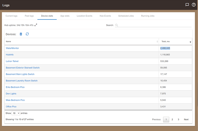

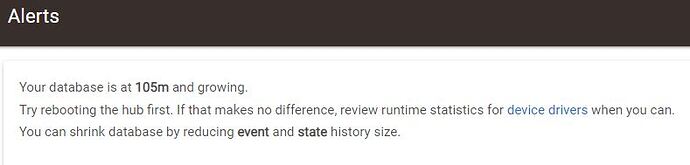

I am getting warnings from HE that my database is too large and Flume (along with some weather sensors) was leading the pack. :wink:
I checked %, below. % Total seems fine, % busy seems high.
Yeah, I agree that yours seems oddly high.
FYI, each refresh does 4 cloud interactions in order to gather all of the needed info. The current structure of the driver is to do those synchronously for simplicity.
I suspect that the time spent waiting for them to turn around and come back from the cloud is contributing to the 'busy' time.
I haven't done much profiling in drivers unless I have seen a notable slow-down or other issue that arises.
But I am curious this time... I'll PM you to see what we can cook up to try to reduce that number, and I'll be interested to see whether it improves performance on anything noticeable.
