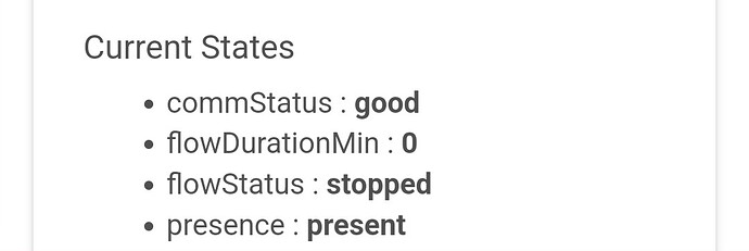

If I understand correctly, you're saying that you could have a slow flow lasting for an extended period of time and that if there were a 2 minute break in the flow Flume would reset the flow and start over, therefore causing a rule to not fire because of that 2 minute lull?
And, by changing the flow duration to say 5 minutes that would eliminate the potential false reporting of the small leak?
Am I correct that is the only, although very important function of this new attribute?
exactly
more so, it would allow the indication of a slow leak that might have gone undetected. or "eliminate the lack of reporting of a small leak"
This also introduced the flowDurationMin which calculates flow time, by using this new preference to see if there was any flow in that time period (ie 5 min in your example as opposed to just the standard refresh time which is 2 min default)

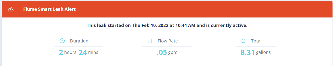

so, its saying you had constant water flowing for their 2 hour indicator at a flow of .05 GPM? Thats a nice catch, but that is also a substantial volume of water .. close to 4 gallons?
The amount is a little confusing - the Flume reading says 8 gallons, but the meter reading isn't clear to me (at least in gallons), as the red pointer seems to say about .05 cubic meters flowed (.09 to .14) - do I read that right? So that's like 13 gallons? Not sure...

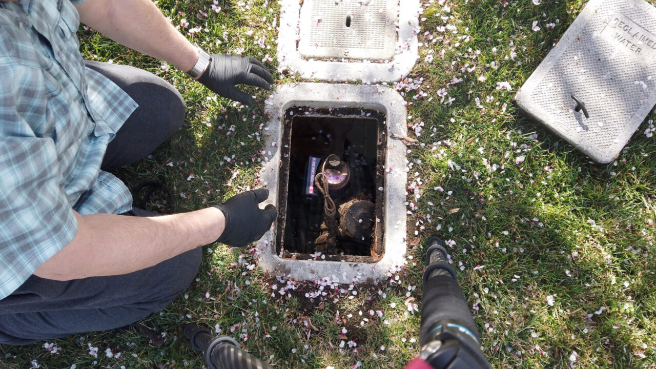

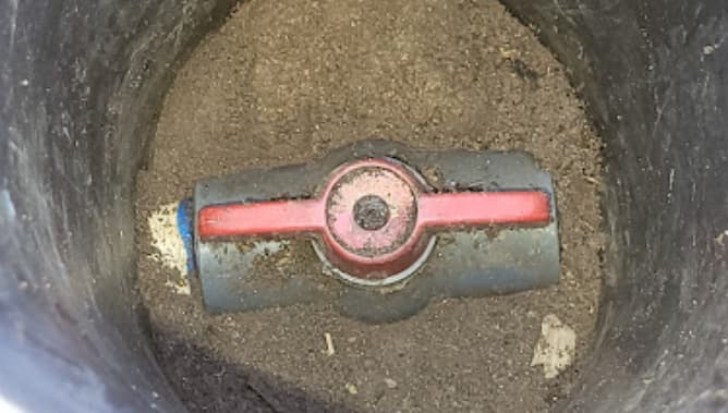

One thing I noticed - the ground around the front yard valve seemed a little moist. Not 4 to 8 gallons wet at all, but wasn't mostly dry like I would have expected. It's about a foot or more below the ground, in a green PVC column, w/a cover on it and under a layer of bark. No rain recently. So I'm wondering if there is an issue related to that valve or the piping near it. (Pic below looks dry, I think since I used my flash, but the dirt felt moister than I would have expected. But could just be cold temp of water drawing causing condensation from the ground?
It could also be on a pipe between the valves, eh? Rent a trencher, dig up the lawn. You'll definitely find it that way.
Joking aside, it's going to be tough to track down. Moist ground would likely be close to the leak, but that's not enough water to create a puddle over that period of time unless your soil drains really poorly. So, I'd start digging small holes close to the moistest part of the ground.

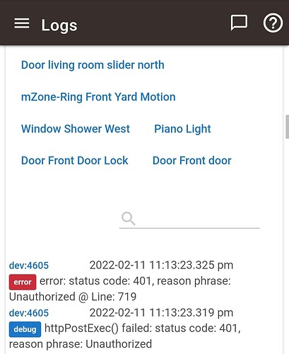

Looks like every two minutes... Linked to the preferences settings?
Ahhh... Com status is error. I did a firmware update to one of my UniFi AP's earlier tonight. So the network would have been offline for a few minutes. The base unit in the house shows solid blue so it looks like it's connected, but maybe the unit out front didn't reconnect to the base unit. Refresh didn't help.
Interesting, maybe something is iffy in the authentication flow in the driver. Initiatlize would probably have fixed it, too. I'll take a look to see if I could improve the error handling.
Thanks. Be interesting if anyone else could duplicate my results by turning off Wi-Fi for five minutes and then turning it back on.

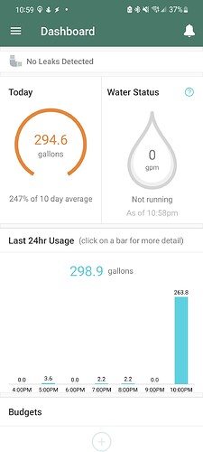

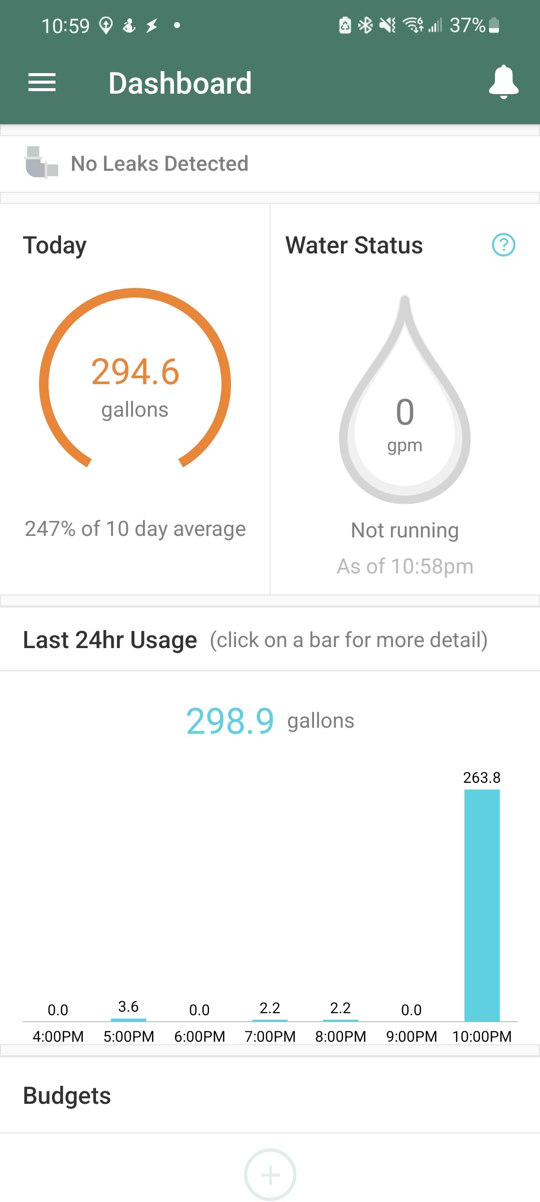

Did I say how much I love this integration yet today? WAF is very high - last night she said "So no leaks, right?" I showed her the dashboard in the Flume app and told her I'm setting up specific text notifications if water is flowing when we're both gone from the house (outside of irrigation schedule) and she actually said...wait for it...
"Cool. That is a really good idea."
Boom! WAF = 100 just in time for Valentine's Day. You guys made me a super hero.
