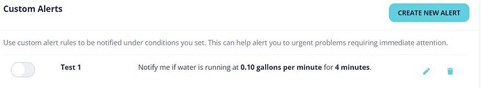

- not everyone can create custom alerts (pay for insights is my understanding)
