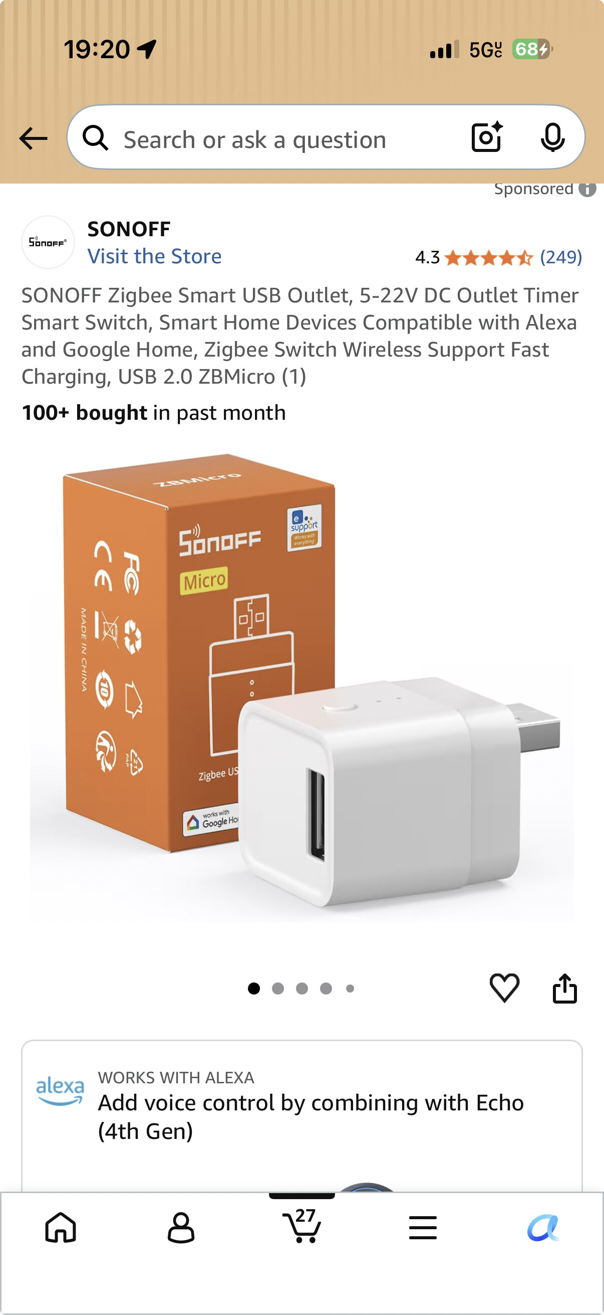

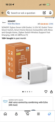

Thought I'd come back with an update about these devices and my setup. I still have zigbee reboots but they're very sporadic with none of these devices in place. I had a plug go bad and decided to pair one of these up as it's the area I had purchased them for originally. I had a radio reboot about 5.5 hours after adding it. I didn't do anything and just let the system soak. It's been almost 4 days and no reboots or issues. It's not chatty at all. The only number that stands out is the Hub Actions. It's at the top of the list with 130, Zigbee Map Helper at 114 and then a Sonoff button at 8. I'm going to put 2 more in place when I get the chance.

Just another data point with recently purchased Sonoff USB switches: I added 2 of them to a C-8 with 105 Zigbee devices already in place and they have been great. Each one was repeating for 6 other devices last I checked and signal strength was excellent with turbo mode enabled. I know you said they aren’t chatty, but did you look at the Zigbee logs or just device logs? The previous firmware version was extremely chatty from what @kkossev said. The ones I bought from Amazon have the newer firmware and the Zigbee logs are pretty quiet with respect to these devices. I plan to add a couple more since they seem to be excellent repeaters.

Both. And yes, the latest firmware addressed the chattiness and is available via OTA. Although no issues I'm still surprised at the hub actions. More so because I simply don't understand it.

This is the other way around: the Sonoff device is periodically sending 'keep-alive' messages that require a response from the hub. That's why you see an unusual number of 'Hub Actions' on the device stats page. You can leave the healthStatus configuration as it is by default; it is passive and does not affect the Hub Actions count.
This is the way some of the Sonoff Zigbee mains-powered devices operate, and actively repsponding is the way that Sonoff, HomeAssistant (Z2M), and other Zigbee hubs are handling these requests. So does the Tuya Zigbee Switch driver that I recommend to use with the ZBMicro USB switch,
Make sure your Sonoff ZBMicro has a 'Software Build' version 1.0.5, the previous versions are way too chatty.
