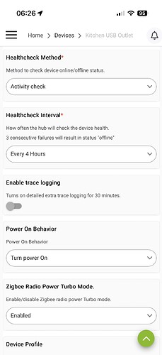

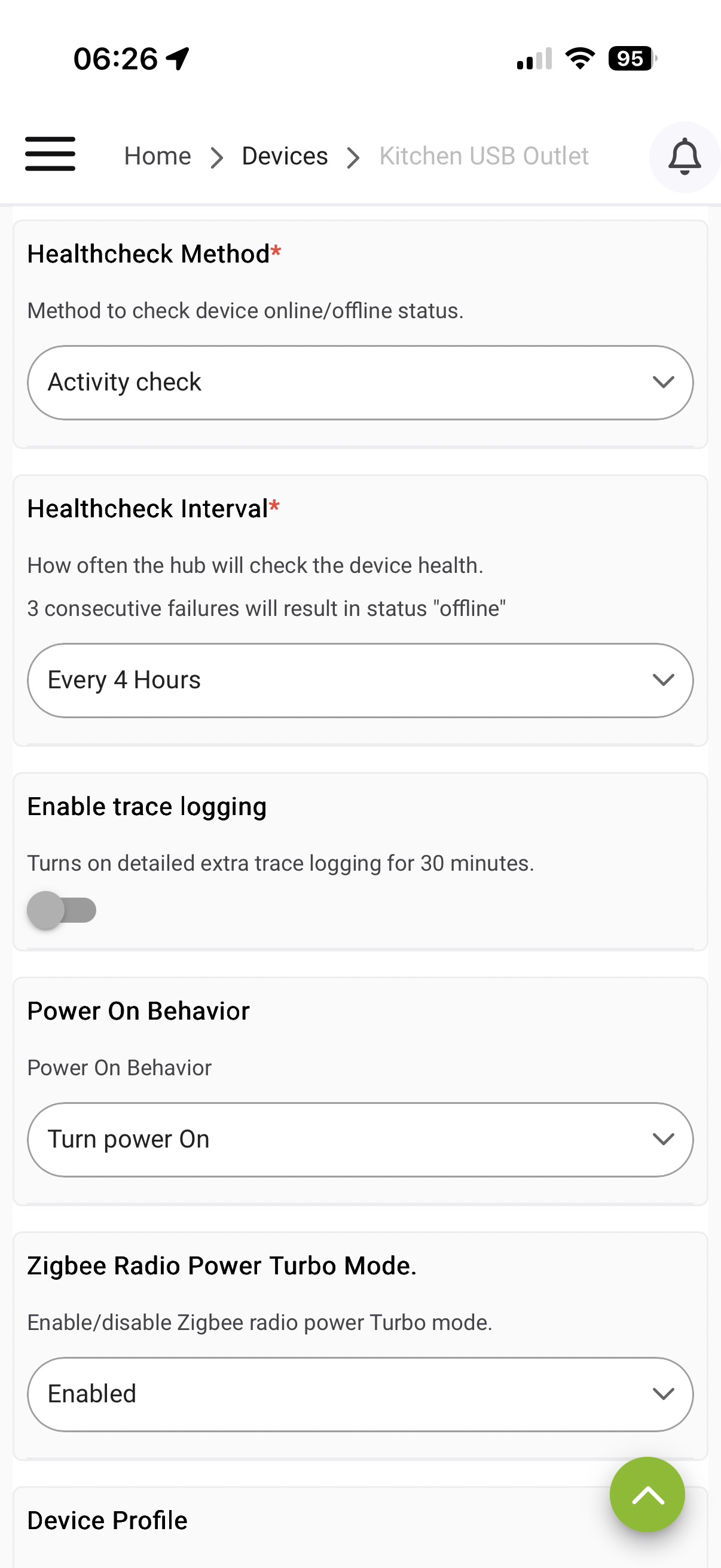

Firmware 1.0.5 is what mine are. I have 4 of these in use and they have been absolutely solid on C-8 Pro using @kkossev ’s driver using these settings:
All four of mine are with 1.0.5, and working as intended.
Thanks @kkossev . Ill move the to the other driver and see if it clears the issues. Appreciate it
