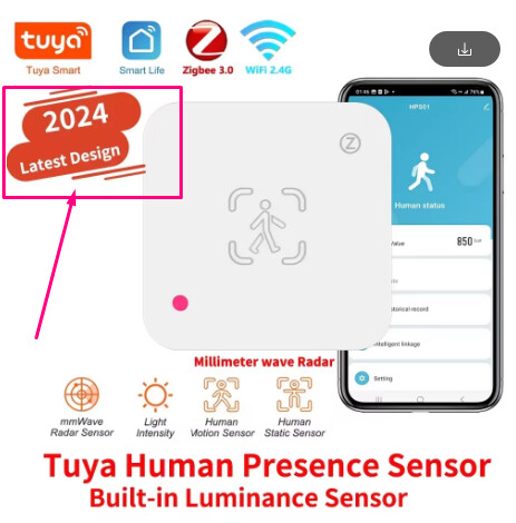

I have a few of the white box human presence detectors. Can't seem to get them working. Below is the info I'm seeing. Tried the white square basic profile and a few others, but it's a no go, the presence state doesn't show and doesn't change if I set it manually.
  • endpointId: 01
  • application: 4A
  • manufacturer: _TZE204_ex3rcdha
  • model: TS0601
  • tuyaVersion: 1.0.10 ####

Hi @morris1529 ,
This is a new mmWave sensor manufacturer and it was not supported in the previous driver version...
Please manually update the driver to the dev. branch version 3.3.0 "2024/09/14 10:44 AM"
Then select 'LOAD ALL DEFAULTS' from the Configure drop-down menu and click on the button above.
Let me know if it works. This new device may be a good one, not spammy!
Is it this one? ( AliExpress link )
That's the one! I'll give it a try today or tomorrow and let you know, thanks!
Ok good news and bad. It detected the new profile and assigned it. The luminance is now working and after a few minutes, additional states started showing up.

Unfortunately, the motion is still not moving. I manually set it to active and back but it hasn't changed on it's own either way. It is in an empty room. The log is showing this sequence repeatedly.
