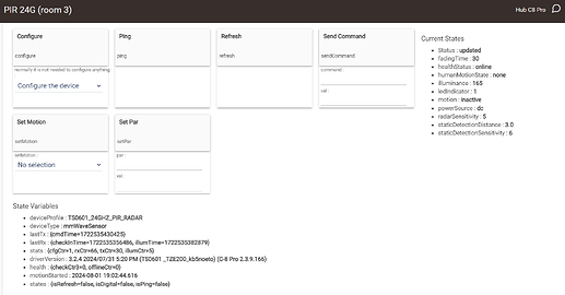

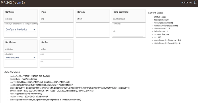

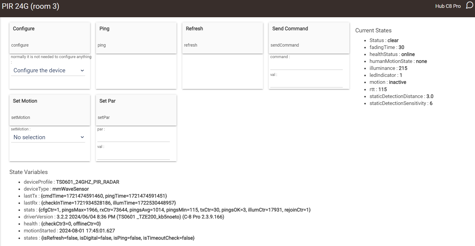

I am getting the error below for TS0601_24GHZ_PIR_RADAR
Summary
dev:39502024-08-01 04:46:50.095 PMerrorgroovy.lang.MissingPropertyException: No such property: cluster for class: java.lang.String on line 1341 (method parse)
Is this with the latest version 3.2.4 ?
No, I am still on 3.2.2
Update manually to the latest dev. version, it adds also battery level reporting for this radar.

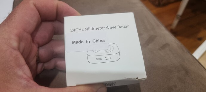

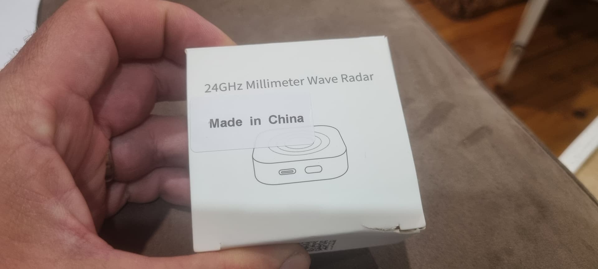

I'm not getting any state changes for what was detected as below. Pic of device that looks different than other ones shown in first post. This was advertised as Tuya zigbee mmwave presence sensor. That is all I have re the device.
  • endpointId: 01
  • application: 4A
  • manufacturer: _TZE204_muvkrjr5
  • model: TS0601
  • tuyaVersion: 1.0.10

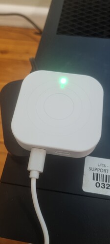

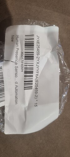

Here some pics and a link the user guide.. Although that doesn't really tell me much re the device type.
