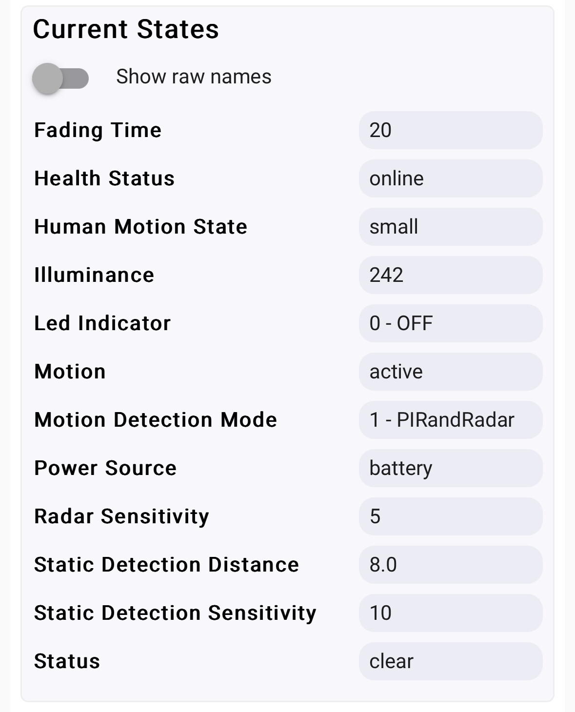

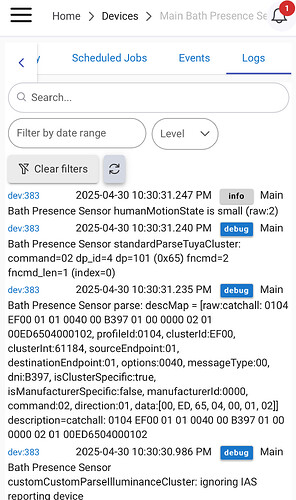

I'm not sure if I'm just realizing this now, but does anyone else notice that it takes a really long time before the sensor goes back to Inactive? It seems to be stuck to the "small" human motion forever. I have Presence keep time set to 20 seconds. Debug logging doesn’t seem to point anything.
Device Profile: TS0601_24GHZ_PIR_RADAR
Driver Version: 3.5.1 2025/04/25 10:29 PM (TS0601 _TZE200_kb5noeto) (C-8 2.4.1.157)
P.S. No one has been in or near the room since that last “small” motion. Not sure why it’s taking forever to become “Inactive” again. The sensor isn’t facing towards where we are and we are at least 2 rooms over.
