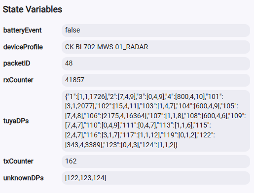

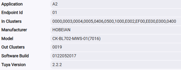

Snagged a couple of 24GHz units off Aliexpress that I thought were clones to ones I had before. Plastic wise, yes, software, not so much! :joy:
They show up as "HOBEIAN CK-BL702-MWS-01(7016) 24GHz Radar" and are almost identical as the "TS0225_2AAELWXK_RADAR" for DP's. Only real difference is the humanMotionState. They add a state 4 (moving away) and a state 5 (moving towards).
Just a note on these. They work amazing, very little network activity (only what is needed), and not chatty like other el cheapo Aliexpress units that I snagged.
Here is the link if anyone is interested: https://www.aliexpress.com/item/1005008232999662.html

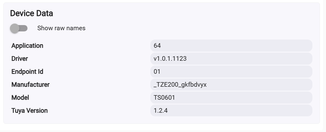

Can you post a Device Details screenshot (where the Zigbee model, manufacturer and Tuya firmware version are shown)?
You bet:
Here are the DP's that I mapped/didn't map:

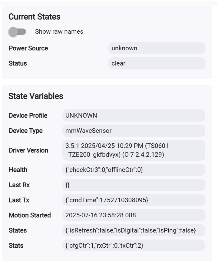

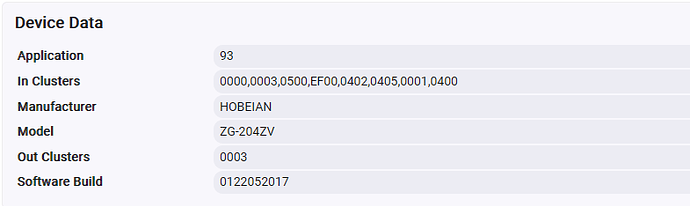

I just got one of these HOBEIAN Human Motion Sensors too. Seems to be a different one.
I just bought my first one of these, but it seems like it is not supported. The listing seems to indicate it is a device as listed in this thread, but the inclusion data is not correct.
MmWave Human Presence Sensor, Zigbee Millimeter Wave Radar Detection Sensor, Requires TUYA HUB, Support Home Assistant Zigbee2mqtt : Amazon.de: Business, Industry & Science
Go to Preferences, toggle the ‘Advanced Options’, Save and refresh the device page. Then, from the Preferences ‘Device Profiles’ drop-down menu try some of the ‘TS0601’ profiles - hopefully the first one may work. If it doesn’t, pair the sensor once again to your hub, with this driver already assigned and configured for ‘TS0601_xxxxxx’ profile.
Based on the onClusters list there is a chance that this device may work with some of the HE inbuilt motion sensors drivers. Click on the Configure button after changing to the inbuilt drivers.
HE also has an inbuilt mmWave driver, search for it in the list of the device ‘types’. It may work for the basic Motion active/inactive function.
Thanks for the suggestions. I did this, but unfortunately did not work. On the back of the device it lists zy-m100-24g, but choosing this device will not work either.
I then serched the community and realized that the issue might be that I have a C7, which I believe is not Zigbee 3.0. Perhaps it is time to break out the C8 in my drawer?
It’s possible that this new device may not remain connected to a non-Zigbee 3.0 hub, even though all other mmWave sensors using Tuya chipsets appear to be compatible with the older C-7 models.
‘Compatible’ means that devices will pair with the C-7 Zigbee network. However, their functionality depends on whether the specific manufacturers' Tuya Data Points are recognized and supported in this driver code. In this case, even if you pair this new device to a C-8 hub, it will still not be recognized automatically, as it is new and unknown device.
Try a few more times to pair it to your C-7 hub :
  • put it close to the hub (no more than 2 meters away)
  • Reboot the C-7 hub
  • Pair it as soon as the C-7 web interface becomes responsive after the reboot.
If the pairing process completes successfully (the known device was found), click on the Ping() button on the device web page ‘Commands’ tab. Do you see a numeric ‘RTT’ value, or a ‘Timeout’ after 10 seconds?
It seems that It paired "correctly" now, I at least see more information and Ping does show a value. It still shows up as a TS0601, but the back of the device says ZY-M10024G.

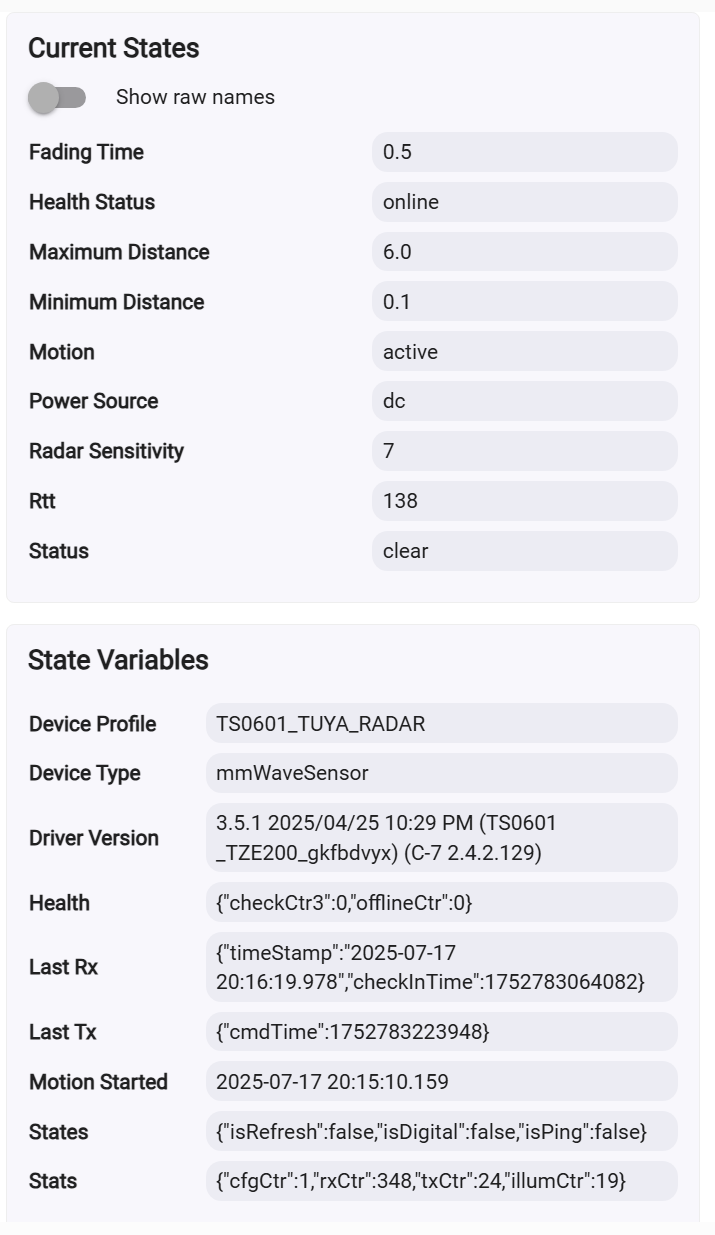

I switched the driver to that version and it does detect some motion, but it is not working as I expect, although it is my first mmWave device, so not sure how it should work.
Device details
Some debug logs
