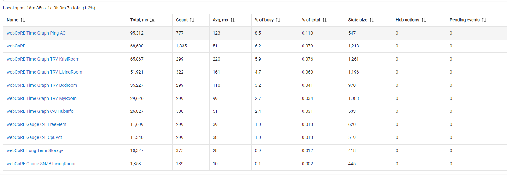

I started using the inbuilt webCoRe graphs ... It is the former HubiGraph app now in webCore.

Bruno, I can encourage you to try the HE inbuilt WebCoRE graphs for analyzing the performance of your thermostats.
I am running the WebCoRE on my main C-8 hub, with excellent performance counts (I mean it does not overload the hub in any way!)
There is a learning curve on how to use the WebCoRE graphs, and especially the LTS (Long Time Storage), but it pays off understanding how your thermostats / TRVs controlled heating is performing and where it can be improved.

Yeah, there is, I once looked at WebCoRE but I didn't see added value for my situation and at that time I was not willing to invest some time in it because I could do everything I needed with Rule Machine...
No, I didn't mean to use webCoRE pistons instead of RM5 - currently, I don't have any pistons, all my automations are on RM5.
The only thing that I use from webCoRE at the moment is the Graphs - it is the former HubiGraph app. I replied to the question about what I am using for the graphs.

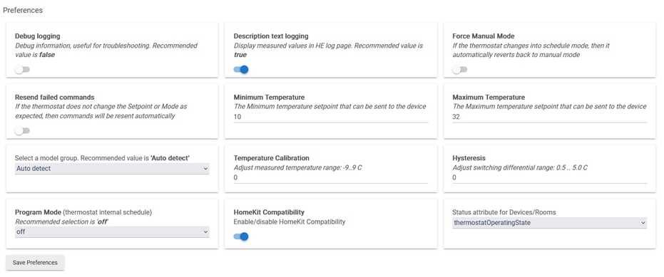

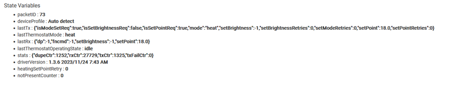

@kkossev,
I have set the hysteresis for the Tuya thermostat a few times.
Unfortunately, it does not seem to stick, any advise please?
Summary
Logs
dev:28492023-12-04 10:36:03.716 AMinfoTuya wall thermostat heatingSetpoint is: 18.0Β°C
dev:28492023-12-04 10:36:03.598 AMinfoTuya wall thermostat Thermostat mode reported is: heat
dev:28492023-12-04 10:35:58.732 AMinfoTuya wall thermostat AVATTO Program Mode (104) received is: off (0)
