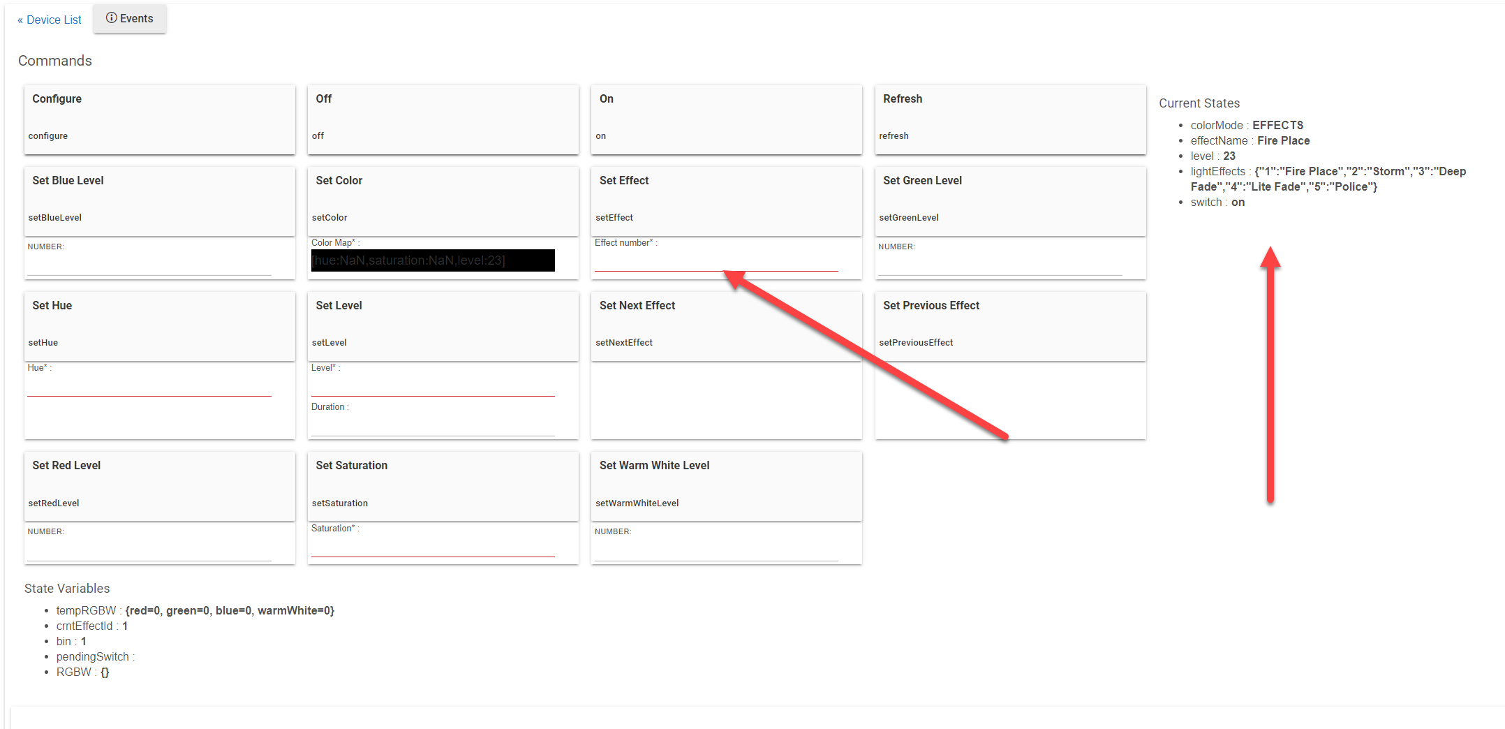

how do you turn on police effect without webcore?can it be done directly from hubitat? i get no police or other effect for changing color automation
I use Sharptools for my dashboard /front end. and I think I created some automation from that, but in Hubitat if you take a look at devices you will see it here.
i saw how to set manually, i want to set them in some automation
for example if switch X is turned on then set my rgbw to police, this is what i can't seem to find unless i use webcore
edit:
seems that i have to choose a custom action in rule machine and it let's me to set the effect by assigning it a number
