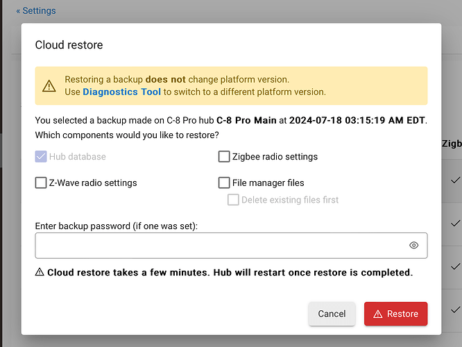

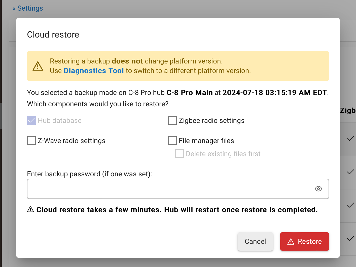

Sounds like you didn’t migrate the radio data; so a couple of questions to help us understand your situation better:
  1. Did you make a cloud backup for migration that included the radio data?
  2. When you restored the backup did you check the boxes to restore the radio data?
Do you mean the ZigBee and zWave checkboxes?
Correct the boxes marked Z-Wave radio settings and Zigbee radio settings
