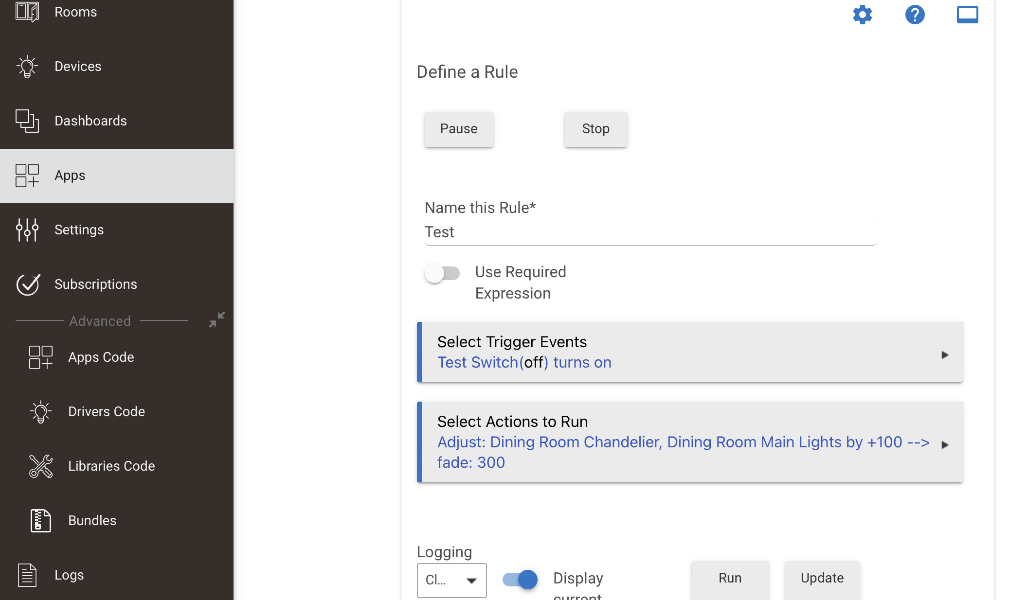

Something like this should do it...

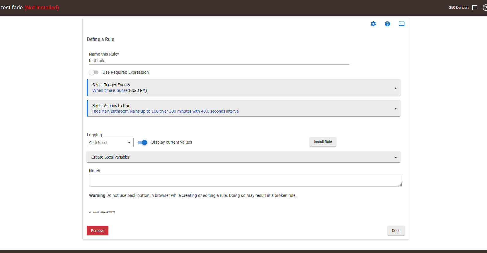

This one works for me... Use Fade and make sure the fade up toggle is checked (lower is default)
The behavior of “fade up to 100” is strange if i have it controlling two (or more) dimmers.
  • If all dimmers are at 0%, it behaves as expected and ramps up all lights to 100% over the specified time
  • If one dimmer is at 50% and the other is off, it turns on the second dimmer at 50% and they both ramp up from 50% to 100% over the specified time.
  • If one dimmer is at 100% and the other is off, it does nothing and ends with one dimmer at 100% and one dimmer off.
The good news is that if I separate each dimmer into it’s own action it seems to behave as expected:
