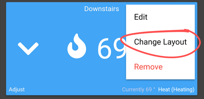

One workaround is to change the thermostat tile to use the Double Height thermostat layout which shows individual controls for the heating and cooling setpoints and works well with devices like Ecobee, Nest, and others that use an auto mode.
