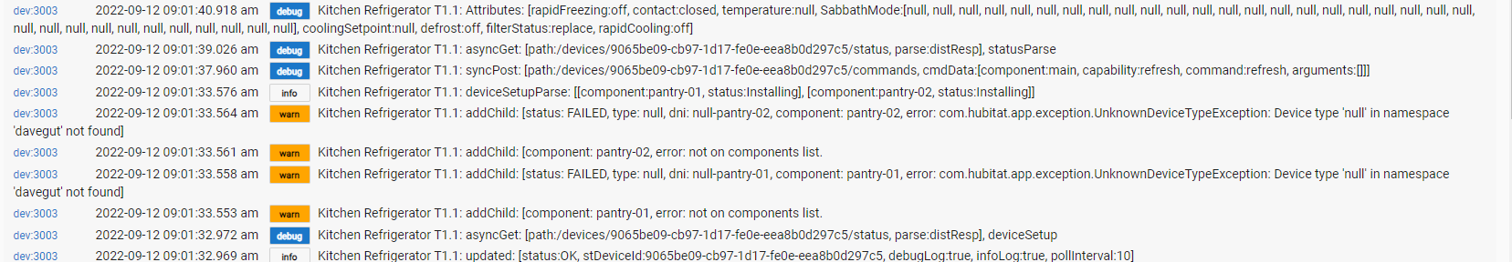

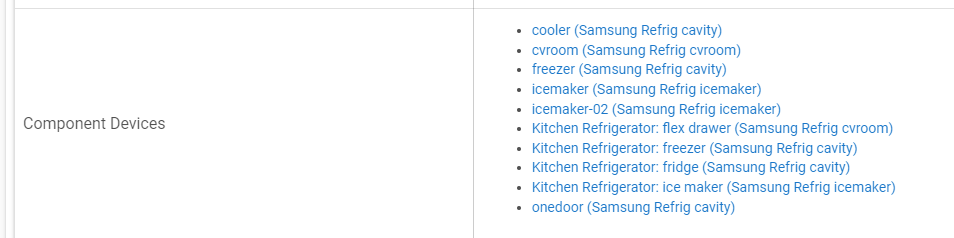

Not sure what I did before, the main package was matched up, but none of the actual drivers so I did a matchup again to fix that. Updated. Went into my fridge device and hit Save Preferences at which time I got a bunch of warning about driver versions and child devices. It made a bunch of duplicate childs.
Changed to the "Device" driver, deleted the states and childs. When back to the Fridge driver and Did a save again, still getting odd log messages and two ice maker childs.
Went to the main fridge driver and removed the "T" from the version number which got rid of the version warnings. Still getting two icemakers not sure why.
The second icemaker is due to the way I parse the return from SmartThings. Yours apparently has two components icemaker listed.
Just delete the second Icemaker for now. I believe the 2nd icemaker is in the return from Samsung. I will have to see how to not install.
Dave
Ok, if you look in my last logs post there is also a warning about "pantry-01" and "pantry-02". I have no idea what those are. None of this showed up with the beta driver, just started with 1.1. If you need any more info from the data collection thing or whatever just let me know.
