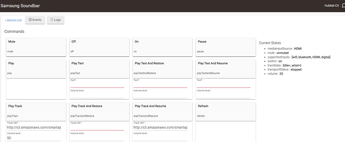

Hi @djgutheinz ,
I hope I am testing the correct way.
I updated the driver - OK
Copied one of the URI's from the code and pasted on a local computer to make sure the PC can reach it - OK, I hear the sound on the PC.
Pasted the URI in the soundbar device page this way:
When I click 'Play Track' - No sound and the following log:

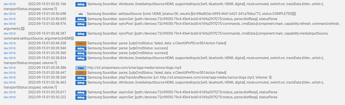

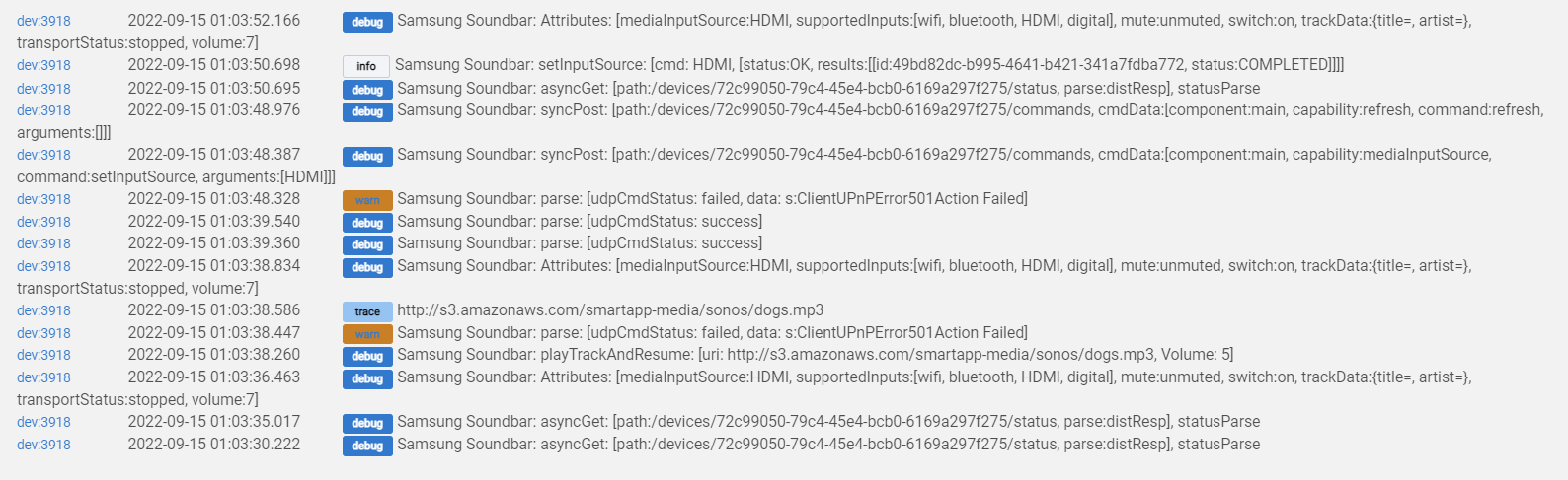

Hi,
Installed the new driver version and still no sound.
I assumed I need to fill in the device IP and check ON the 'Use UPnP for audio notifications'. Tried with and without the 'Use UPnP for audio notifications' and still no sucsess.
Log:

New test driver located at:
"https://raw.githubusercontent.com/DaveGut/Test-Code/master/Samsung_Soundbar.groovy"
Do not enable debug logging. Just run the same test as before.
Error in you logs was sending a volume command to the UPNP capability. The actual other commands succeeded; however, we do not know the state of the volume (may have set to 0 due to the previous error). This works on my Soundbar.
The magic has happened
My soundbar now bark like a dog
