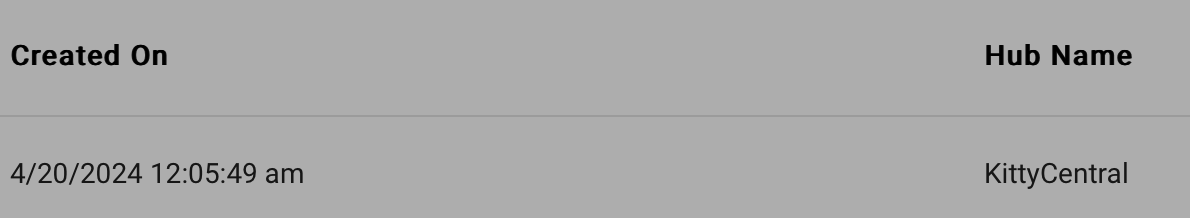

Fun fact: Timezones on the cloud/migration process are screwy.
The correct time was 7:05am Pacific

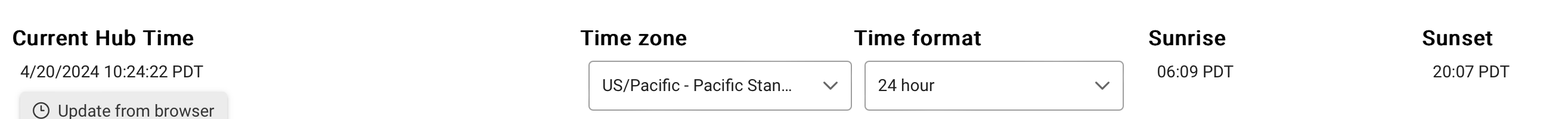

The hub knows the correct timezone:
