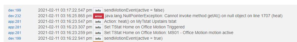

I have the Nest Tstat showing up and since I work from Home it will go into Eco mode when I am in the office downstairs. I setup a motion detector and a Rule 4.1 to set it back to Heat mode when it is a work day and it is not in heat mode. however I see this in the logs (note the Tstat device is set to trace logging)
Dev 199 is my motion sensor. app281 is the Rules engine and dev232 is the nest Tstat.
I see many of the same entries of Error on line 1707 for other tests and even when I am in the device and click any of the settings.
Any suggestions on what to do about this?
Line 1707 in the Tstat driver code does not have a getAt() method but line 2432 does.
is this expected?
Hi, please download MyNextTstat (v3.4.3 and up) -using the same sellfy download link- to correct this NPE which happens after the command has been sent correctly to the tstat (no impact on the operation per se). You just need to copy and save the new code over the existing driver in the IDE.
