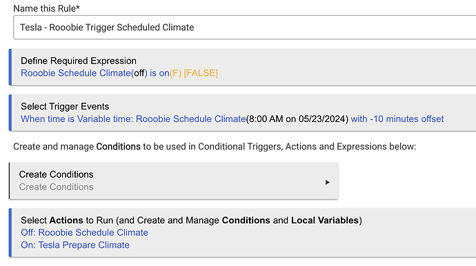

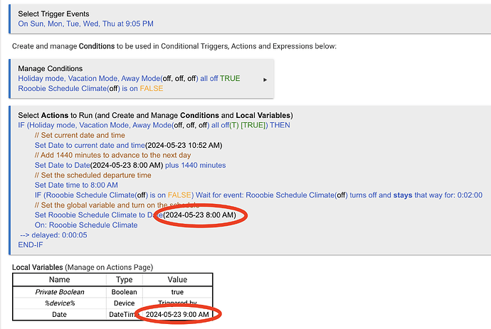

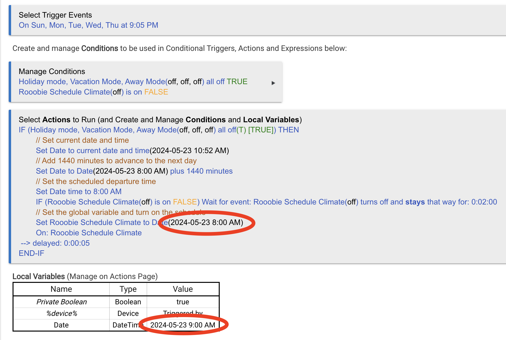

This rule sets hub variable.
This is the rule that is supposed to trigger at 10 minutes prior to the variable.

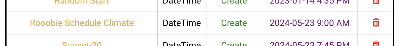

When look at the actual variable, it's off by an hour.

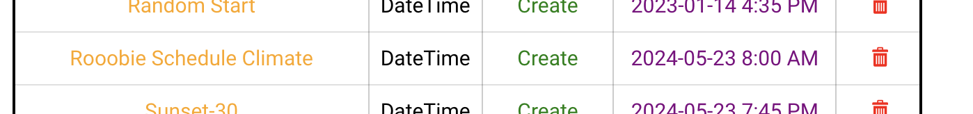

If I edit the variable, it "shows" the correct time, and simply click Update, the variable is corrected.

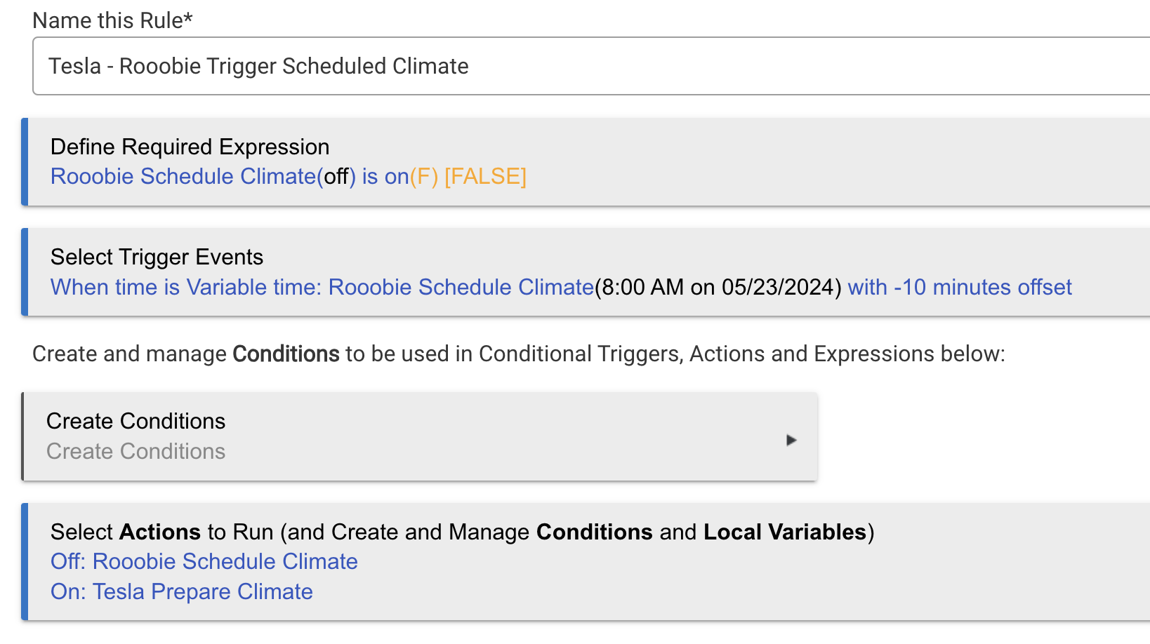

I do that. It works as shown in my 4th and 5th pictures. However, the next time the Rule or dashboard is used, the same errant behavior happens.
