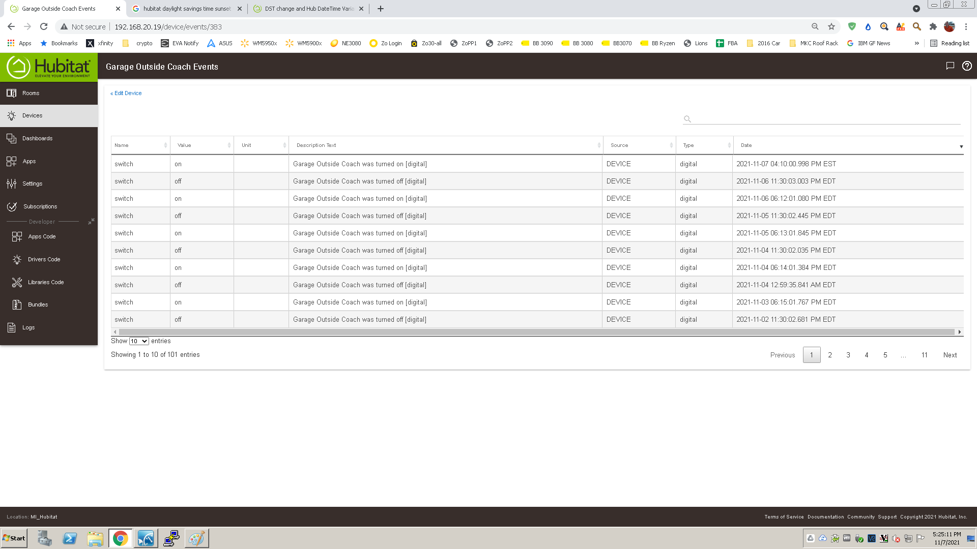

I'm noticing all my lights came on today at 410pm and yesterday was 610pm ( we use sunset with a slight offset 15m before). Does this mean the issue will correct itself or I need to go and reset the programs and update them for sunset time again (or apply a +1hr offset)?
Is the issue with my program? Where you're getting the sunset/sunrise info? Or some internal calculation of the datetime variable relative to GST?

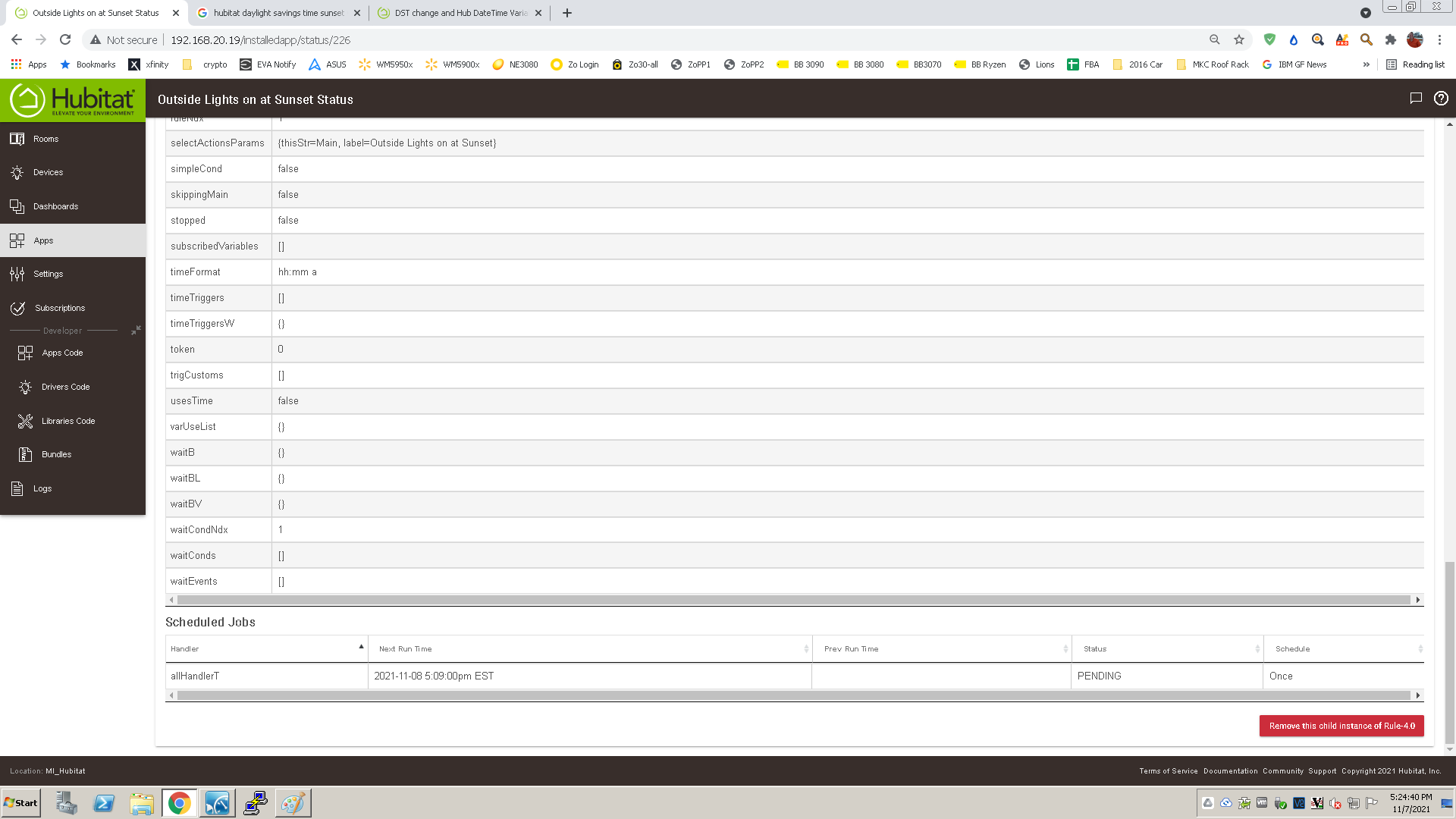

Please show the app setup that caused this, and also the bottom portion of its App Status page (gear icon) where it shows Scheduled Jobs. Do you have your time zone set correctly in Settings / Localization?
I'm using rule machine, actually still on rule machine legacy. Perhaps this is my problem and I need to migrate my rules over?
Whats interesting is now its showing for tomorrow the scheduled job is the right time (roughly 510pm). Yesterday was 612pm and today was 410pm almost like a double correction for coming off daylight savings time happened one time only.
Here's the log of one of the devices in the rule showing the history:

OK thanks for the feedback. Between the time I noticed the problem, and pulled the screenshots you requested I had already taken the following actions:
1.) updated hub and rebooted
2.) edited rule, and trigger, and saved it (without changing anything)
Not sure if either of these fixed the issue, or if it was just a one time problem for last night with the DST ending.
The way to tell for sure is to look at the Scheduled Jobs on the App Status page for the rule.
