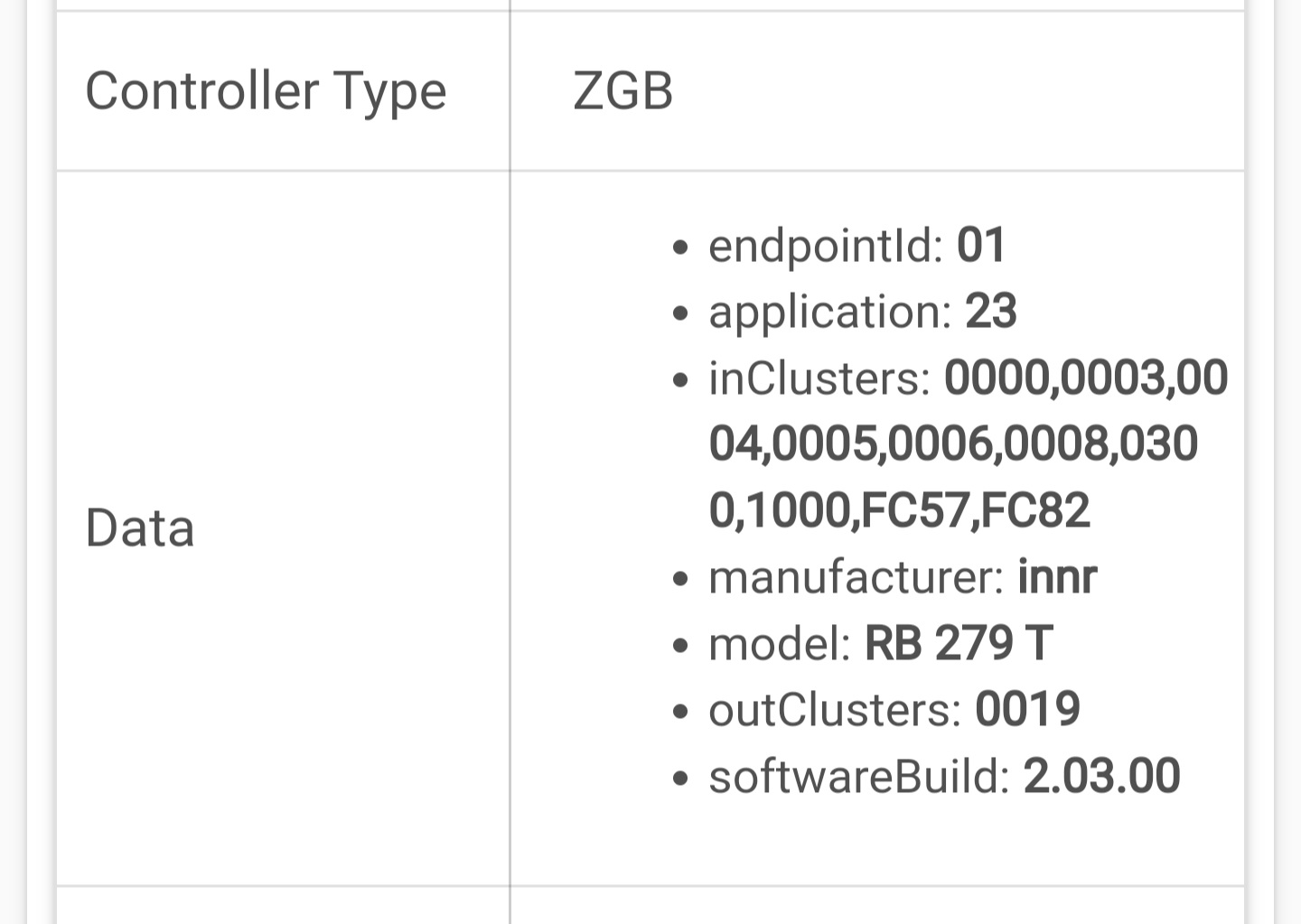

Let's try to save the day…. :slight_smile: We need to identify precisely the device first.
Please follow the tips here : How To Identify a Zigbee Device and post the Zigbee device model and manufacturer IDs, as shown on this device web page in HE.
We have also @Gerry-Innr in the forum who can hopefully help if needed.
Have you tried the Hubitat inbuilt 'Generic Zigbee CT bulb' driver already?
Does this help a little?

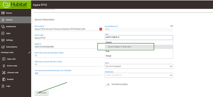

This device uses the standard ZCL specifications, so you will not need any custom device drivers (which this thread is about) to make it work.
Try the Hubitat inbuilt 'Generic Zigbee CT bulb' or the 'Advanced Zigbee RGBW Bulb' drivers (even if your device is not an RGBW bulb!).
If you still can't make it work, I suggest you start a new thread in the forum so we can further troubleshoot and find a solution.

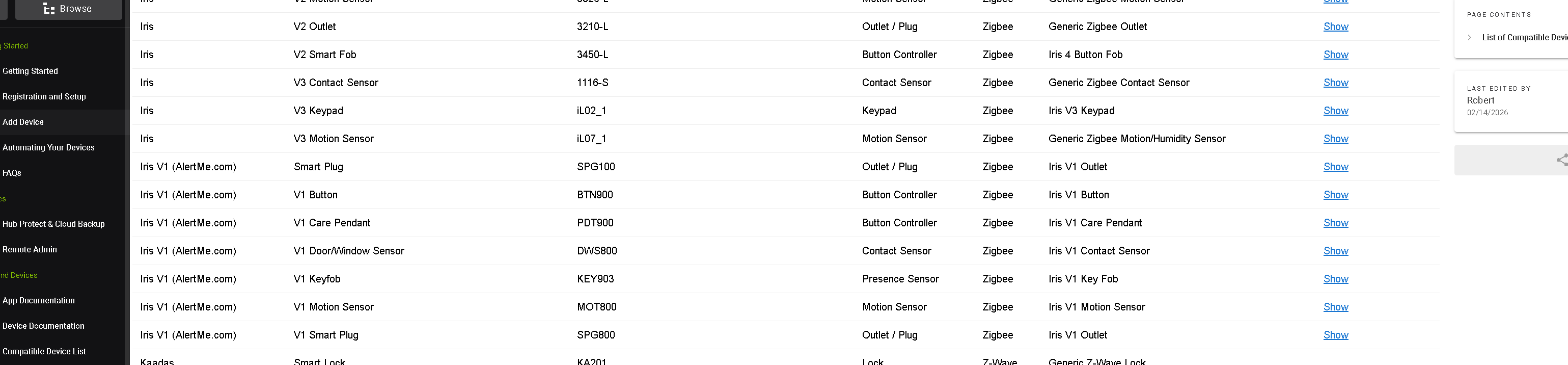

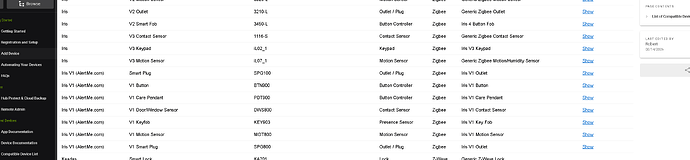

List should be updated to remove the Iris V1 sensors, as they are no longer supported with the C8 Pro
No need to ask. :slight_smile:
That being said, I don't see them in the list above, though there are some where no one added a model number, so I suppose it could be one of those (or the actual AlertMe devices, but the author wrote those for those actual devices, which may or may not work the same).
Ah, Thanks Robert. Maybe I clicked the wrong link, but I do see them. Better Idea, maybe we can add "C7 & older"?
Ah, this forum topic relates to custom or "unofficial" device support or drivers. You are looking at the official list. That one does have a note at the top for certain incompatibilities, including the one you noted.
