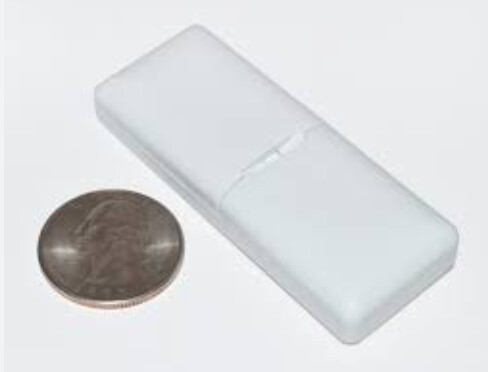

Show up on eBay once in a while:
Different form-factor which can make them useful in some types of tight spaces.

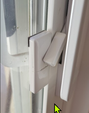

I posted pics there of using the Visonic for sliding door lock/unlocked status. Another example below. The OP in that thread has a much more elegant solution. :slight_smile:

I simply attached the magnet to the lock lever, surprisingly my wife was fine w/that.
The highest hurdle. :wink:
