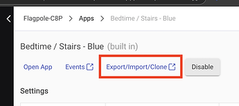

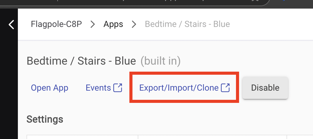

You can access the Export/Import/Clone options by clicking the "circle-i" icon in the upper right...

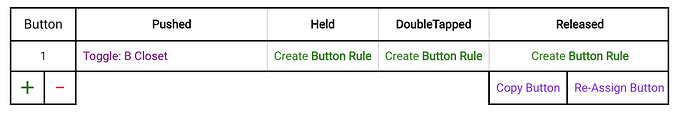

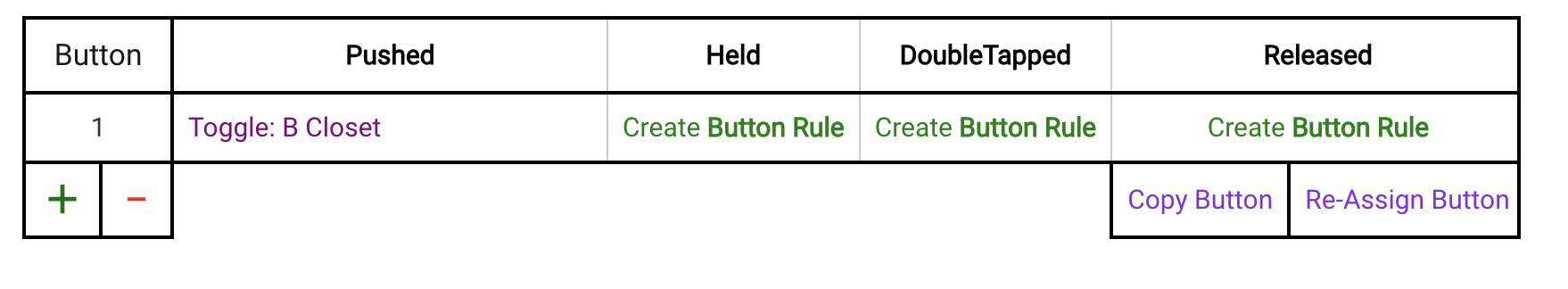

If you are talking about copying the setup for a button into another button, you can do this directly in the Button Controller 5.1 app, using the Copy Button function:

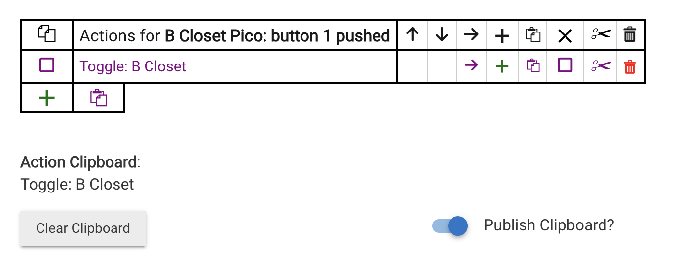

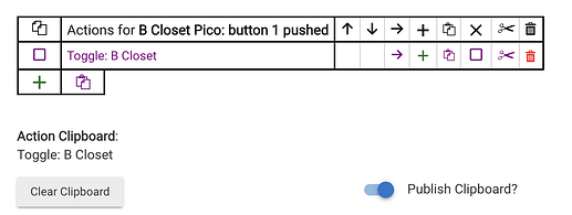

If you want, you can also publish the actions (or subset) to an Action Clipboard, and import those into another Button Rule:
First they were copied to the Action Clipboard, then Publish Clipboard option appears. In another Rule or Button Rule, those can be imported.

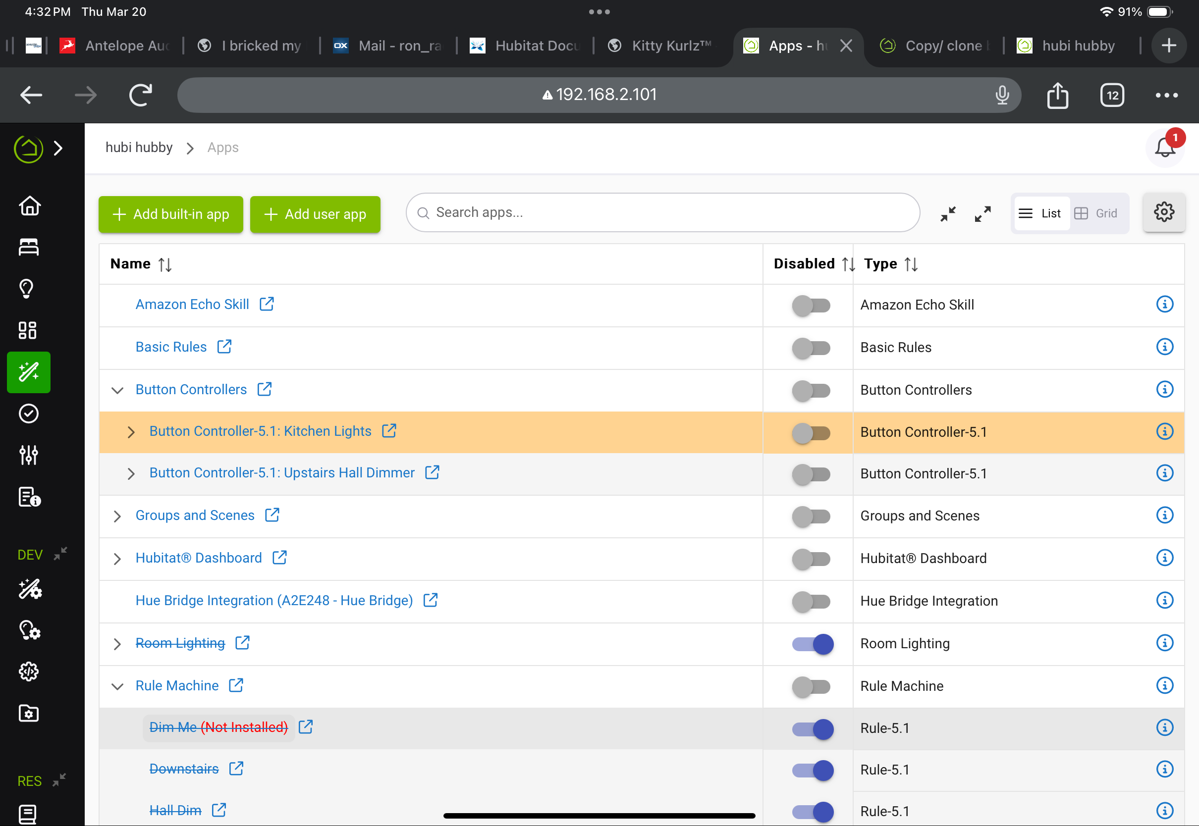

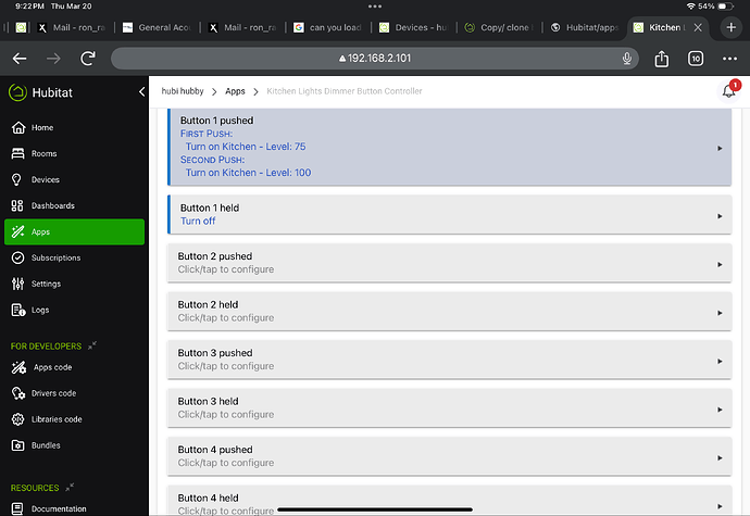

Trying the screenshot again: (I found the (i) on my apps screen. Individually selecting it does not have the (i) as per the previous post)

Try the icon that looks like a Gear? I'm on a beta version of the platform, so I guess that icon tweak may be part of the beta... Hopefully the Gear icon has it.
Cool yes that gets me there thanks. I thought I had already tried that one but apparently I did not.

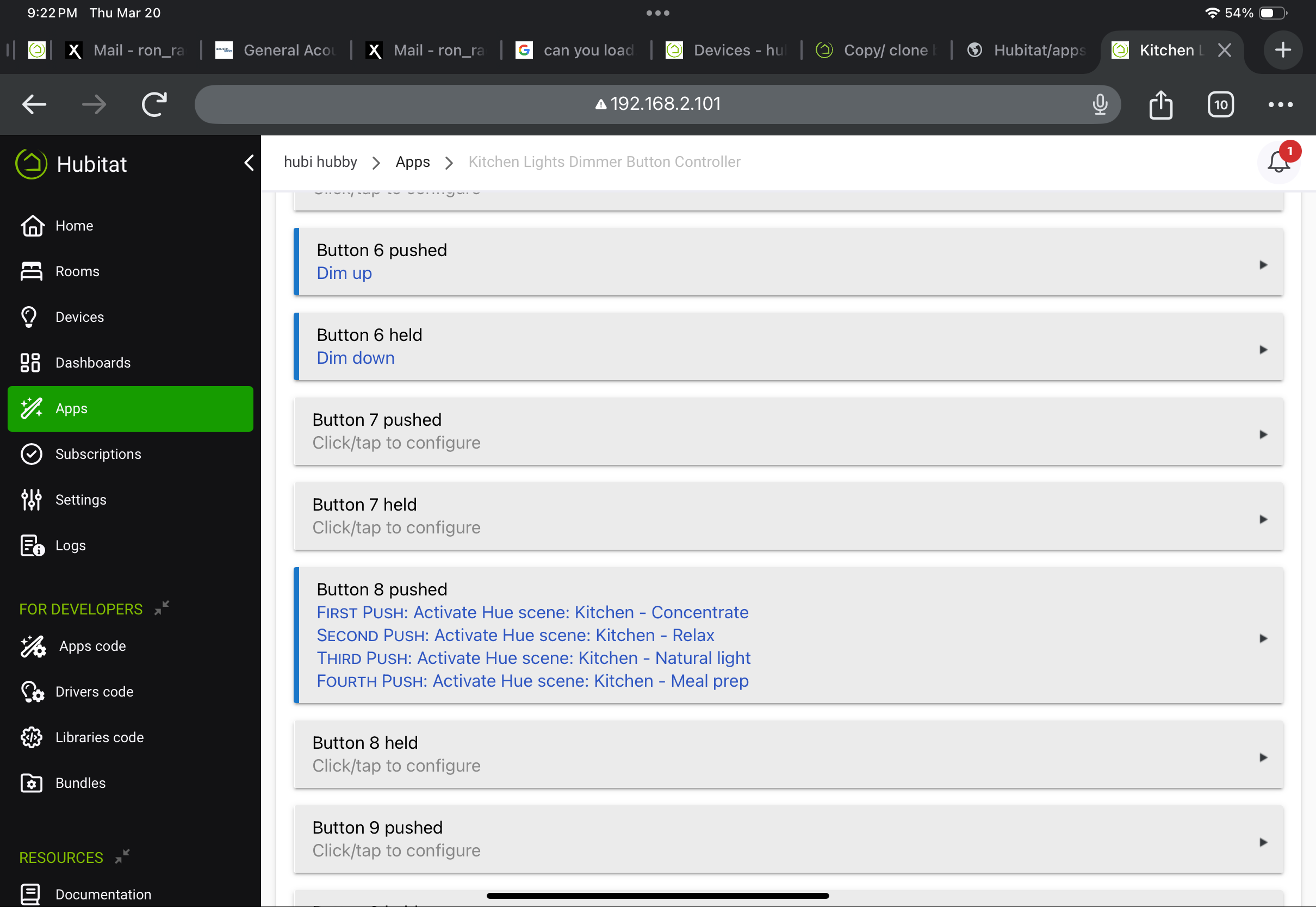

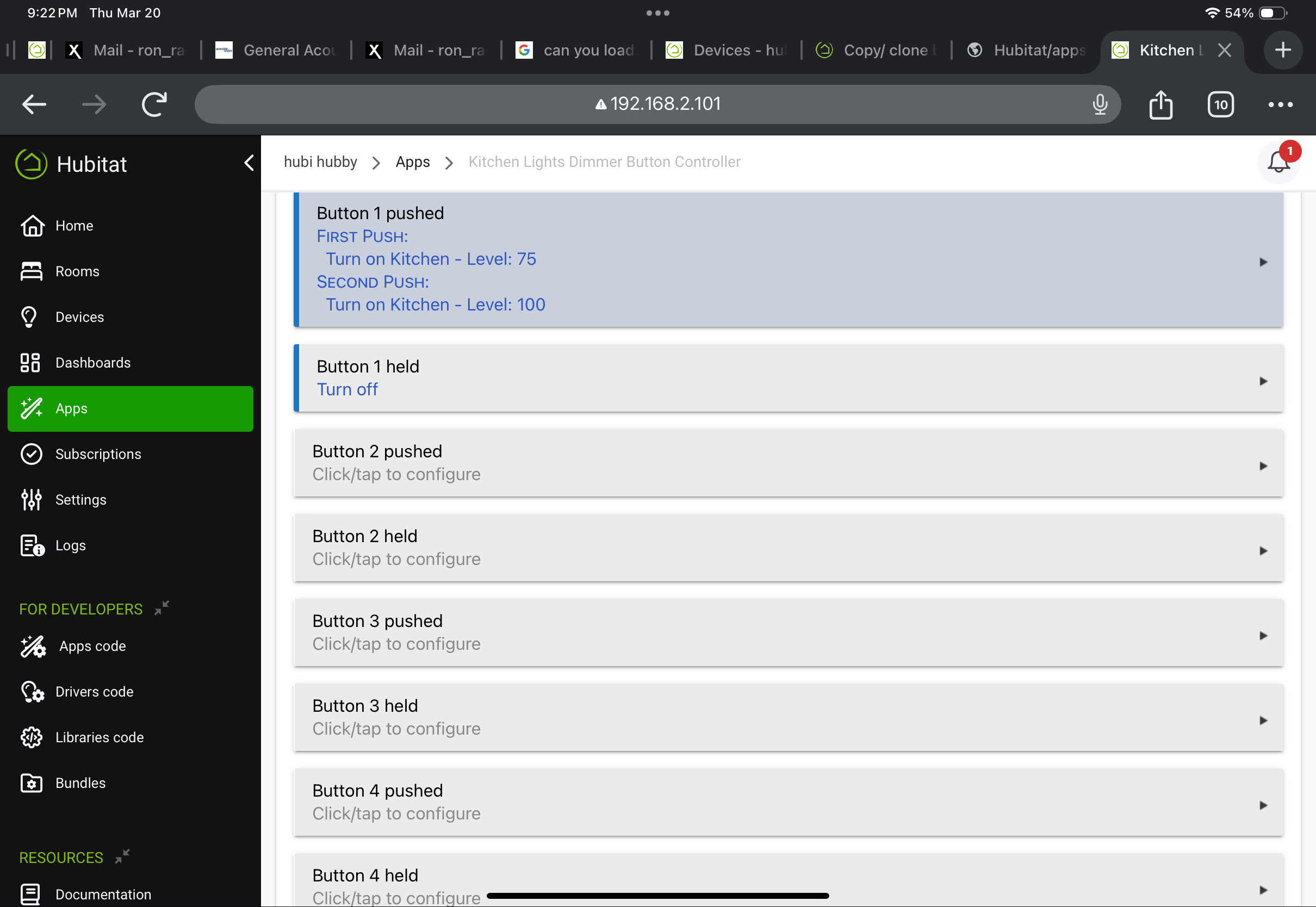

I installed CocoHue and then your app. Thank you again for putting the time into this. Definitely what I was looking for although I may play around to make some slight changes. Below is the config I ended up using and this should work for all gen 3 Inovelli switches. For the next one I install I will see if I can create a preset in the main app. I will also play around a little bit with the newer integration and see what works or that I can fix.
Overall it is working quite well, but no it does not pick up the scenes generated from the newer Hub Integration. It did pick up the light groups from that integration though for the action side of things.
As a bonus, by setting your “second push” option on button 1 instead of using button 2 for the Inovelli switch (which is how they map the internally debounced double click) I was able to set the button delay time in the switch itself to 0 which makes the response time of the switch a lot better.
The only issue I’m seeing now is the dim behavior is a bit erratic. For whatever reason dim down seems to be working as expected but dim up seems to have intermittent lag as I hold the button. Double push on button 1 also seems to have issues if I do the second press too close to the first.
As mentioned the button mappings are a little odd with the Inovelli switch. Button 1 held is actually the down toggle pushed on the rocker switch. Button 6 pushed is actually the up toggle held. Button 6 held is the down side of the toggle held and they have some counter intuitive button released mappings as well.
