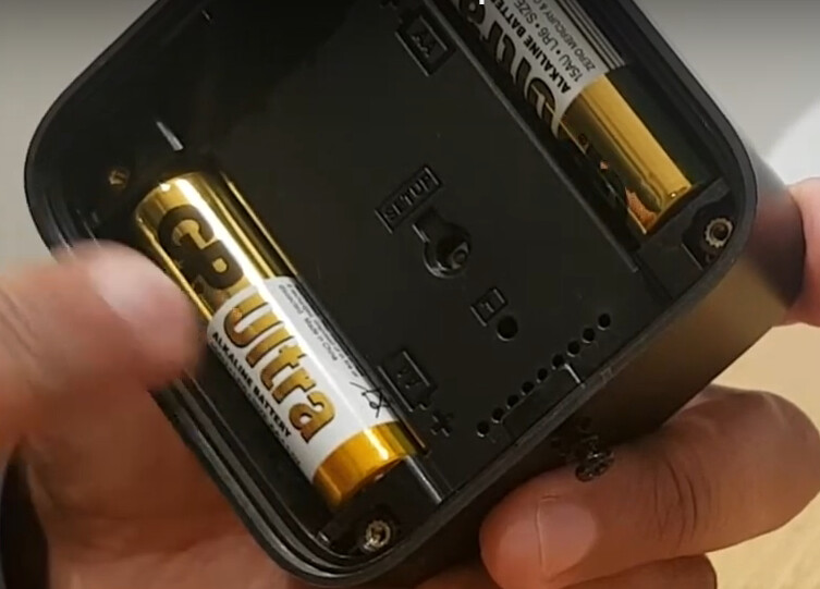

My Hue Outdoor motion sensors also have a button that can only be accessed by opening the battery compartment and using something thin (like a straightened paperclip) to press it. It's below the button that can be pressed from the outside (back) of the case. I wasn't sure what it did (I'm still not).
It's the factory reset button... at least according to the docs.
Actually I dont think that's the factory reset. I think that's the pairing button.
I looked for other buttons inside after you take off the back but don't remember seeing any. Where is the reset button if it isn't the one under the stick connected to the "exterior" button?
So to clarify this is the Hue outdoor sensor... after you undo the four screws and pull the back off (the watertight gasket makes it interesting) you'll see the pairing button that the little stick thingie you press pokes into... and above that there's a recess that contains the reset button. I think. The Hue docs are HORRIBLE.
I think I found this...looks like a pinhole button possibliy - below the button under the stick:
