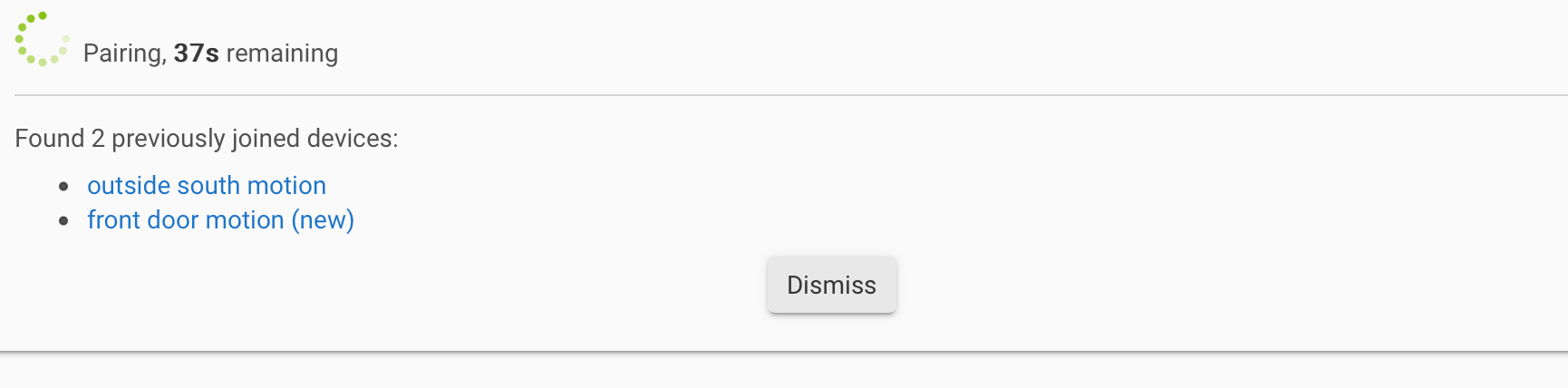

Well... I reverted to .115 (only one that was available to me), tried to re-pair the ikea blind, and here's what I got. Never was able to make the blind work. Tomorrow I will be migrating my blinds and any other devices that fall off back to a C7. Not ideal but my patience and faith are about done.

So... after taking two hubs to .117 and setting them side by side (but on different zigbee channels) one can include devices like it's going out of style. The other - my original migration hub - cannot. It is on channel 20, which is the channel I started on 3 years ago.
I'm now going to migrate the original hub - the one having issues - to another C8 and see what happens.

After much trial and tribulation and a few hub migrations I have my original C8 configuration on a new hub on channel 20 and next to it another C8 on channel 25. The original configuration on the new hub cannot include zigbee devices - they either get stuck on initializing if they are a new device or they re-pair an existing device but that device is not functional. On the new C8 on channel 25 I can pair new devices and re-pair old devices and both work fine. Both hubs are on .117. My original pre-migration C7 was on channel 20.
