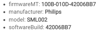

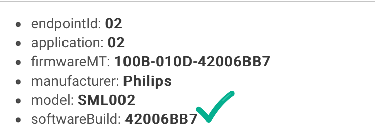

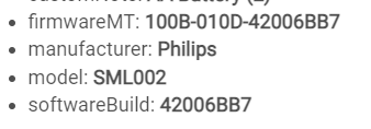

What FW did it update to?
Mine are both on the same FW, below:
