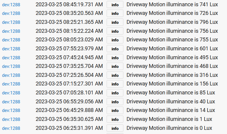

On a more happy note, the outdoor "driveway motion" Hue has almost completed two days of connectivity. Still no children. Table below.
Also, it strikes me that the Hue's luminescence reading are fine and linear. Much nicer than the Zooz motions I have which are basically day or night.

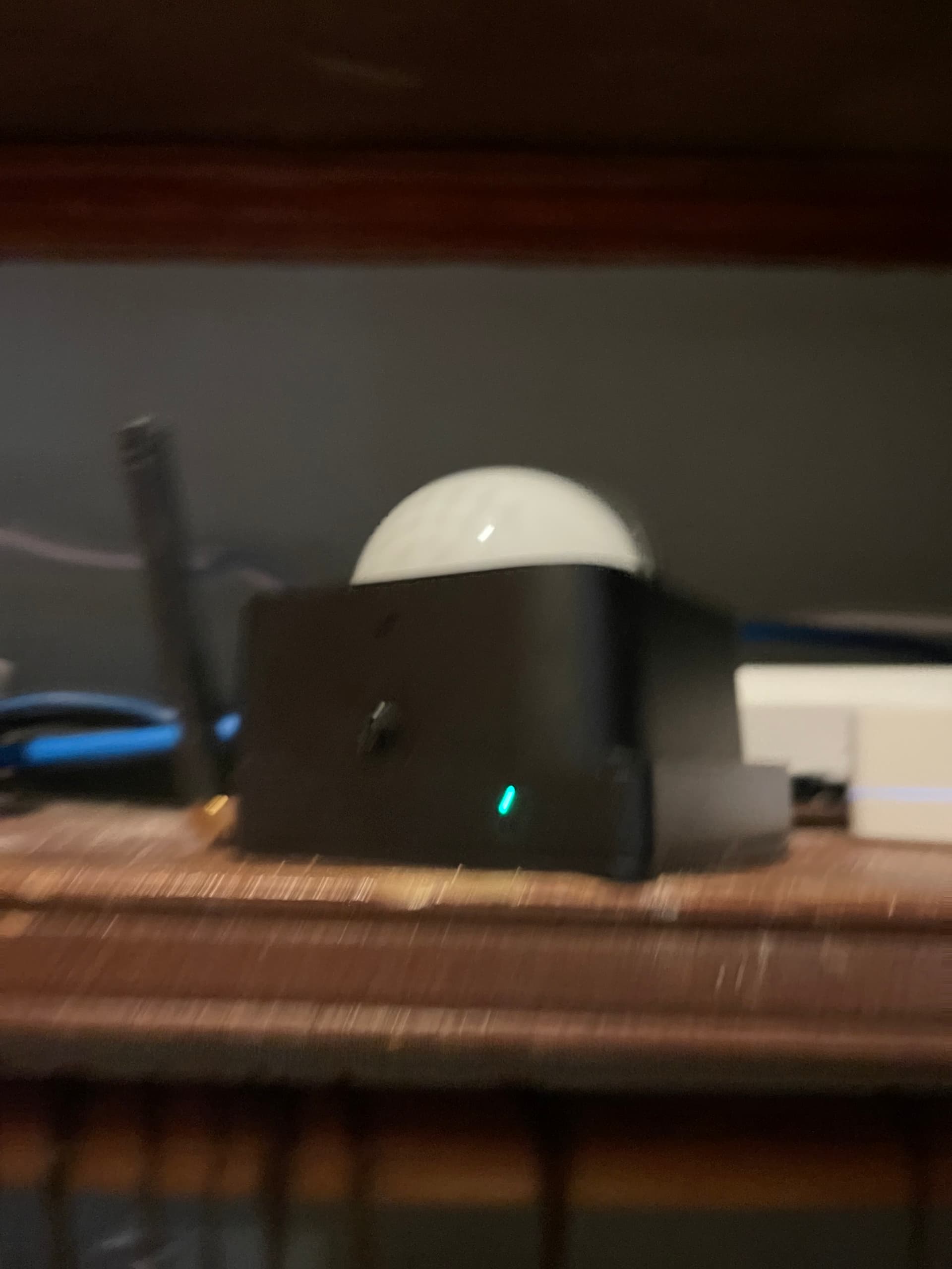

I was able to successfully update the firmware on the one remaining Hue outdoor motion sensor that remains connected to the C8... the first few efforts failed with a note in the log to try to bring the sensor closer to the hub, so... (sorry for the blurry photo but you get the idea)
