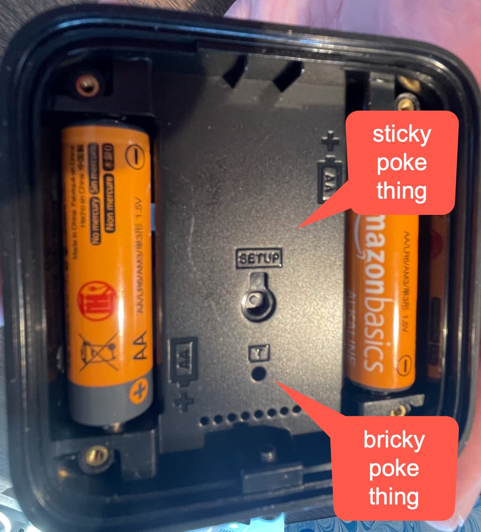

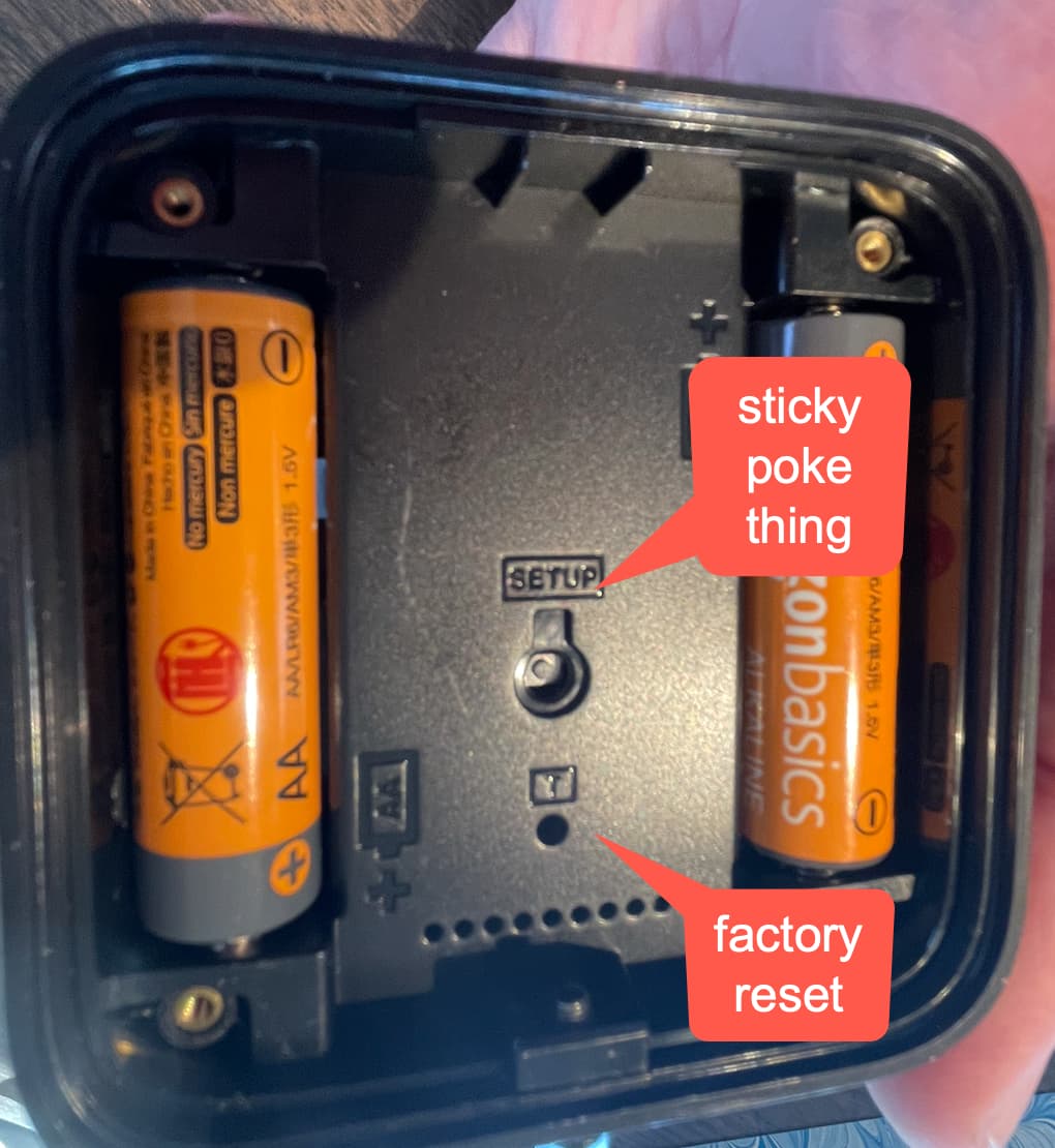

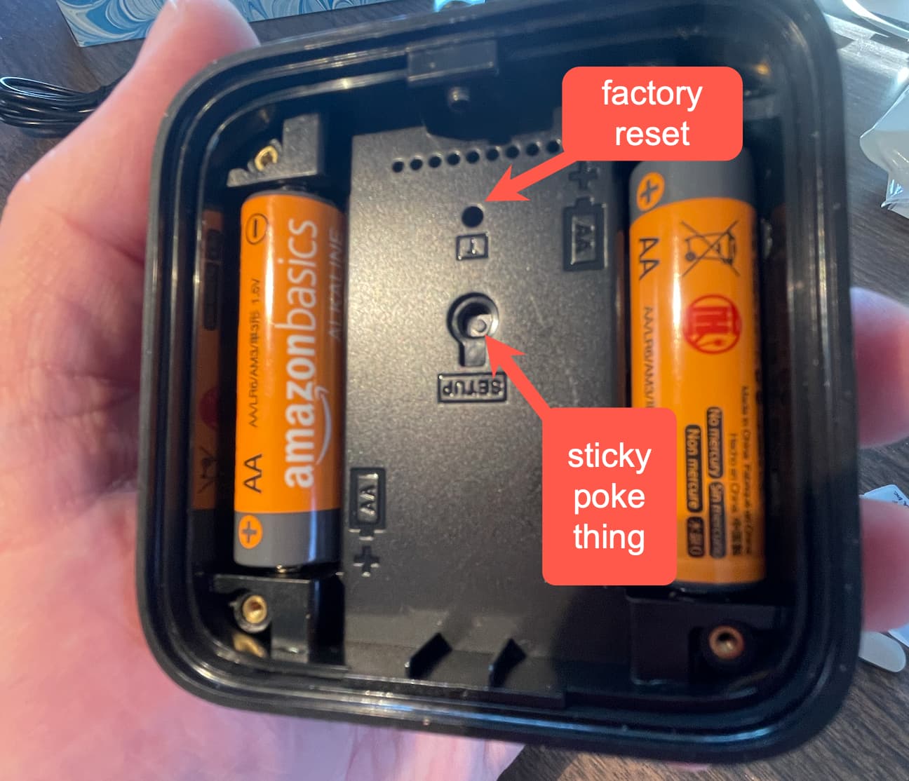

allegedly a 1 second press does a reset
LOL...saw your pic after I posted mine. Twins... :slight_smile:
New favorite device feature name: sticky poke thing
:wink:
Except mine is upside-down!
Huh, I never noticed that other button... My earlier search efforts on Google just said to hold down the main button for 10 seconds to reset. That ends in a (seemingly) encouraging blinky sequence.
I'll have to try the secret button option too - why not.
OK, learned something new today, hadn't realized they have a reset as well as the re-pair button. If one of my Hue outdoor sensors falls off again I'm going to do a full reset and then re-pair. Go nuclear on it.

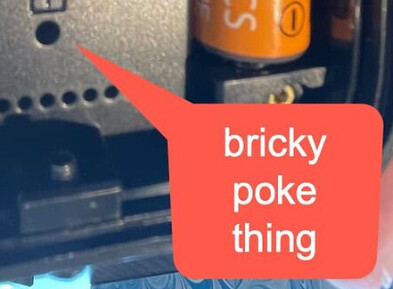

I bricked a sensor messing with that other button, to reset hold the setup button until it blinks green, about 10 seconds. After that single press to have it start join mode.
Made no difference to me. I only did the factory reset when the sticky poke thing didn't work.
