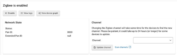

Woke up this morning to an issue with my C7 hub running 2.4.3.137, which mainly hosts my AlertMe kit. There are 34 devices on the mesh and it runs perfectly. Mostly.

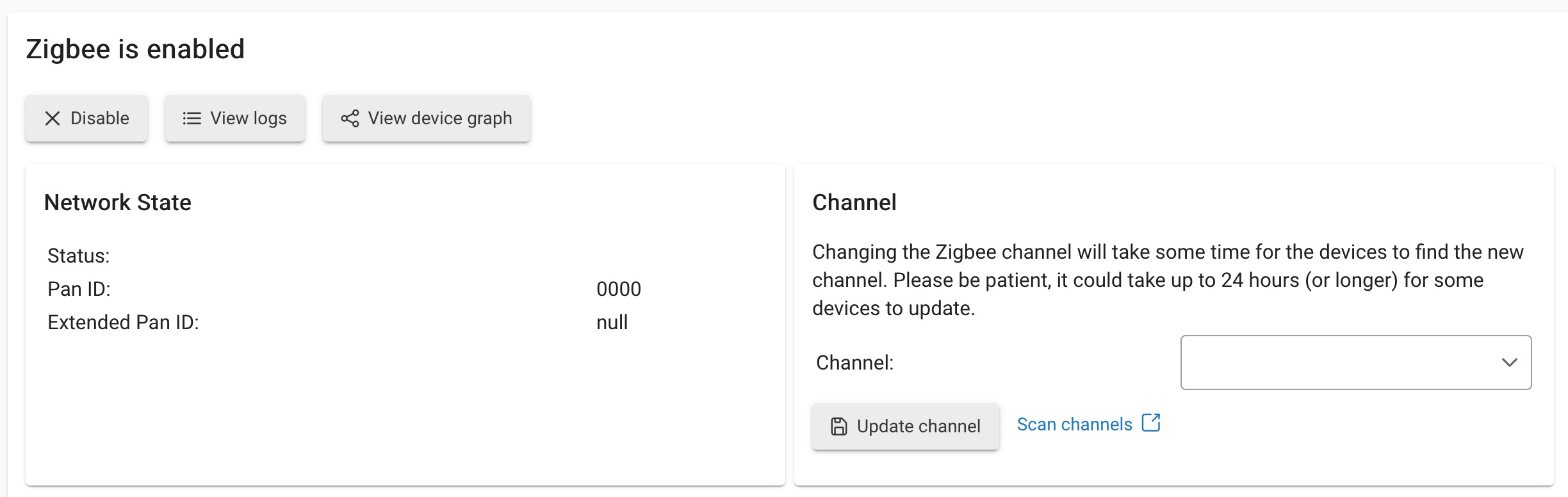

My issue looks identical to this one from @txyaloo a year ago. None of the devices were responding this morning, though the hub interface was just fine. Checking Settings > Zigbee Details showed this:
Network State
Status:
Pan ID: 0000
Extended Pan ID: null
Rebooting the hub didn't change anything. Full power cycle, also no change.
What did repair it was to restore the local backup from yesterday through Settings > Backup and Restore > Local backups. Thankfully the Zigbee radio settings came back and everything is beginning to respond normally again.
