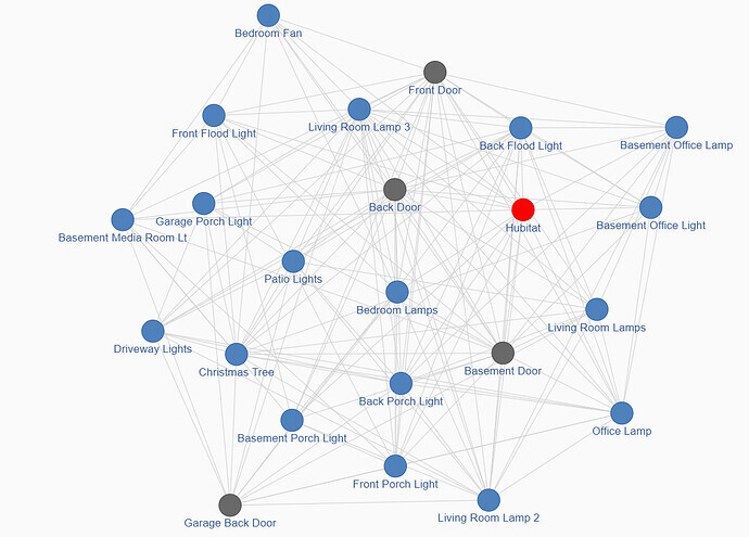

Attaching diagram of mesh. If I attempt to repair in this state, everyn ode fails, but when working almost everything is direct to hub with good signal/speed. It's a small house.
Post a screenshot of the z-wave topology map please (red/blue squares).
