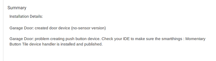

This is the Error I get when turning that option on after installing the application

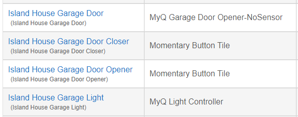

I have the following created:
(light does not seem to work)
If I add the Opener and closer, how would I go about adding them as buttons? Switch didnt seem to work

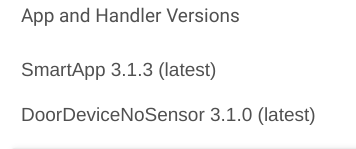

I know there use to be several versions of this app a while back - are you sure you have the right one? I use the one that is now in HPM.
You can set them up as buttons in the dashboard. It is one of the options.
I did installed it through the Hubitat Package Manager application.
MyQ Lite (v3.1.3)
That’s the same version I have. Not sure what is the “Momentary Button Tile device handler”... Have you searched for that?
There might be a driver that is required for it to work...
Update: Yup, you need to have the driver installed. Not sure why it didn’t install via HPM... Here’s the direct link to the groovy code:
https://raw.githubusercontent.com/dcmeglio/hubitat-myq/master/devicetypes/brbeaird/myq-garage-door-opener.src/myq-garage-door-opener.groovy
@chandramuralis @cuirbear

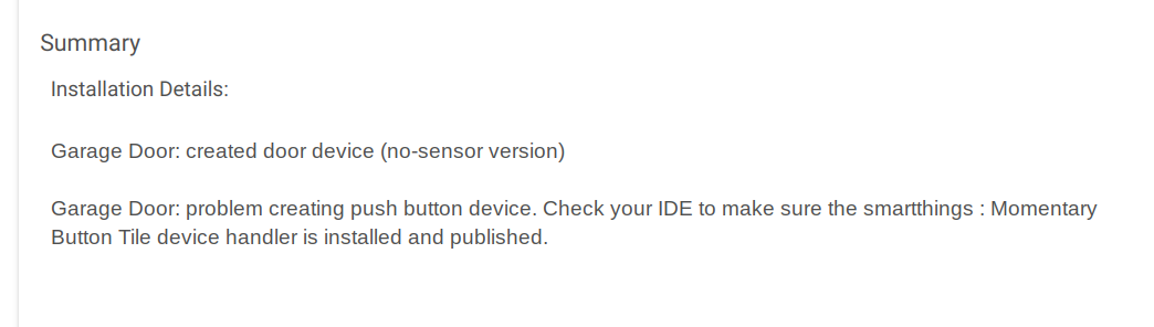

I finally figured out. Make sure to delete all your existing myQLite related apps, drivers and app code.
Then follow the installation instruction in the original GitHub page , DON'T Use Hubitat Package Manager to install this MyQLite Application, somehow it doesn't install everything properly.
