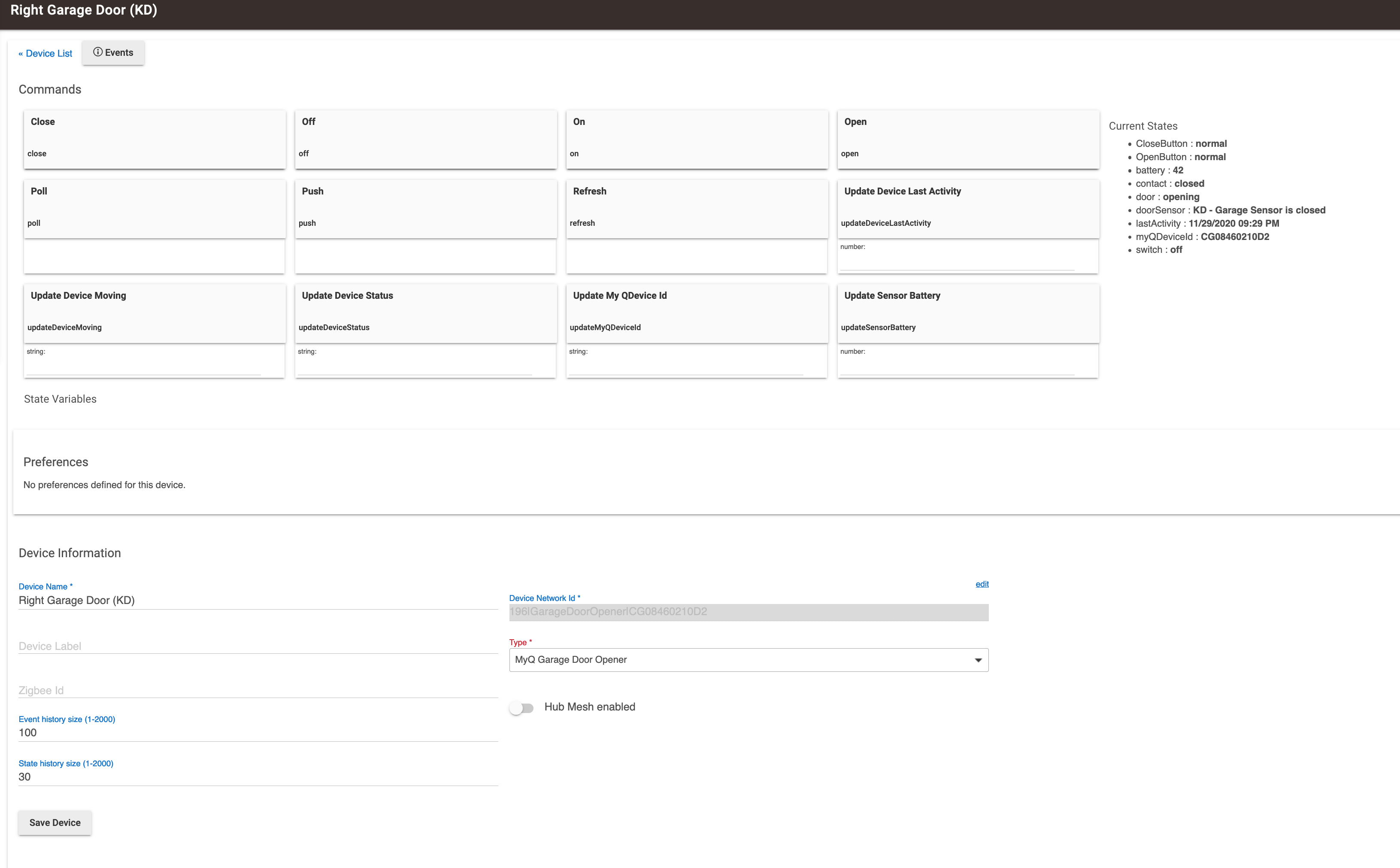

I'm suddenly getting a CLOSING STATUS on 1 of my sensors even though the door is closed. This has worked flawlessly up to this point but last night, this 'closing' status came up. Despite refreshes and even opening the door myself - no change. The MyQ sees the correct status (I still have the myQ sensors on the doors). I'm using the Samsung Multi-sensor bottom half as the door sensors. I have 2 doors, the other, is fine. Any ideas? Both doors are now showing incorrect "moving"status.

I have been experiencing issues for a few days now. It seems the 'state' of the door is stuck on Closing and Opening even though they are both closed and showing it.
I have a SmartThings (button) and the doors still open and close with that without issue. But not from the HE dashboard. At the moment they both say "Closing".

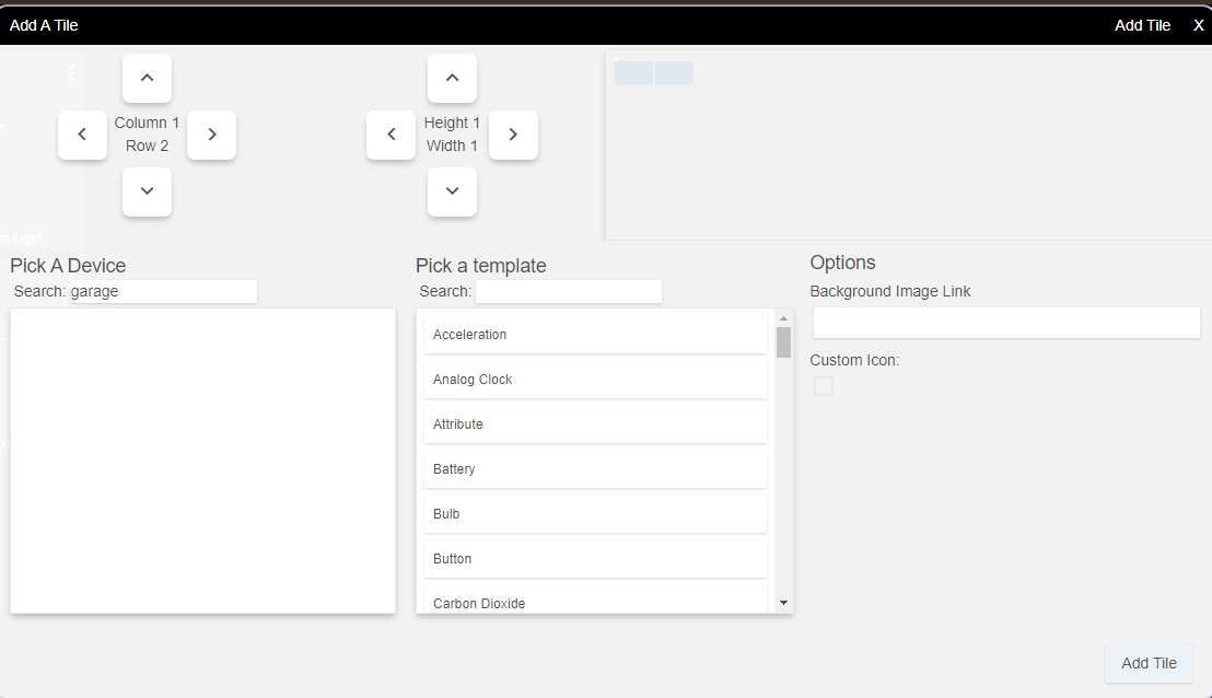

Hi, I'm new to Hubitat and I was using Wink before. I was successfully able to add myQ to Hubitat and was able to Open/Close by directly going to Device Command. But I couldn't find this a device when I'm trying to add it to dashboard. Do I have to do something for the Garage door to show up in the Dashboard list?

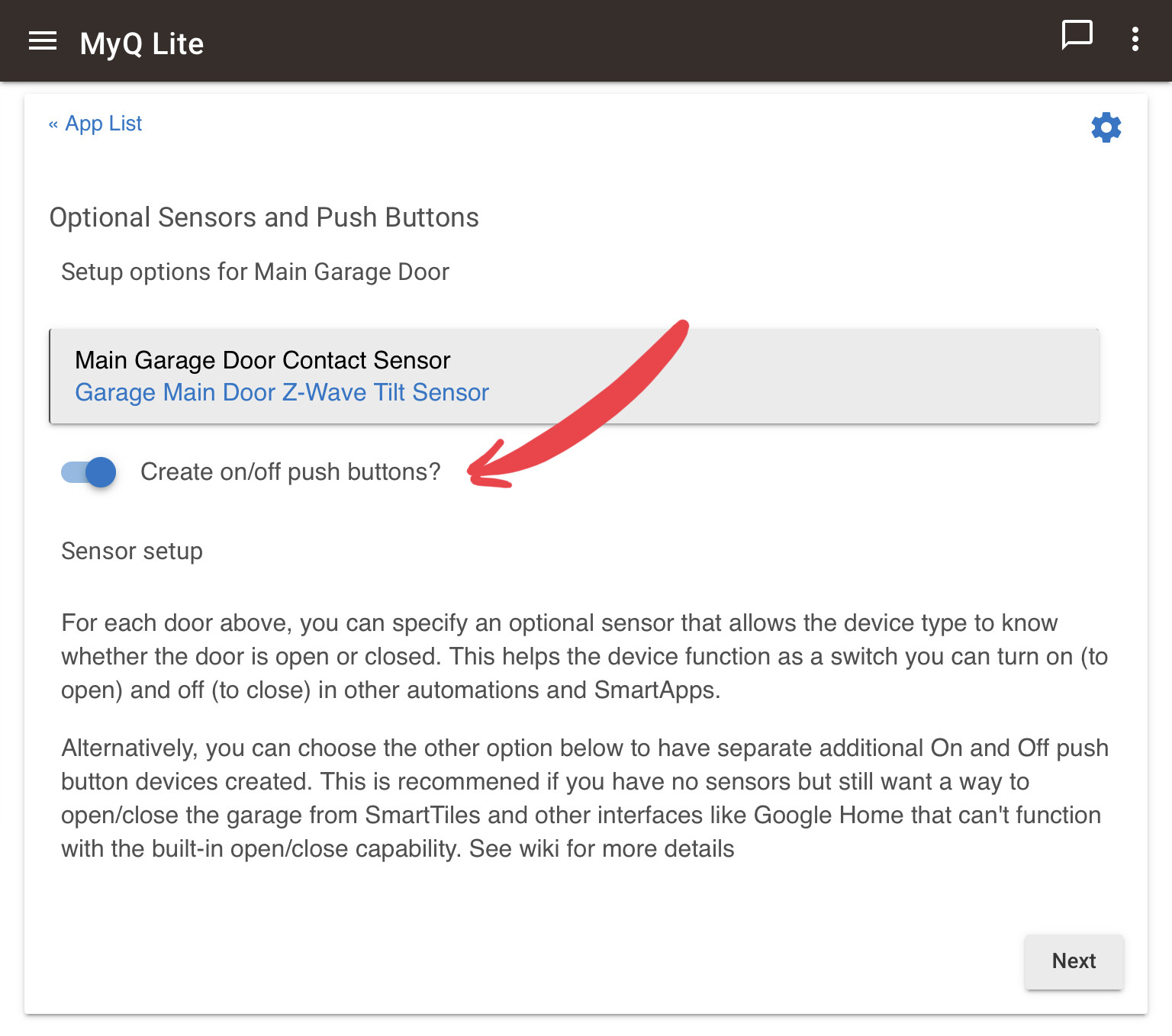

It creates a device named "Door", and it's best used with an additional tilt sensor or contact sensor because Chamberlain does not provide the door's status.
Do you have your the App setup with a garage door tilt sensor? (Not the one from MyQ.) It can’t tell if it is open or closed otherwise.
If you don’t have one, you can always use a virtual switch/sensor combo linked to IFTTT, where MyQ will turn it on when open and off when closed. That is what I setup at my father’s place and it works great.
I don't have any other Sensor app installed. But I'm able to control them fine by directly going to Devices --> Garage Door --> Commands ( Open, Close ).
I think the only way to control them via the garage door controller in the dashboard is to have a button.
Otherwise, if you opted to have a button device created when you setup MyQ, you can add it to your dashboard and control the door that way. It would do the same as the open/close in the device.
Opted to have a button created? Not sure where that configuration was.
I, too, am able to control the garage door from the device screen, but would like to know how to go about adding a dashboard button.
