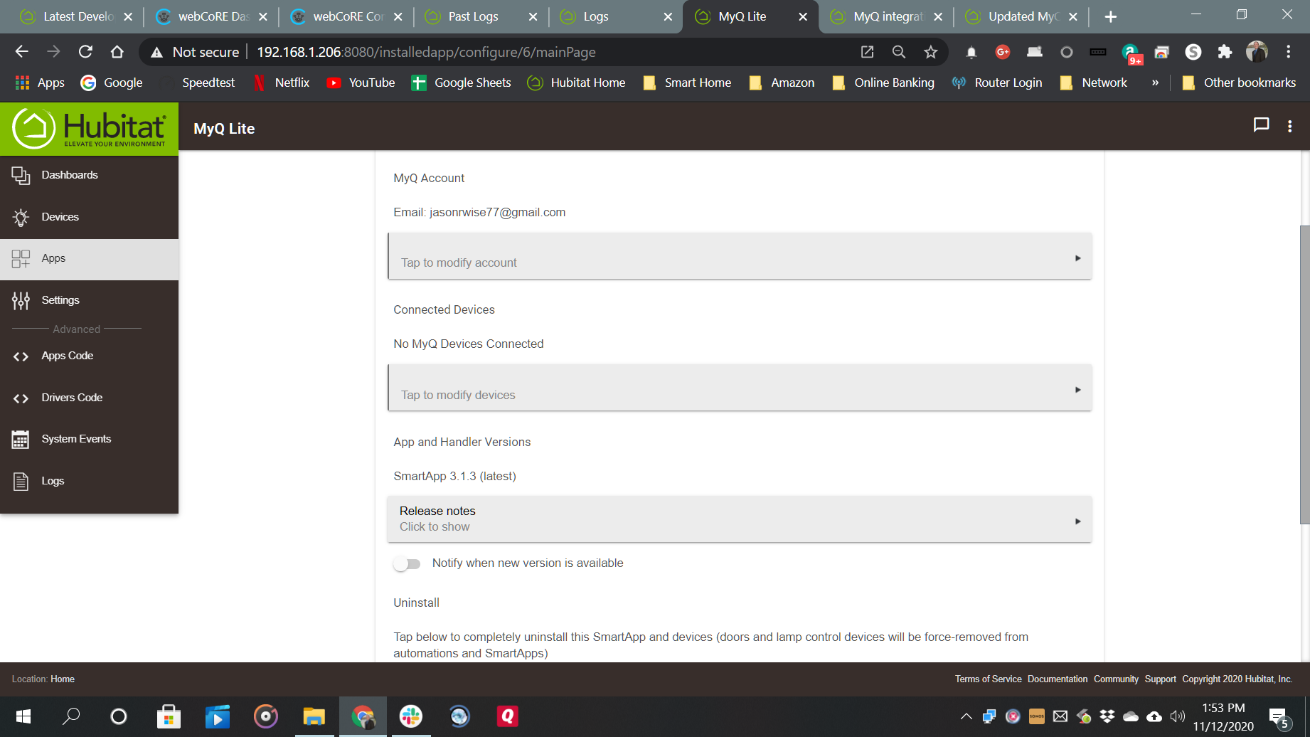

Hello, hoping somebody can assist me. I have been using the app for 2 months with no issues and now all the sudden I am getting log errors. It seems my token keeps expiring is is causing cloud issues on my hub when this happens. I also noticed that the apps says I do not have any connected devices, but the door works fine.
Any ideas?
Did you try "Tap to modify account" and log in again? What happens if you do that?
Same with "Tap to modify options". Does that do anything?
Like I said everything works with the door, but I get this token issue. I can re-login fine and it says forced login, in the logs. I figured out that because I have it set as a lock and not a door it does not show connected. But when I change to do it shows connected. And the token issue still happens as well, so that does not seem to be the issue.
