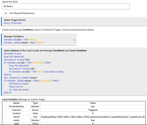

Assuming you're running BI as service you could set the PC to automatically restart after an electrical power supply interruption and then auto log into Windows. Then you could plug the PC into a smart plug and use Hubitat to monitor the ping results of the IP address using Rule Machine. If the ping fails, RM power cycles the smart plug which reboots the PC and restarts Windows and BI.
Here's a RM example of how I'm doing this:
