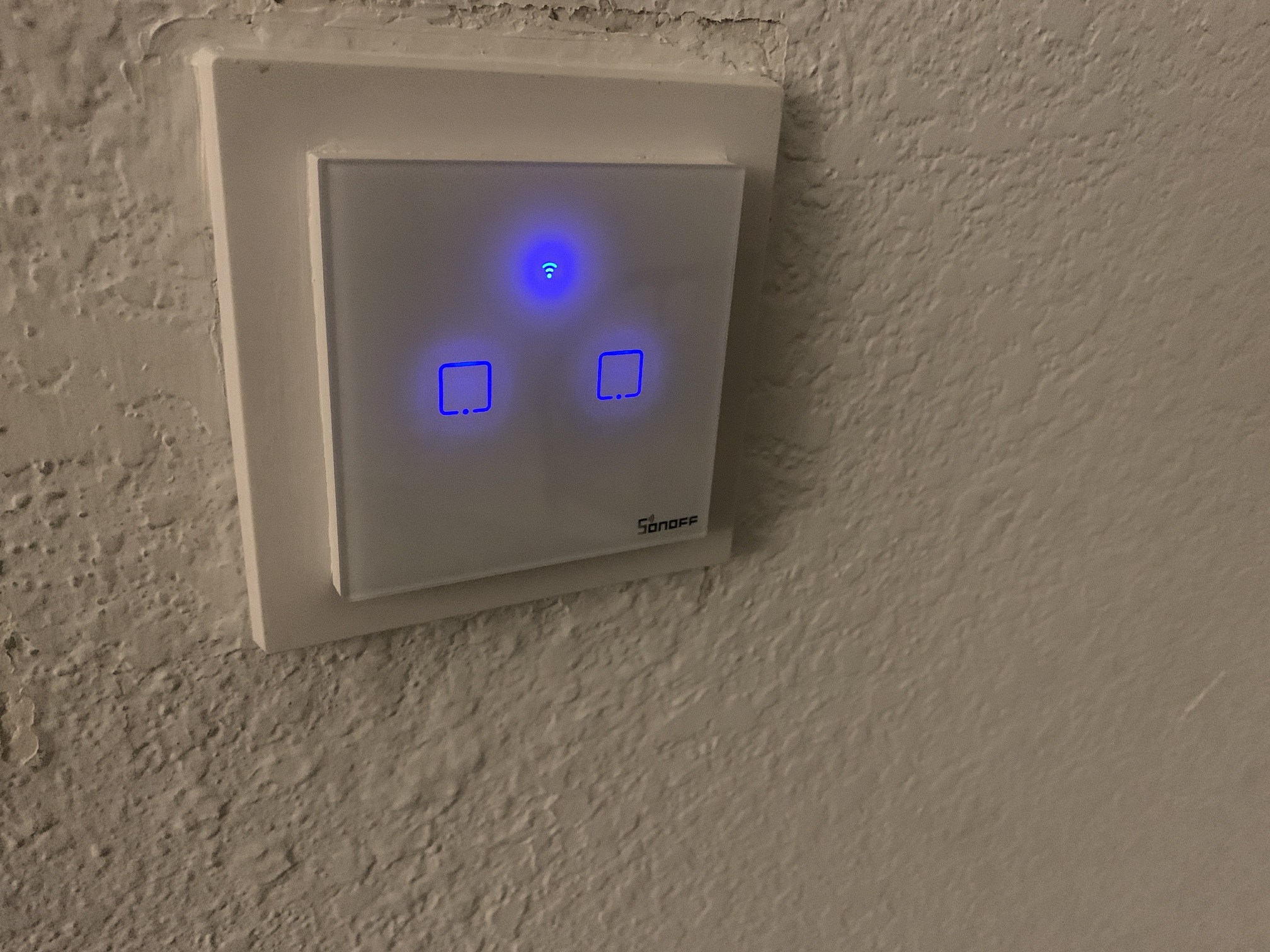

Hi there I used to have 14 winks all working with Hubitat ... step by step they started to show the groundhog mode and after few weeks they simply die.... for me it was a matter of time for them to die. I did not find any way to recover them nd I decided to replace them when they die for SonOff devices and in some cases tablets too. Here an example of one of the wink relays replaced by SonOff devices previously tasmotized to get them out of the SonOff cloud ... this is the European version perfectly working in the US....
Nice-looking buttons. I wouldn't quite call this a direct replacement for a Dashboard screen with 2 relay buttons, but nevertheless, it is one option and nice execution. I am yet to dive into Sonoff/Tasmoto world. I have a bunch of dual relays as well as this 2-button z-wave switch (I used it with ST, not HE yet). Might give it a try if I can't re-root the Wink Relays.
You are right I meant that I replaced them with the sonoff ... in addition I replaced several light switches like this one
All perfectly working since day one after the tasmotize process... the beauty of this device is that despite you might have only one light to manage , the 2 gans version give you the ability to program anything you want to the 2nd button
